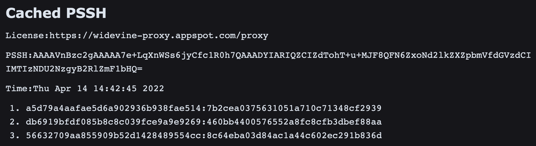

    From that I got an mp4 and an mpa. I also downloaded the mpd, opened it in TextEdit to find the PSSH and got a set of keys using http://getwvkeys.cc/

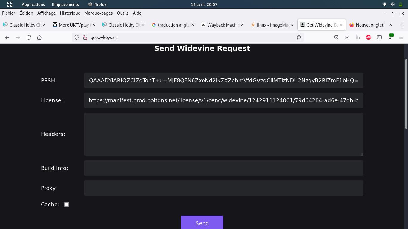

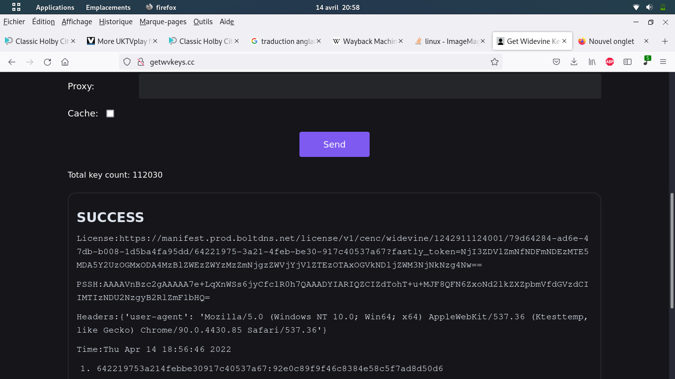

  6. I got the key with WKS-KEYS and my own L3 cdm
    But it works also with Notaghost's website.
    No need headers
    [Attachment 64291 - Click to enlarge]
    [Attachment 64293 - Click to enlarge]
    Uncheck "cache"

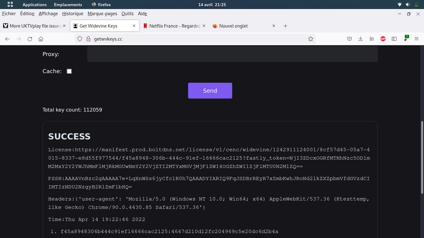

  7. Ahhh ok, thanks! I didn't realize you need to include the link
  8. Okay, last question (I hope)! I'm going through the same process on the next episode, but when I enter the info on Notaghost's site I get an error. Is that common from episode to episode? And are there any workarounds?
    The episode in question:
    https://uktvplay.uktv.co.uk/shows/holby-city/watch-online/6299468928001
  9. Image
    [Attachment 64294 - Click to enlarge]
    Don't forget to uncheck "cache"
    Same license but a new "token"
    you have to get a new address for each video
