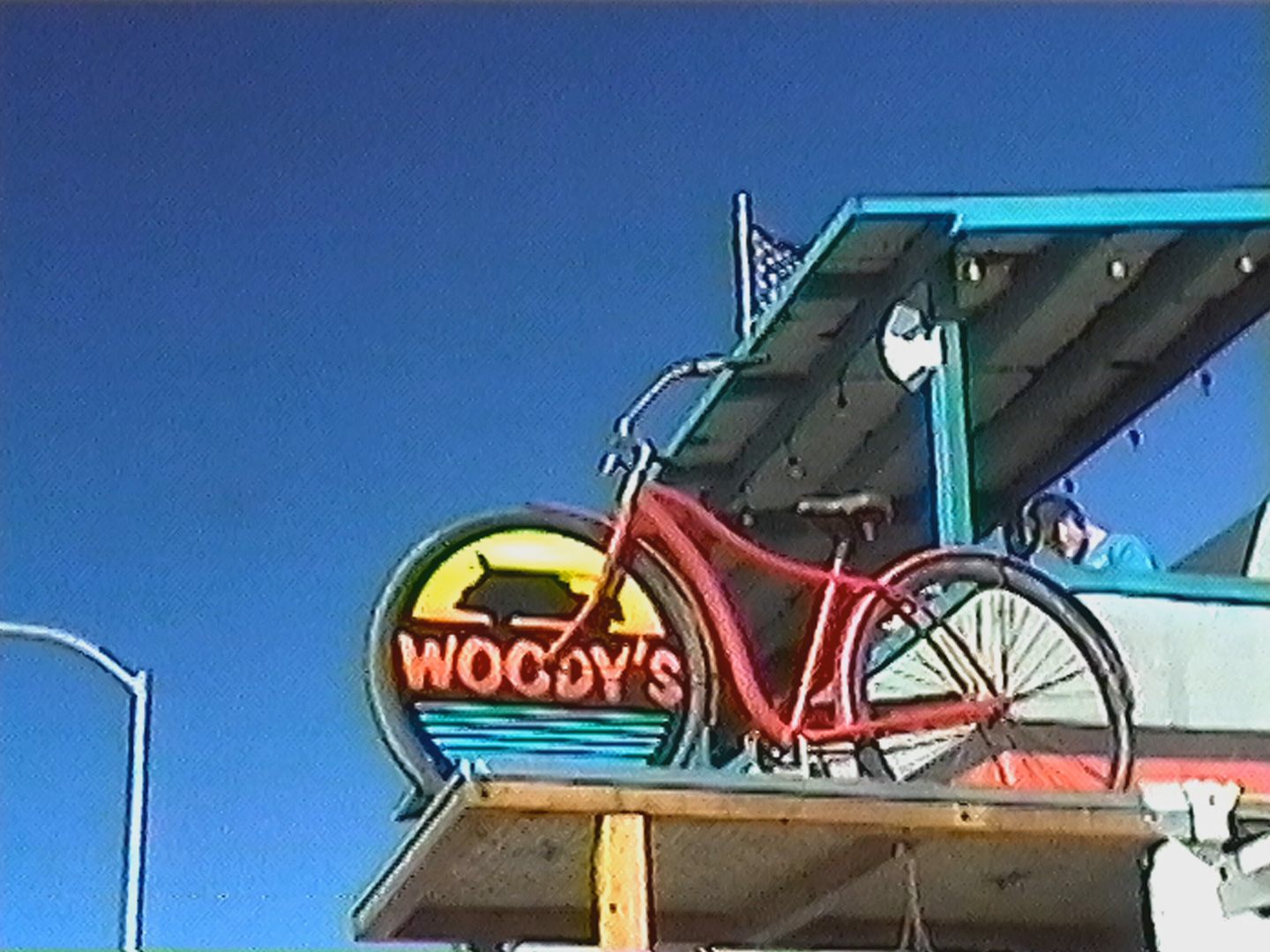

  8. Thank you Brad, I stand corrected. This will teach me not to talk out of my ass (no, it won't, sadly). I thought I've read somewhere that Yadif did not have temporal component, but looks like it does. Good for Yadif. It may not be the best, but considering it is faster than realtime on an average machine, it is very efficient and is very useful for previewing (I use Yadif filter in VirtualDub2).
    lollo, thanks for the link! I have tons of info about deinterlacers already, but the more the merrier.
    dellsam34, QTGMC is the golden standard. I think I am where you were three years ago, trying to stay within VirtualDub2 and avoid scripting. Maybe I will eventually cave in The last time I tried installing QTGMC Vapoursynth script, I spent two hours downloading libraries, resolving references and updating scripts, but it still would not work. Maybe I'll try again sometime.
    For VirtualDub I've been using MSU Deinterlacer, it is slightly better than Yadif, but order of magnitude slower, it is not realtime on my machine. Since I don't do it professionally and don't have a constant stream of work, I don't mind extra processing time. I do a quick check with Yadif, then switch to MSU for the final render.
    Attached a comparison between Yadif and MSU Deinterlacer. Please, don't comment on the horrible graininess
