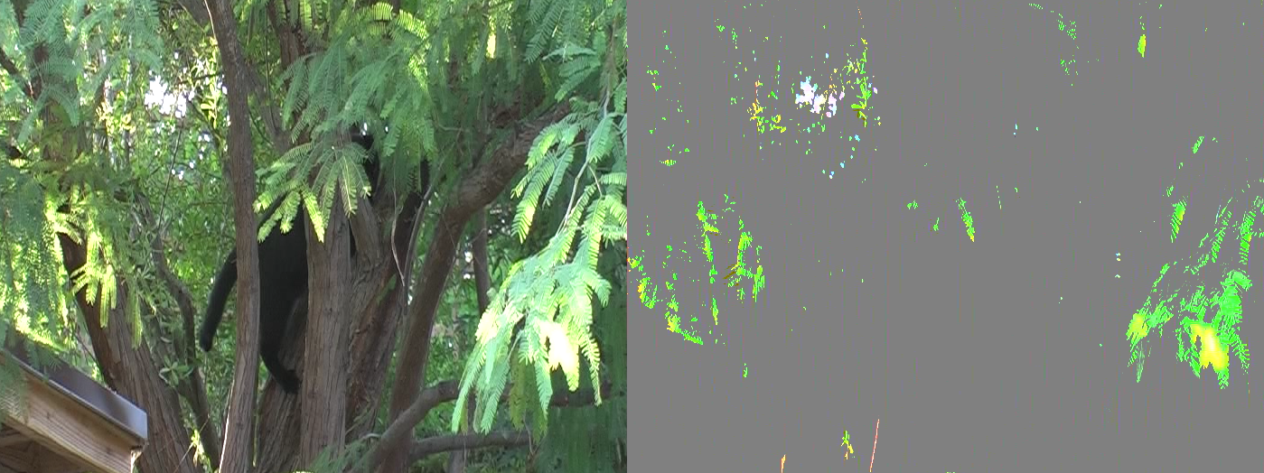

  2. Few notes about the cat video of post #25.
    The colors look washed out to me.
    Check the levels: Black is too high (greyish), white Y=255 clipped => RGB are out-of-gamut, loosing details.
    See for example frames around #280: The leaves of the tree on the bottom right corner are overexposed, masking the details.
    A little tweaking (e.g. reduce contrast + saturation, shift black level down) will help IMO.

  4. Originally Posted by dellsam34 View Post
    It's digital DV not analog, Changing levels requires re-encoding, DV streaming software don't have the ability to alter a live stream on the fly.
    Unfortunately yes, it would require re-encoding. But re-encoding will happen anyway if post-processing in an NLE is planned.
    The camera could have done better, I think. The cat sould not look gray, and the bright parts should not be heavily clipped.
    I know it happens though.
    The colored areas on the picture on the right shows out-of-gamut pixels. This means usually loss of details.

    Jan 2016
    Yes but the subject here is about whether a USB port can emulate firewire and stream DV without any problems, it's not about the shooting skills, Or maybe I just don't understand your point.
  6. Take it as a sidenote. The picture looked so milky washed out to my eyes - despite or in addition to the 'trusted reviews' of post #27 - that I couldn't resist, apparently. Sorry for going off-topic. Never mind.
    It's ok! I understand dellsam34 point, but we always like your expert point of view

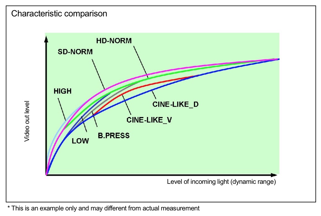

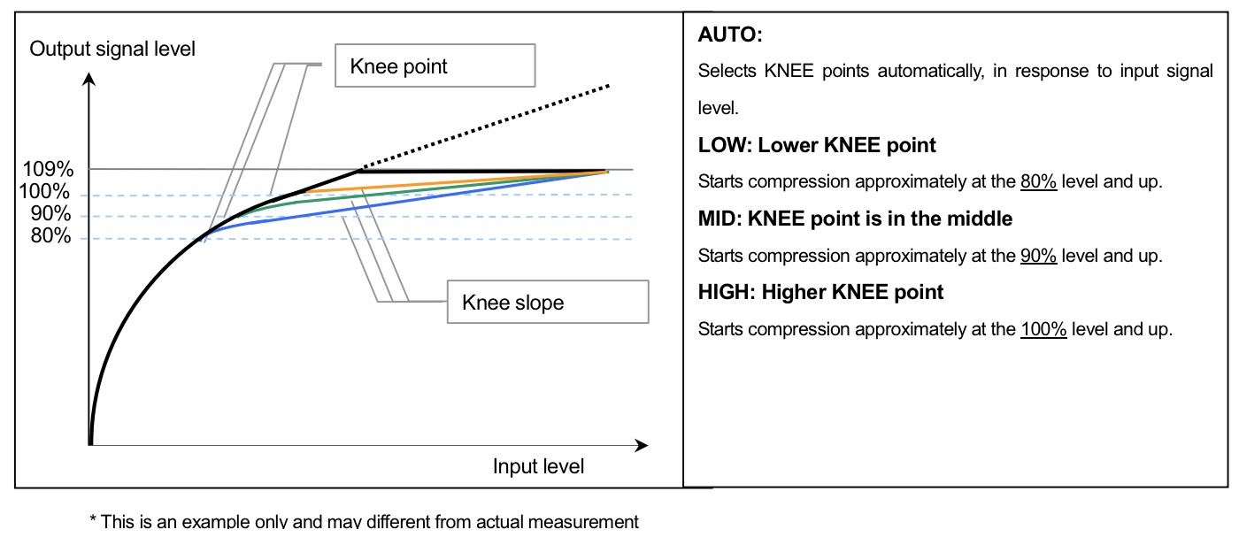

  8. @DB83, I am not in the position to defend the "ancient MS prog". As for my fragment, I shot it in 25p Digital Cinema mode because I din't care for interlaced. AFAIK, SD DV does not support native progressive stream, so it employs pulldown.
    @Sharc, Digital Cinema mode on the GS500 uses a different gamma profile. Attached is the Panasonic's picture that I pulled from Panasonic's Brazilian website for my GS500 review on YouTube, but I cannot find this info there anymore, I guess they finally deleted it, or my search skills deteriorated in the last half a year. The GS500 has just two gamma profiles, and cine-gamma is automatically turned on when shooting in Digital Cinema mode. As you can see, it raises near-blacks. As for near-whites, you can see it goes straight without knee. Professional camcorders have more options. For example, the DVX100 has separate settings for overall gamma profile and for the knee (I was thinking of buying one a couple of years ago when they dropped below $200 on eBay but the consumer-grade GS500 has a better sensor than the professional DVX, so I did not bother; interesting that old camcorders went up in price recently - another comeback fad looms?). As long as the components are below 255, they are not lost. This mode is intended for editing, so the levels can be adjusted to taste, in particular gray-ish blacks are meant to bring up details from dark areas.

  10. Originally Posted by ConsumerDV View Post
    @Sharc, Digital Cinema mode on the GS500 uses a different gamma profile. ...... The GS500 has just two gamma profiles, and cine-gamma is automatically turned on when shooting in Digital Cinema mode. .....This mode is intended for editing, so the levels can be adjusted to taste ....
    I see. This explains it. I did not know about the existence of the Cinema mode with the special gamma profiles. Thank you for enlightening me.
