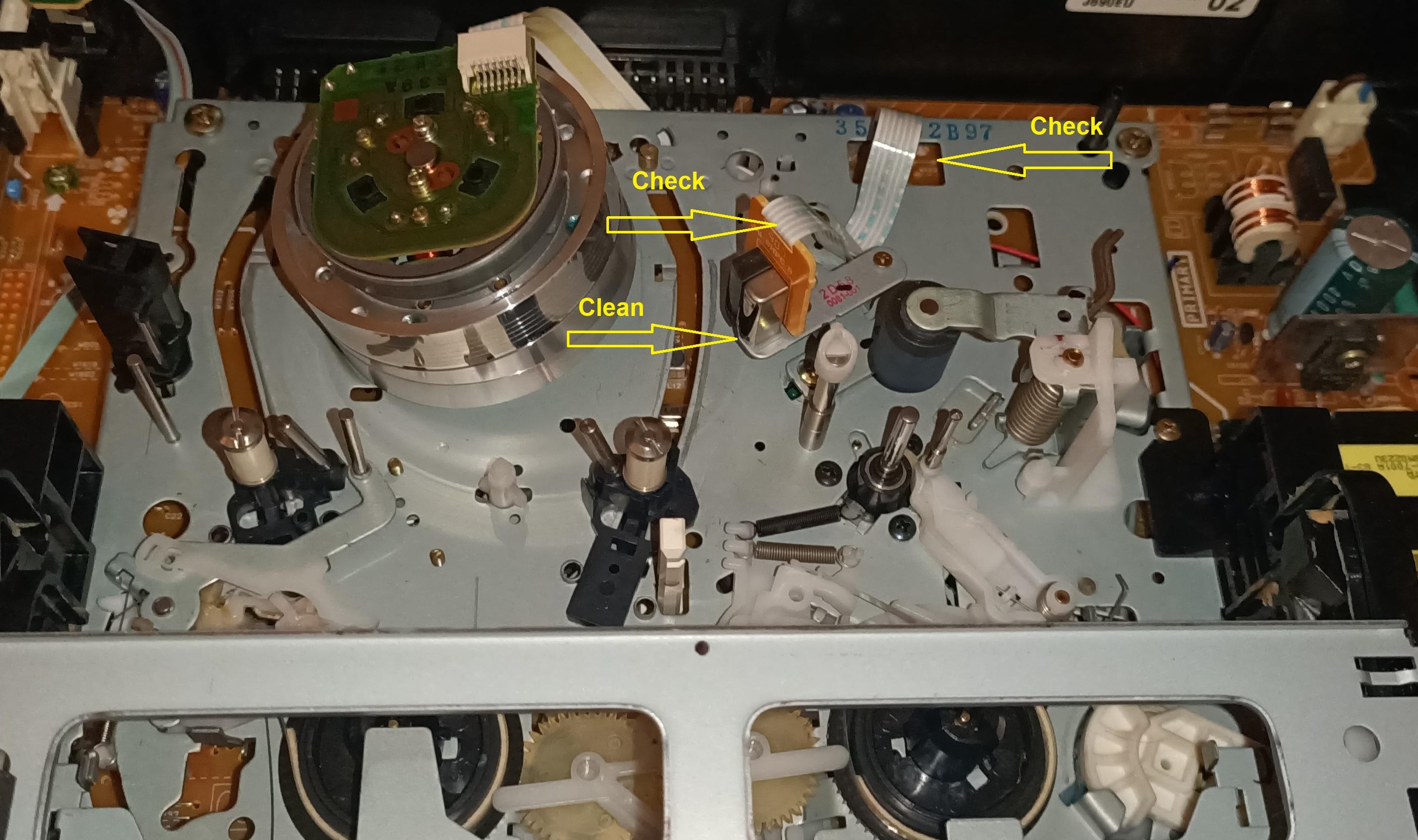

  3. Capturing Memories dellsam34's Avatar
    Jan 2016
    That's lack of sync pulse signal, Possible causes dirty sync pulse head (AC head), dirty, unseated or corroded AC head ribbon cable, failed component in the AC head preamp.

  6. Capturing Memories dellsam34's Avatar
    Jan 2016
    See the picture, Not the same VCR but similar layout:
    [Attachment 64403 - Click to enlarge]

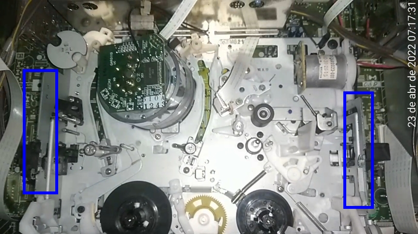

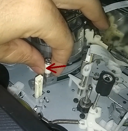

    Hello friends. I handled with the Dvhs roller guides.
    The first video shows how the video is running, without i ever having touched the roller guides.
    The photo shows the movement I made holding it with my fingers. Like, I rotated it an inch or two to the left (3 times I did).
    The second video shows how it turned out afterwards. I almost got it, almost normal.
    Then I made a few more small rotating movements with the left guide and other small movements with the
    right guide. It got worse! Then, I tried to go back to what I had achieved, but it didn't work, I gave up. And it
    is now as shown in the third video.
    It seems that the secret is in these guides, but I really don't know how to move. Anyone who can help me
    with any advice, let me know. And yes, I've seen the youtube videos posted here, but I'm not good at it.

  10. U shouldn't touch these because there are gears below so good luck now ! Someone else help him. But i guess if u take apart the whole metallic plateau from the mainboard (i know it can be done) then check the gears for no broken teeth and oiled good (u may have to clean old oil first), change belts aswell.
    edit: (assuming you didn't do much damage)
    check this other video: https://www.youtube.com/watch?v=iyUY7cFP9zw&ab_channel=12voltvids
  11. Capturing Memories dellsam34's Avatar
    Jan 2016
    I explained to you clearly what you need to do with a picture so language will not be a barrier but you decided to listen to the wrong advice screwing the P guides, your problem was and still is capstan tracking not head alignment, Now you lost the factory alignment for a dumb advice, You need an alignment tape and an oscilloscope to get back to factory setting, and then tackle the tracking problem at hand, DON'T EVER LISTEN TO ANYONE'S ADVICE BLINDLY WITHOUT DOUBLE AND TRIPLE CHECKING IF IT IS A GOOD ADVISE OR NOT. If you asked first before making this fatal mistake I could have warned you in advance, it's too late now.

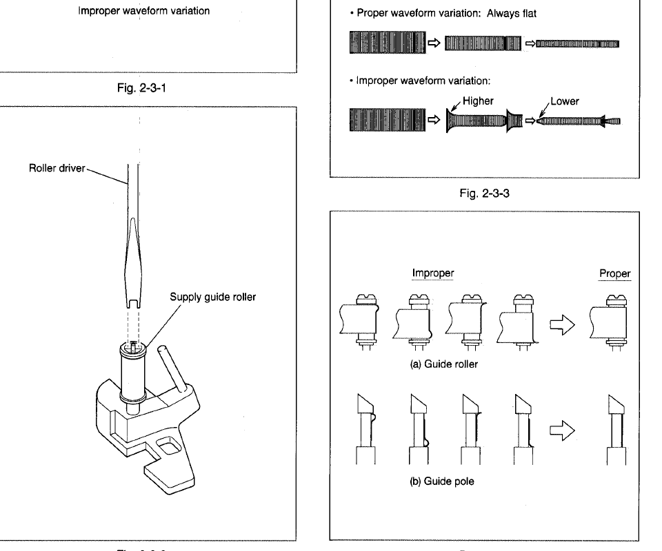

  19. If that can help, see below:

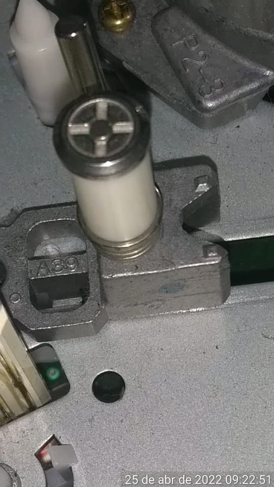

    So, VCR folks. Yesterday I played with this d-vhs again, that one which has the problem of tape oscillation.
    I remember the answers that each one gave me to try to solve, I ended up messing with the guides and it didn't solve, as I had made notes of the movements I made in these guides, I returned them to the ''original'' places. Even knowing that after messing it up it couldn't work.
    But look what I found!! In the photo I marked the places where I applied some downward pressure with my hands.
    [Attachment 65465 - Click to enlarge]
    What happened??? Something snapped, as if it snapped back into place.
    That was the problem!! The box that holds the tape was, somewhere underneath, out of place.
    When I did the pressure with my hands, it went down a few cms and snapped back in somewhere.
    What a bad luck! I was supposed to do just that! Now the oscillation has stopped, but as I've fiddled with the guides, it's not 100%.
    I don't know what happened to it, with the previous owner who was a European guy from Portugal.
    But why you guys, VCRs felas, didn't give me this tip before!!!?? Why!!!!????? Why!!!????

  21. Capturing Memories dellsam34's Avatar
    Jan 2016
    How am I suppose to know that with no information given? In post 13 I told to check one thing at a time and report back, If you followed my advice you would have never miss aligned the VCR.
    By the way the tape stabilizer is missing the metal disc, it's on the left side of the drum. See when you post a video we find problems.
  22. Banned
    Nov 2021

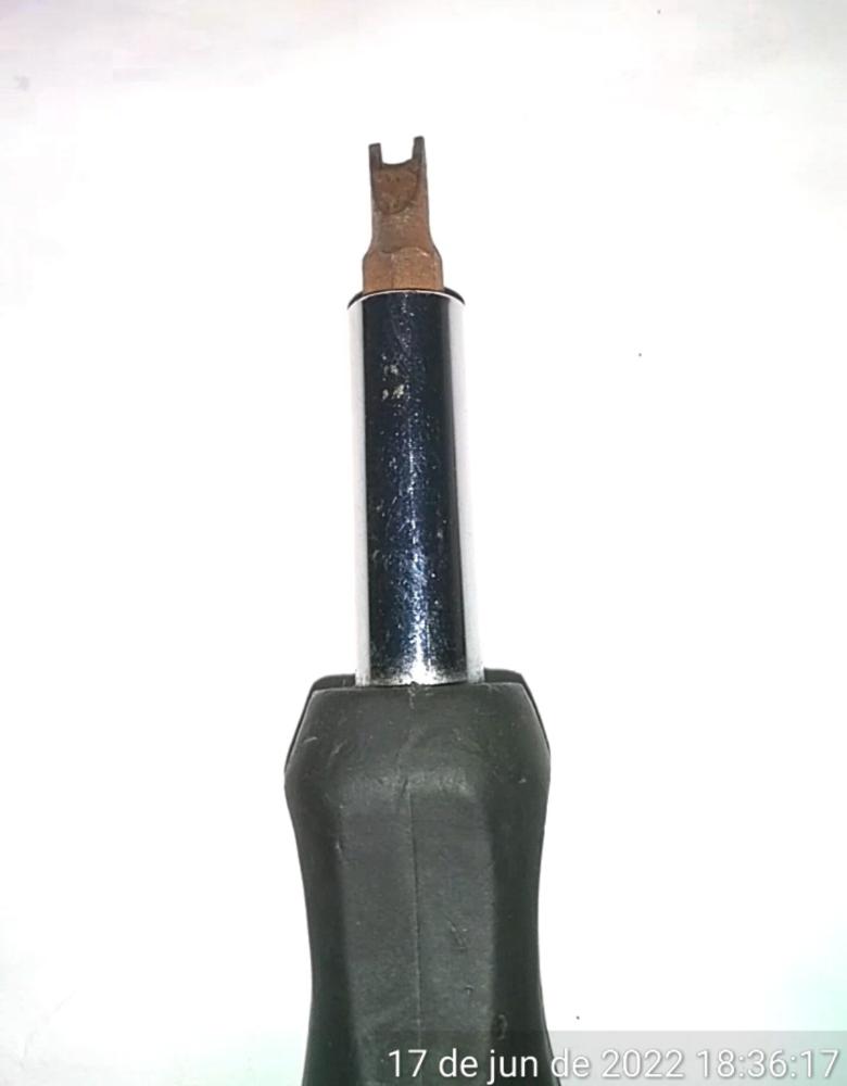

    The metal disk I took out, because I intended to fiddle with the guides again while running a tape with this tool
    [Attachment 65468 - Click to enlarge]
    but I didn't, after I saw that the mechanism clicked into place.
    And I don't think I'm going to mess with these guides anymore. I'll try to sell it like this and explain the details to anyone who wants to buy.

  23. it's like i said in another thread start with a vhs EP tape and work your way up: vhs ep> vhs normal > vhs hi-fi (check sound quality)> s-vhs hi-fi. Disable auto-tracking when you do that (copy mode). See post #19 for proper reel tape alignment with the guide (especially the entry guide imo)
    It did work for me it should work for you
    the bottom picture = exist guide ( guide on the right)
    upper picture = entry guide (guide on the left)
    last note: if i judge your last videos right, focus on the exit guide first (gut feeling), and very gentle adjustments (2-3mm perhaps from initial position)
