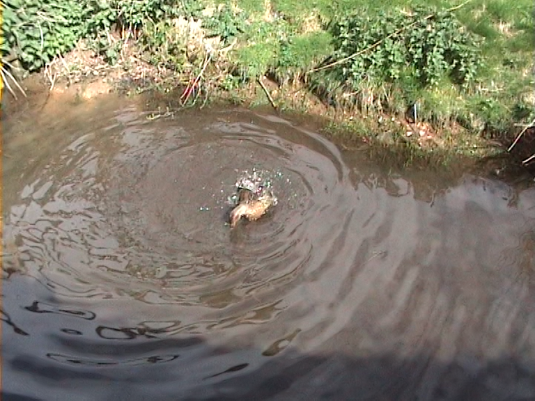

Hey, I have bought a FireWire PCI-e adapter and I have been transferring miniDV tapes via the firewire port (4-pin to 6-pin) on the SONY DCR-HC52E.
I have used both WinDV and ScenalyzerLive utilities to capture the tapes (AVI type2). Both are great tools but I've decided to stick with ScenalyzerLive.

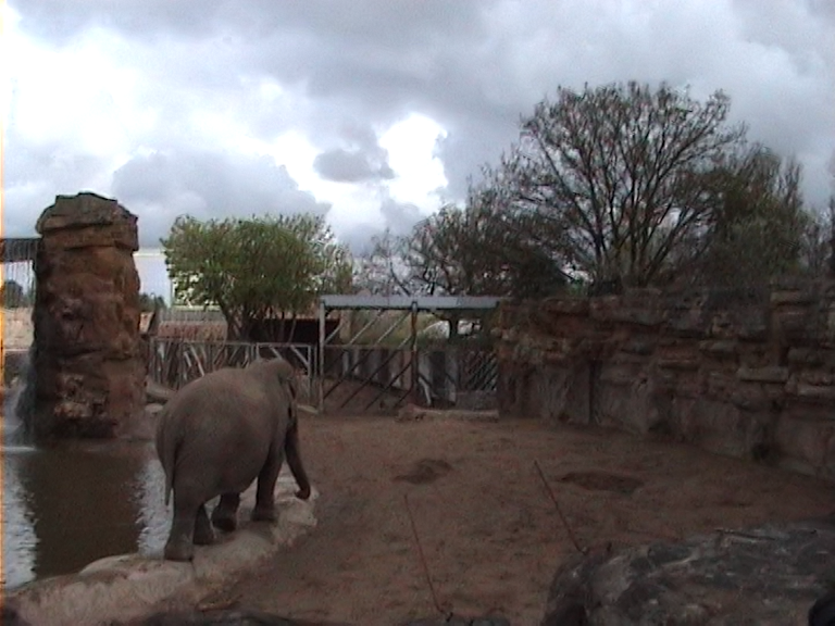

I have noticed an orange/yellowish vertical line present on the left side of the recorded videos and it appears all the time even when previewing the camcorder's live-feed camera. Is there any fix for that or it is considered to be normal?
[Attachment 64177 - Click to enlarge]
[Attachment 64178 - Click to enlarge]
Even when I tried to transfer Hi8 tapes using Sony CCD-TRV27E and passthrough A/D converter using my other SONY DCR-HC52E, the vertical line still appears.
Is this caused by the FireWire PCI-e adapter? or the FireWire cable? personally, I don't think it is related. I've been using the 4-pin to 6-pin, but I also have a 4-pin to 4-pin cable but haven't tried it, and I don't think it would make any difference, to be honest.

	There's nothing unusual about bad colors at the edges of the frame with analog camcorders. In those days you never saw the edges of the frame -- they were hidden by the TV's overscan. Crop them away or cover them with black in post.
	That's weird. I have never seen artefacts like that on my DV videos. You have two HC52E camcorders? Or you used the same one for native DV and for A/D conversion? My guess is no better than anyone else's, but I would think it is either the camcorder or something wrong with Firewire. Then again, DV frame is 720 pixels wide, and for 4:3 frame you need only 704 of them
	The FireWire cable and the PCI-e adapter used cannot cause this.
 It must be by design of the HC52E. Is it something to worry about? No. I had a MiniDV camcorder that would record two or so black lines at the top. As jagabo says it is well within overscan areas and is therefore not considered an issue.

 It's probably bad caps at the chroma processor making it shift the chroma to the right by few pixels. Jagabo posted a script before for analog camcorders where the chroma shift was from the right to the left.

	Here's one quick dirty method of removing the orange discoloration:
 The colors from near the edge replace the discolored pixels at the edge.Code:AviSource("scene'20090708 20.23.44.avi") patch = Crop(6,0,4,0).BilinearResize(6, height) patch = Overlay(last, patch) MergeChroma(last, patch) QTGMC()
