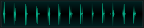

  1. Hi, I need to combine a single image and an audio file to get a video of the same duration as the audio. The reason is that the image is the waveform of the audio track and with this trick the playback bar of the videoplayer seems to follow the shape of the audio.
    I'm perfectly capable of doing this with Premiere Pro but for convenience I'd like to do it with FFmpeg.
    I tried but the video duration is always a few seconds longer than the audio. Always...
    I used this script, what am I doing wrong?
    ffmpeg -loop 1 -i 01.png -i 01.wav -c:v libx264 -pix_fmt yuv420p -tune stillimage -c:a aac -b:a 256k -shortest -y output.mp4
    01.wav is 7 s 249 ms long, the video obtained with this script is 9 s 200 ms long..
    I attach the files of my test
