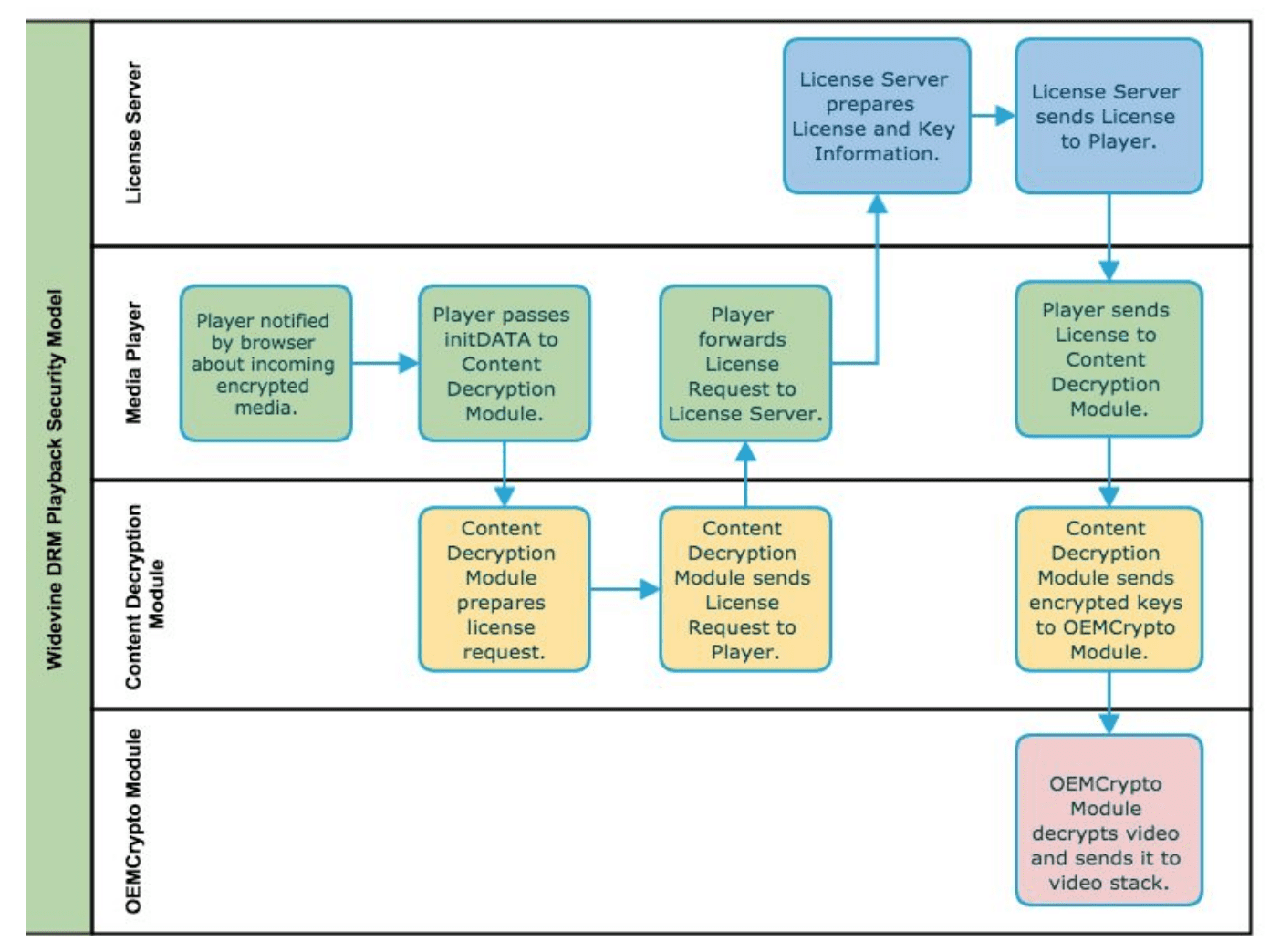

    This might help you.. and if not, it is still a pretty decent read

  5. Originally Posted by gnodde View Post
    [Attachment 64144 - Click to enlarge]
    https://ottverse.com/widevine-drm-how-does-it-work/
    So even if the coded key is the same, every time you get different Widevine Response and can't be stored to view the video in later sessions?
