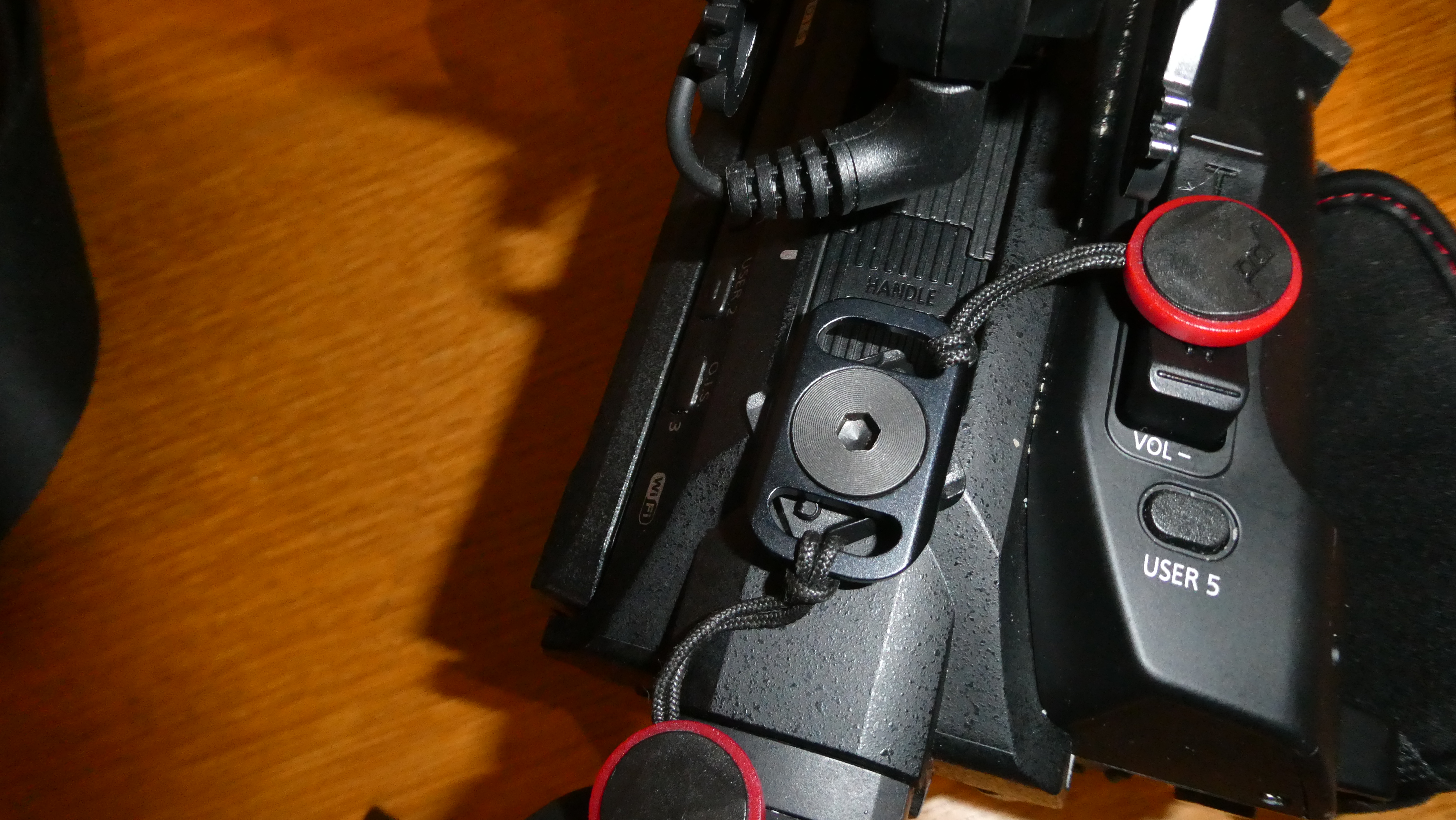

[Attachment 64386 - Click to enlarge]
I used one or these under the handle to keep cables out of the way as shown in the photoLast edited by realspeed; 18th Apr 2022 at 04:17.
