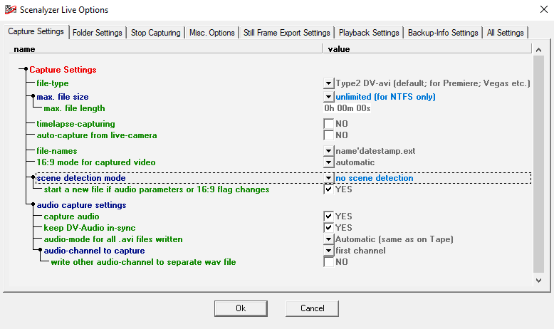

    A question to all Scenalyzer expert here, how to stop Scenalyzer from randomly breaking the up the capture files into smaller files. Some are just a few seconds long.
    I have set the max file size to unlimited.
    Jan 2016
    Go to file/options and change to the values marked in blue:
    [Attachment 64363 - Click to enlarge]

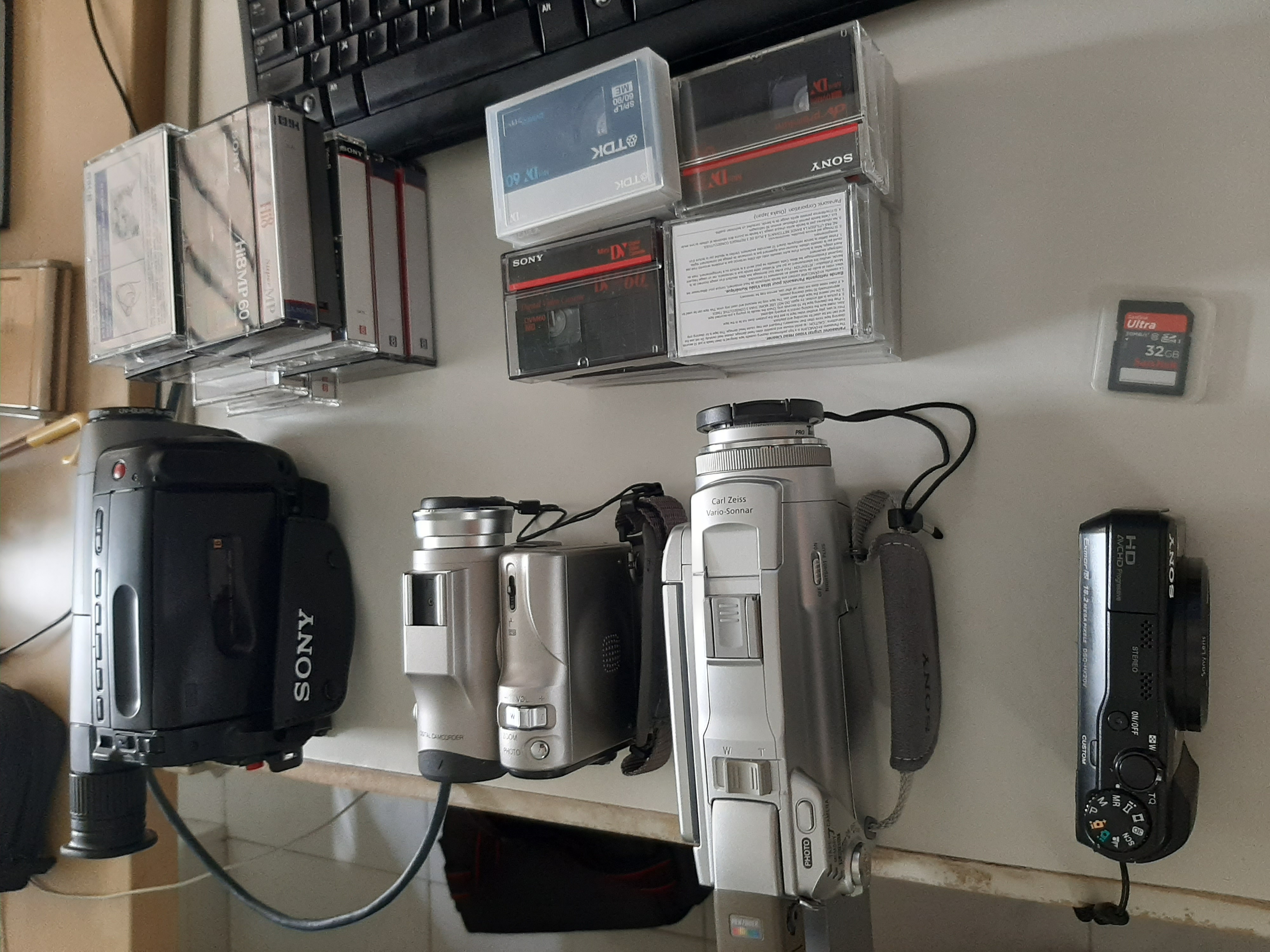

  27. Member pchan's Avatar
    Mar 2003
    Singapore
    Finally, all the video clips are in DV format and stored in 2TB WD Passport USB drive. Total space is about 160GB.
    It all started in 1996 with a Sony Video8, Sharp VL-Z950E, Sony DCR-HC90(died, not in picture) and DSC-HX20V(2012).
    Recently, bought the Sony DCR-HC85E with defective LCD touch screen(white screen) for transferring video to PC. I finally was able to turn ON the A/V to DV mode via the viewfinder and touch panel. All the Video8 clips were capture via pass-thru in DV format. The Sharp VL-Z950E pass-thru was very bad i.e. dropped frame and error. All the Video8 videos capture were done with DCR-HC85E. From 2012 onwards, all video capturing were done with Sony DSC in AVCHD format with SD card.
