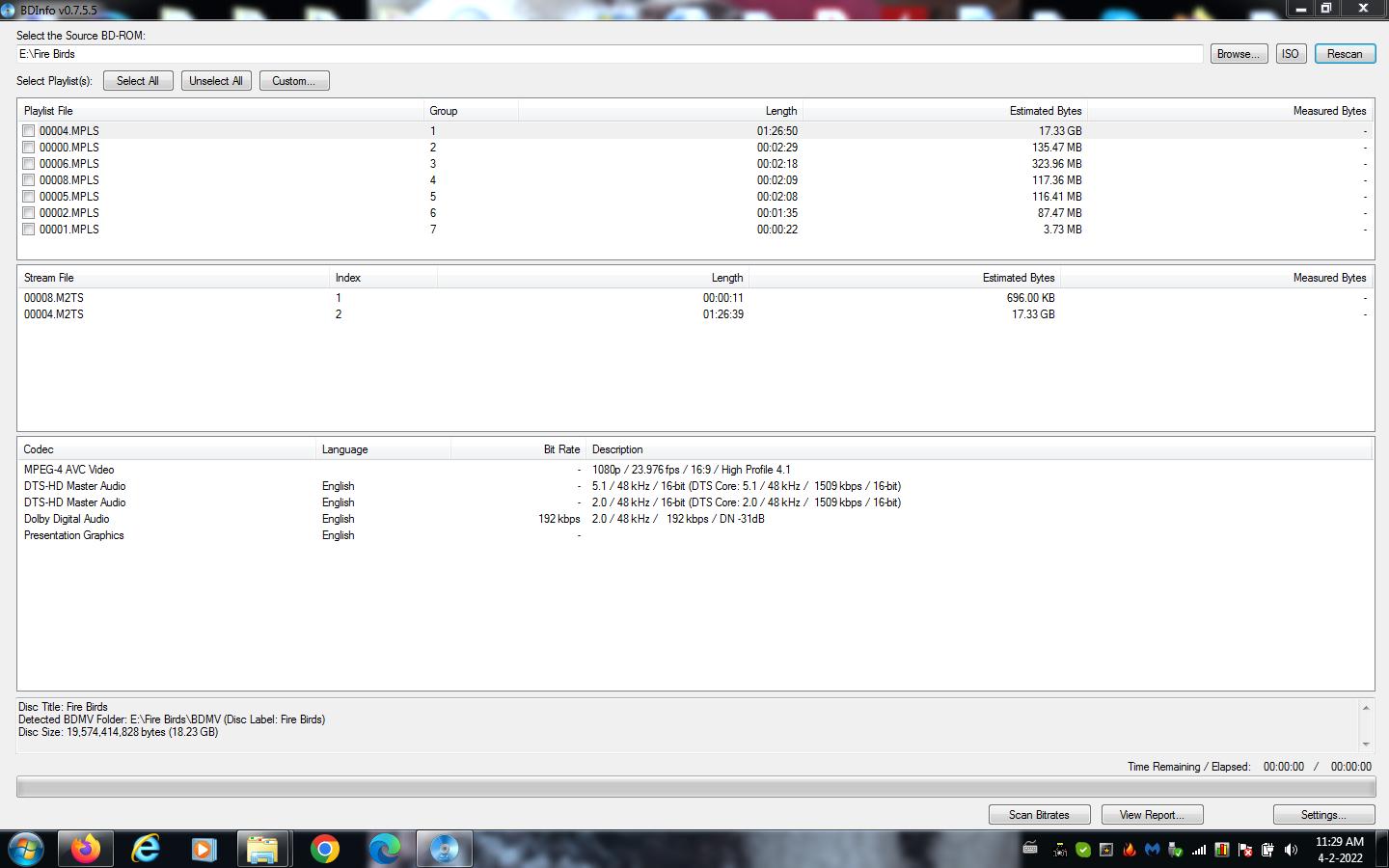

I want to remove 00008.m2ts from 00004.mpls, because I can't add subtitles track. If it is inpossible to remove it, than how to modify 00004.mpls to skip 00008.m2ts when the movie starts. BdRebuilder want to remove both 00008.m2ts and 00004.m2ts. How can I do it?
[Attachment 64103 - Click to enlarge]

I use program mpls2json to convert 00004.mpls to 00004.json. I used https://www.mediafreeware.com/free-json-editor.html to see the 00004.mpls file and deleted it this
"Clip_Information_file_name": "00008",
"Clip_codec_identifier": "M2TS",
"ref_to_STC_id": 0,
"reserved01": 0,
"is_multi_angle": 0,
"connection_condition": 1,
"IN_time": 27000000,
"OUT_time": 27495495,
"UO_mask_table": {
"menu_call_mask": 0,
"title_search_mask": 0,
"chapter_search_mask": 0,
"time_search_mask": 0,
"skip_to_next_point_mask": 0,
"skip_back_to_previous_point_mask": 0,
"play_FirstPlay_mask": 0,
"stop_mask": 0,
"pause_on_mask": 0,
"pause_off_mask": 0,
"still_off_mask": 0,
"forward_play_mask": 0,
"backward_play_mask": 0,
"resume_mask": 0,
"move_up_selected_button_mask": 0,
"move_down_selected_button_mask": 0,
"move_left_selected_button_mask": 0,
"move_right_selected_button_mask": 0,
"select_button_mask": 0,
"activate_button_mask": 0,
"select_button_and_activate_mask": 0,
"primary_audio_stream_number_change_mask": 0,
"reserved01": 0,
"angle_number_change_mask": 0,
"popup_on_mask": 0,
"popup_off_mask": 0,
"PG_textST_enable_disable_mask": 0,
"PG_textST_stream_number_change_mask": 0,
"secondary_video_enable_disable_mask": 0,
"secondary_video_stream_number_change_mask": 0,
"secondary_audio_enable_disable_mask": 0,
"secondary_audio_stream_number_change_mask": 0,
"reserved02": 0,
"PiP_PG_textST_stream_number_change_mask": 0,
"reserved03": 0
"PlayItem_random_access_flag": 0,
"reserved02": 0,
"still_mode": 0,
"still_time": 0,
"STN_table": {
"reserved01": 0,
"number_of_PiP_PG_textST_stream_entries_plus": 0,
"stream": [
"type": 1,
"pid": 4113,
"stream_coding_type": "H.264",
"video_format": "1080p",
"frame_rate": "23.976",
"reserved01": 0
"type": 2,
"subpath_id": 0,
"subclip_id": 0,
"pid": 5120,
"stream_coding_type": "IGS",
"language_code": "eng",
"reserved01": 0
},Last edited by misiuro; 21st Apr 2022 at 08:43.
