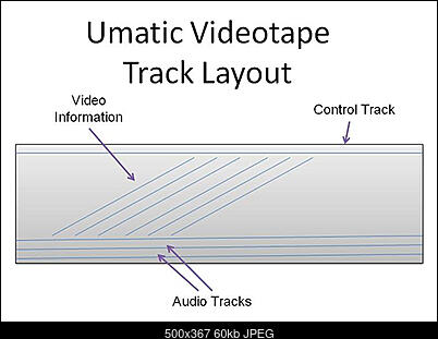

  22. Other than the two video heads in the drum, there's two more heads. One for control / audio along the bottom of the tape, then a second head for control along the top. The dropouts make me think all the heads could use a cleaning, again (all it takes is one play of that tape). I also wonder if the problem tapes have some combination of having been eaten at some point and re-wound, wear from being parked too long, sticky shed, and/or folding along the edge from uneven tension.
    More info over at the UK Vintage Radio Repair and Restoration Discussion Forum on this problem. Section 7-8 is probably what you're looking for.
