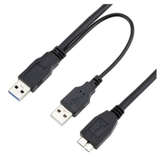

 @usually_quit I did not try the wall thing, I will try it... Edit: do you mean using this cable
 [Attachment 64127 - Click to enlarge]
 If yes, which one is for power and which for data?

 [Edit]Regarding the cable in your attachment. The Micro USB 3.0 connection plugs into an HDD or ODD. The Type-A USB 3.0 connection transmits data and the Type-A USB 2.0 provides additional power.Last edited by usually_quiet; 3rd Apr 2022 at 19:35. Ignore list: hello_hello, tried, TechLord, Snoopy329
	Despite the cable being different from yours, can this work if I connected the power cable into a PC or any USB power source?
 Edit: I feel so stupid that I did not mention the hard was external HDD
 Edit2: I going to have to this cable shipped, which going to cost me literally the same price as the dvb device, I need to know is this gonna work or not first, I mean the USB 2.0 vs USB 3.0 power supply difference theory is at work here or not, sorry I got do with what I have at hand.
 Edit3: the USB 3.0 external HDD malfunction is in the form of very slow response from it or not at all, could is be a power problem?Last edited by mobbdeep55; 4th Apr 2022 at 11:44.
	I have heard of instances where USB 3.0 external HDDs don't work because they can't get enough power from a single USB port on a device (the drive can't spin up or the controller can't operate properly) but that is only one possible cause for the problem. So, I can't tell you for certain if the Y-cable will work or not. Ignore list: hello_hello, tried, TechLord, Snoopy329

	Finally i got this solved: it was really a power issue... im using my pc to supply power to the hdd, anyway when i connect the power cord directly to the pc (usb 3.0 outlet) it does not supply power to the hard, however when i used a usb 3.0 hub by connecting it to the pc then connecting the power cord to it, it worked.
 Edit: the dvb has 2 usb ports, i managed to connect both the data and power cords to it and it worked.
 Thank everybody for trying help and special thanks to @usually_quiet u really got this man.Last edited by mobbdeep55; 6th Apr 2022 at 00:02.
