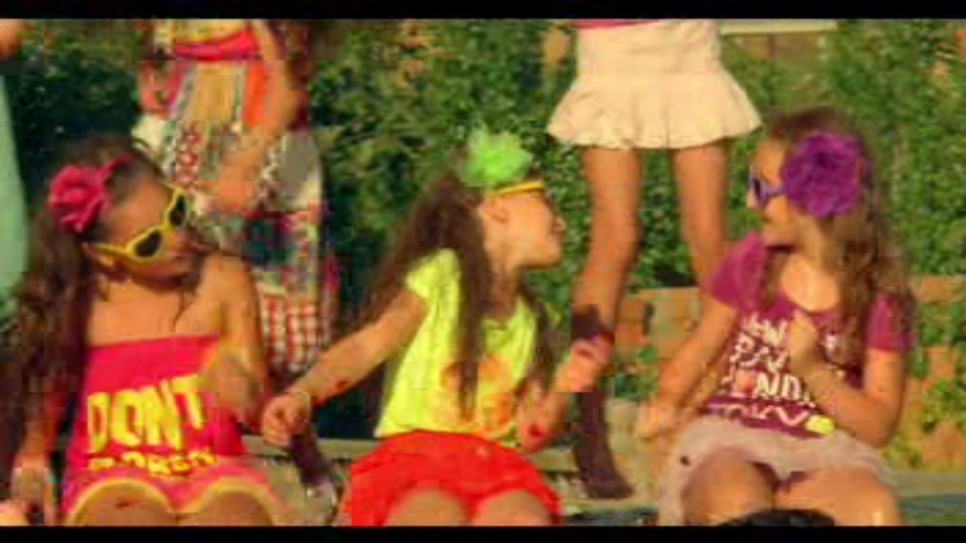

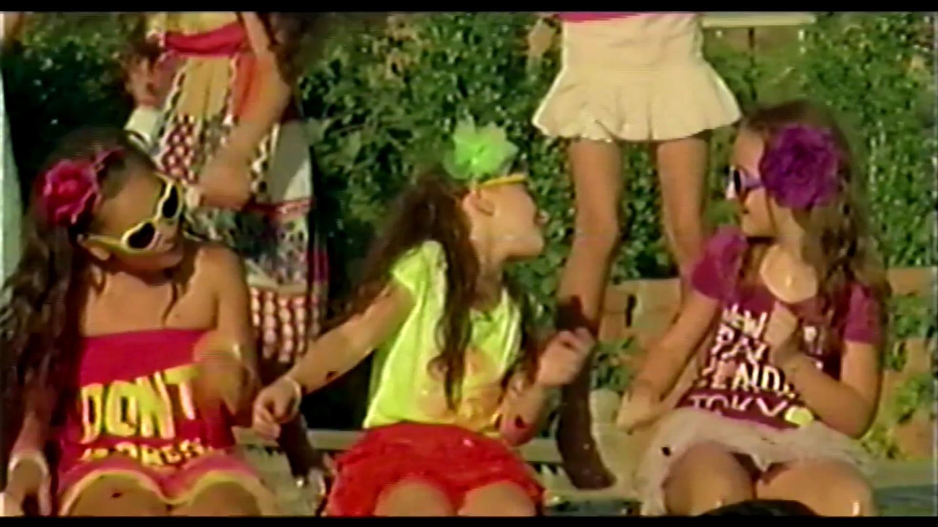

  1. In my opinion in general it is VHS. VCD give better colors and no snow, but the compression is too strong, with fast movements a lot of macroblocks and other artifacts occurs, in my opinion in general vhs has sharper image qaulity with more detail.
    with good tape and recorder quality is more continue.
    First is VCD (PAL but i'm not sure) second VHS (for sure ntsc)
    [Attachment 64087 - Click to enlarge]
    [Attachment 64088 - Click to enlarge]
  2. When VHS is watched on a CRT TV, its vertical resolution (for NTSC) is about 480 * 0.7 = 336 lines and it is capable of 60 images per second. When watching a movie on a TV with good deinterlacer you can get full 480 lines. VCD is limited to 240 lines and 30 fps progressive. VCD does not work for fast movement, for sports, for example.

    VHS is better with framerate, and thus, with motion. VHS is ostensibly better with resolution, but that's only the luminance, and only theoretically.
    Real life luminance with vhs is often (far?) worse than the theoretical, so it is likely more equivalent.
    Vcd has better chroma resolution, even theoretically. Vhs is ~40 pixels of horizontal resolution (with an equivalent reallife vertical resolution, due to bandwidth constraints, even though theoretical says it should be 480ntsc/288pal).
    Vcd is 4:2:0 color subsampling, so it is 160x120ntsc or 160x144pal, and there is no difference between theoretical and practice.
    Vcd is component digital encoding, versus vhs color-under composite analog. So if both were starting from a pristine SD or better master, vcd would much more faithfully reproduce the colors and not have any issues with timebase, unlike vhs.
    Audio-wise, it depends on whether vhs is using hifi audio or not. If using hifi audio, it theoretically is better, though not always in practice (tracking, hum interference...). If not hifi, then vcd is clearly better, even with mp2 compression.
    Compression artifacts in vcd are totally dependent on available bitrate vs. subject material complexity. Since vcd is cbr, this means that it sometimes has enough bitrate, and other times not enough. When it is not enough, usually this is due to motion. Then artifacts ARE an issue.
    Most comparisons I have seen (and the above media example seems to fit that assumption) have used vcd material that is a generation greater than that for vhs, which is not a fair comparison. Having worked for years and years at a production house that created lots of SD material in both master formats (1"C, Betacam, Digibeta, etc), and in vhs, vcd and dvd consumer formats - all directly 1 generation from the masters - I can say that when done properly, dvd is easily best, then vcd is next if there isn't much motion (or if the framerate started as filmbased 24/23.976), then vhs is next, then vcd with high motion is last. Overall, in practice they (vhs, vcd) are basically equivalent, quality-wise.
