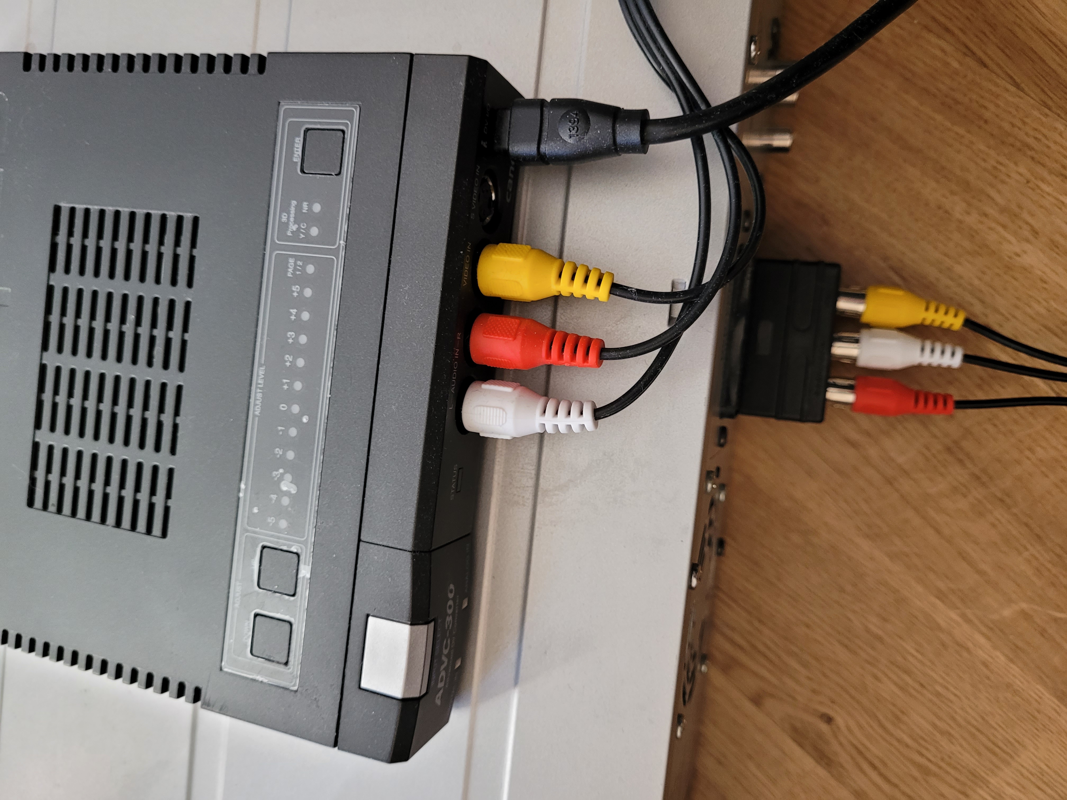

    Lets look at the connections. Im forced to go with a scart-adapter.
    Then via firewire 4 pins to 6 pins.
    [Attachment 64222 - Click to enlarge]
    I´ve tried a handfull of different softwares on the computer, but the crappy signal is instant.
    I got a newer VCR with HDMI-output, would that be a better solution, with hooking it up to the ADVC?
    Or should I just dump the ADVC and look for a better converter?

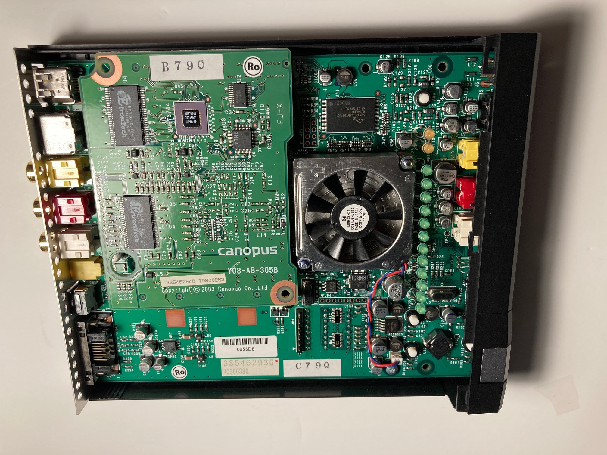

    The advc 300 is a real "bear" to open with no prior experience without damaging it.
    So I wouldn't recommend trying this yourself, until you've had a little practice or talked with someone who has experience doing it.
    But unless your repairing one there isn't a lot of reason to open one anyway.
    Its a two board "system" with a dedicated Time Base Corrector and Full Frame Synchronizer, and 2D or 3D Comb Filter (for Composite) or by-pass for S-Video and Component (D1) signals.

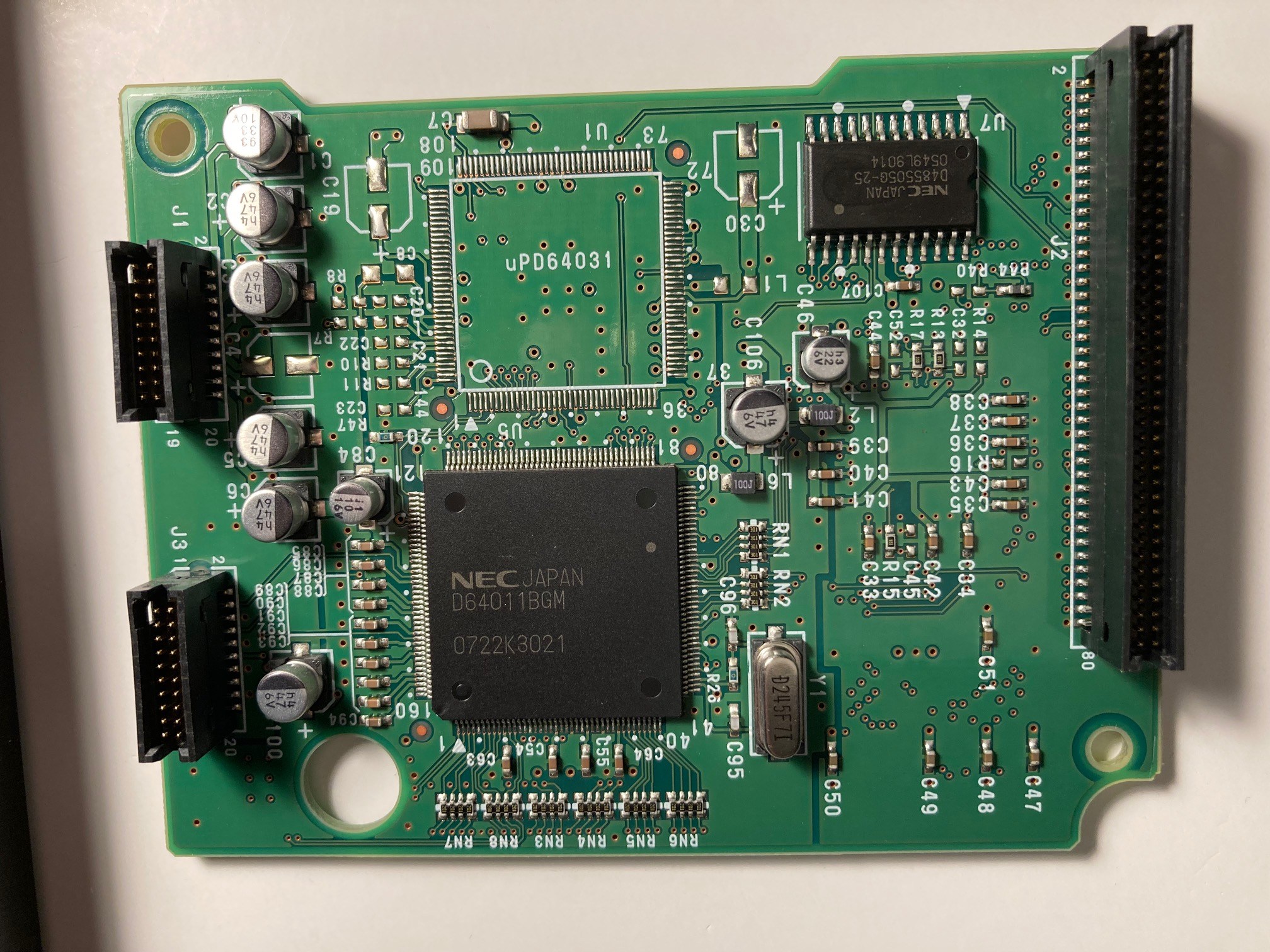

    To my untrained eye.. the card looks very similar to what was used in early DVD recorders from Panasonic sold world wide.. very similar.. except that in the ES10 and ES20 the precise part numbers seemed obscured or re-indexed so they couldn't be quickly recognized by a casual inspection.
    This is a simple Block diagram from a flyer for this TBC/Frame Sync chip
    Commenting about the rest of the chips on the mainboard, the "fan" covers and obscures what I think is the main computer processor controller which ran the firewire interface and switched inputs and outputs and controlled the NEC µPD64011B 3DYC Separator Video Decoder on the bottom of the TBC/Frame Sync card
    The µPD64011B provided the separate functions of proc-amp, 2D/3D Comb Filter and video decoding.
    note: all those Surface Mount electrolytics !!! Yikes
    Many of those caps are going to be nearly 20 years old, even the best cap doesn't last forever.. and slowly raises its ESR value which blocks signal "attenuating it" making the picture grow darker.. and the details fuzzier.
    I wouldn't haul out and replace them all, but I bet the video picture captured 20 years ago was a crisp bright sharp image compared to what is still possible today.
    I don't know "for sure" but its possible since the S/N ratio is going to decrease as signal levels fall, the ability of the TBC/Frame sync chip to distinguish sync from noise will also get worse over time. One way of combating this might be to put a video amplifier in front of the Input and increasing the GAIN artificially, like with a proc-amp .. or replace the caps.. but circuit card work with Surface mount components is rather hazardous to the card.

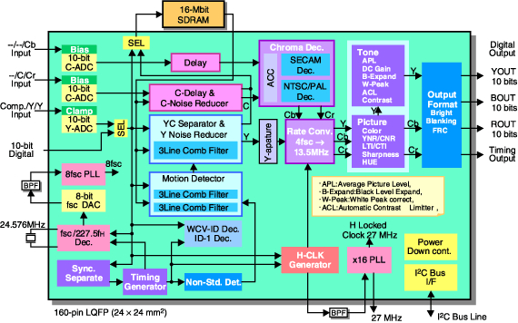

    Here is a simple Block diagram for the µPD64011B chip
    The later MN673747 chip would bring all of those function onboard into one single LSI chip (Large Scale Integrated Chip, not LSI Logic "the brand") and support WSS signals natively.. it was the 1st generation of HDTV.. which Japan had its own terms for that too.. but thats another tangent.

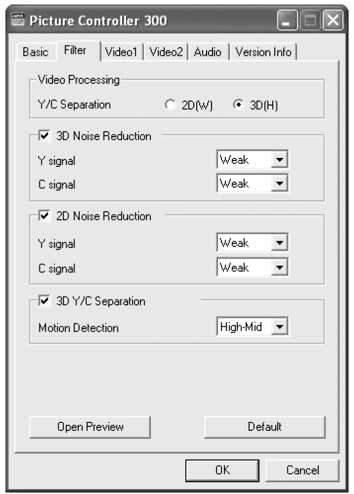

    One other thing about the ADVC-300 some of the settings can be accessed from the Dip switches on the bottom of the unit, some can not. The Windows XP and Mac 10.6.8 "firewire" picture control software is the only way to change some settings.. which are then saved to the non-volatile ram on the ADVC-300.
    If you have never downloaded and used the "Picture Control" software, you may be running the unit with only the Dip switch settings and benefiting/(or suffering) from either the factory settings, or the last settings made by the last user of the device.
    In particular, I have seem some "ringing" on the Left hand side of video captured using 3D Comb filters.. it may occur in other situations.. but in theory the SCH and Phase of the Horizontal timing controls may be able to cancel this out.. I have not experimented with this.. but having control over these settings when using Comb filters seems to be a $5000 feature in some old scan converters.
    But pay attention to all of my caveats above.. I don't know what I'm doing.. I am no professional.. I'm mostly just an observer.
    There is a "whole lot" of English versus Japanese ('cultural') interpolation to those dialog boxes.. but I'll leave it there..
    Simply don't try to interpret the Alphabet and use of words precisely verbatim when changing those settings..
    They made a great product, but English was not the translators first language.. so make "allowances" for interpolation
    Example:
    Y/C Separation [_] 2D(W) [x] 3D(H)
    "Literally" this means prioritize 3D or 2D Comb filtering when breaking a Composite signal down into Chroma and Luma.
    Only selecting [x] 3D(H) will enable the 3D Comb filter, otherwise it will default to using 2D line Comb Filtering or less
    "W" refers to "wide" or the horizontal "line" filter.. imagine a person waving their hand like the wings of an airplane to explain the meaning
    "H" refers to the entire "field" or "frame" from Top to Bottom, since 3D Comb filtering works by comparing two fields or frames.. its a temporal comparison not spatial.. but sorta kinda.. gets the meaning across.. awkwardly
    You can't unselect 3D and not select 2D or vice versa.. so they used "radio buttons" in the interface to represent the choice
    (to me this is very confusing.. but after thinking about it for a long while.. you sort of get the "gist".. of what they were trying to communicate to the user).. that is, select 2D or 3D Comb Filter priority
    Noise Reduction, 3D Comb Filter "sensitivity" are topics of their own.. but I think they don't need a lot of explanation
    Same for Edge Adjustment
    The Video AGC is very robust, giving you control over the trigger value for Chroma and Luma separately, or to just turn it off entirely
    AGC and 3D Comb are at odds.. and I "think" confuse a lot of people.. until I dug into the maths recently I didn't know they were entangled and linked.. its easy to get them confused as doing what the other is doing.. using them together is the worst case scenario
    The ADVC-300 Users manual.. is in Japanese, roughly translated into English and a few other languages.. long before Google Translate.. when few people understood video capture or analog to digital conversion.. so it comes across as kinda "rough".
    Basically most of the sections on Picture Control, recommend.. "if you don't understand this manual, try turning the settings off and on watching the effect on your capture" which is sort of a catch all for.. "if you don't understand our English, then try this???"
    It was a good product in its day.. apparently a lot of people didn't mind a little puzzle solving.
    Other people just got frustrated and re-sold them

    Does anyone have the ADVC-300 diagram where it shows all the paths between chips including the DV encoder chip? Has there been any published?

    Feb 2018
    College Station, TX, USA
    I honestly can't recall if I have or have not seen the full ADVC-300 circuit diagram.. maybe is all I can say
    But its not a hard a path to trace out
    The connector pins from Composite will connect to Ground and Signal
    The Connector pins from S-Video will have two Ground, one Y and one C (not that much harder)
    The traces on the circuit card are rather large and they do not appear to be multi-layer boards
    .. i mean its almost childs play
    you know.. the subsequent, ADVC-500, ADVC-1000, ADVC-3000 and the ADVC G1 and ADVC G1a probably followed suit as well and included TBC and Frame sync stages
    all made in Japan, but they didn't advertise TBC/Frame sync because like I said.. they were confused by the way we talked about it.. to them it was obvious you needed those features for consumer gear
    GV also acquired Snell and they also had single board "do alls" with tbc and frame sync, but they preferred the Analog Devices chips
    man lots to think about

    studying this ADVC-300 tbc/frame sync card a little more;
    the NEC µPD64011B is a member of a "family" of chips that not only has an Analog Input path, but (also) a Digital 10 Bit path, and can access a shared SDRAM memory.
    so that means using the Matsushita (MN674744) chip did (Not) have to pass the signal through A/D twice
    in fact I found a Japanese article referring to NEC being very proud that their NEC chips would be used in the "new" Toshiba RD-XS DVD recorders, their modular structure included the 10 bit Digital or SDRAM interface to avoid multiple A/D conversions when stringing these chips together
    sad to say.. it looks like the ADVC 500, 700, 1000, 3000 and beyond.. specifically did not include a TBC/Frame sync chip.. but I also have not had an opportunity to see what chips they did use
