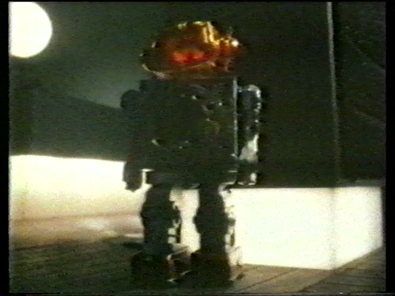

    I´ll try to put a printscreen of it here:
    [Attachment 64065 - Click to enlarge]

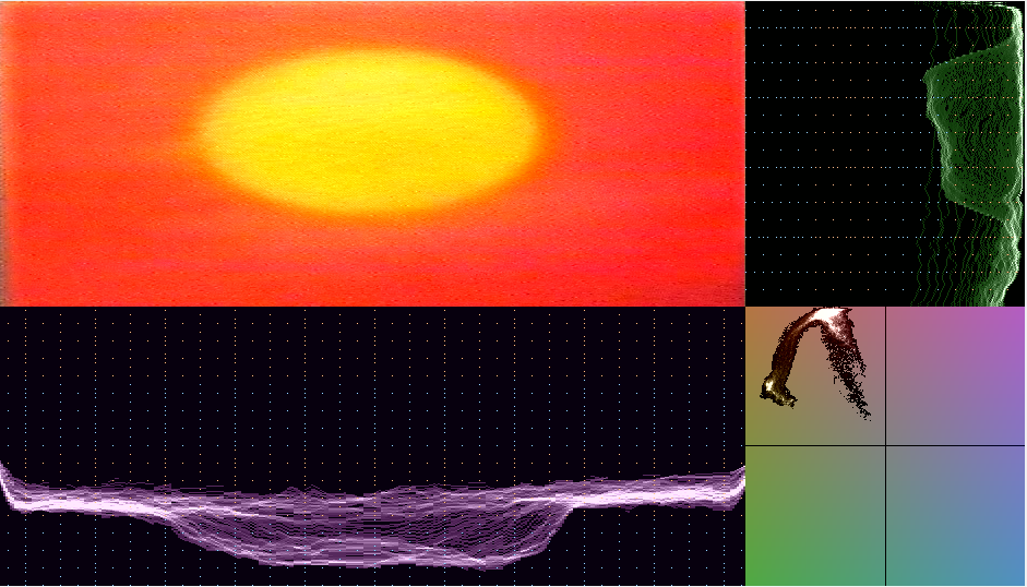

  22. The capture should have been better to begin with. I don't know at which stage the the colors and interlaced structure have been messed up, driving the colors partially even beyond legal YUV (YCbCr) values (e.g. the sunset scene with V(Cr)=255 clipped) - not to mention legal RGB. Now one can only try to fix it.
    It looks to me like the original source has been edited by some tool (applying cuts, transitions, maybe intentional 'artistic' color tweaks as some people prefer highly saturated colors and a reddish sunset tint .....). Perhaps the OP knows more about it.

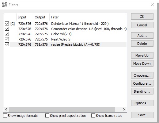

    Here's my effort, solely using Virtual Dub (I cheated on the noise reduction! )
    I'm not very good on the VDub X264 encoder; I couldn't work out how to get a 720x576 4:3 export so I used 768x576.
Name:	VDub settings Summer.jpg
