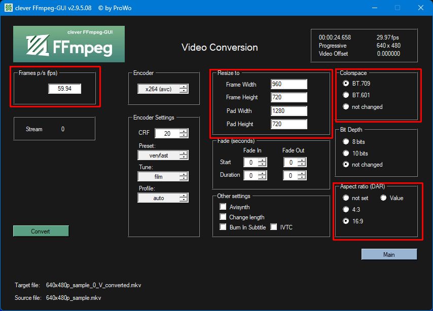

  13. According to bluray specs you can use 1280x720p 59.94fps.
    https://en.wikipedia.org/wiki/Blu-ray#Video
    Load your video in clever FFmpeg-GUI, click main, click convert videostream, click resize, set all parameters like on the photo and click convert.
    [Attachment 64086 - Click to enlarge]
    This will result in a 1280x720p 16:9 video with your original video in 4:3 ratio.
    That would upscale the files, though. I don't want to do that. I want the HD files to remain HD and the SD files to remain SD. My 4K Blu-ray player's built-in upscaling can make SD look better than upscaling it with a video conversion program can.
