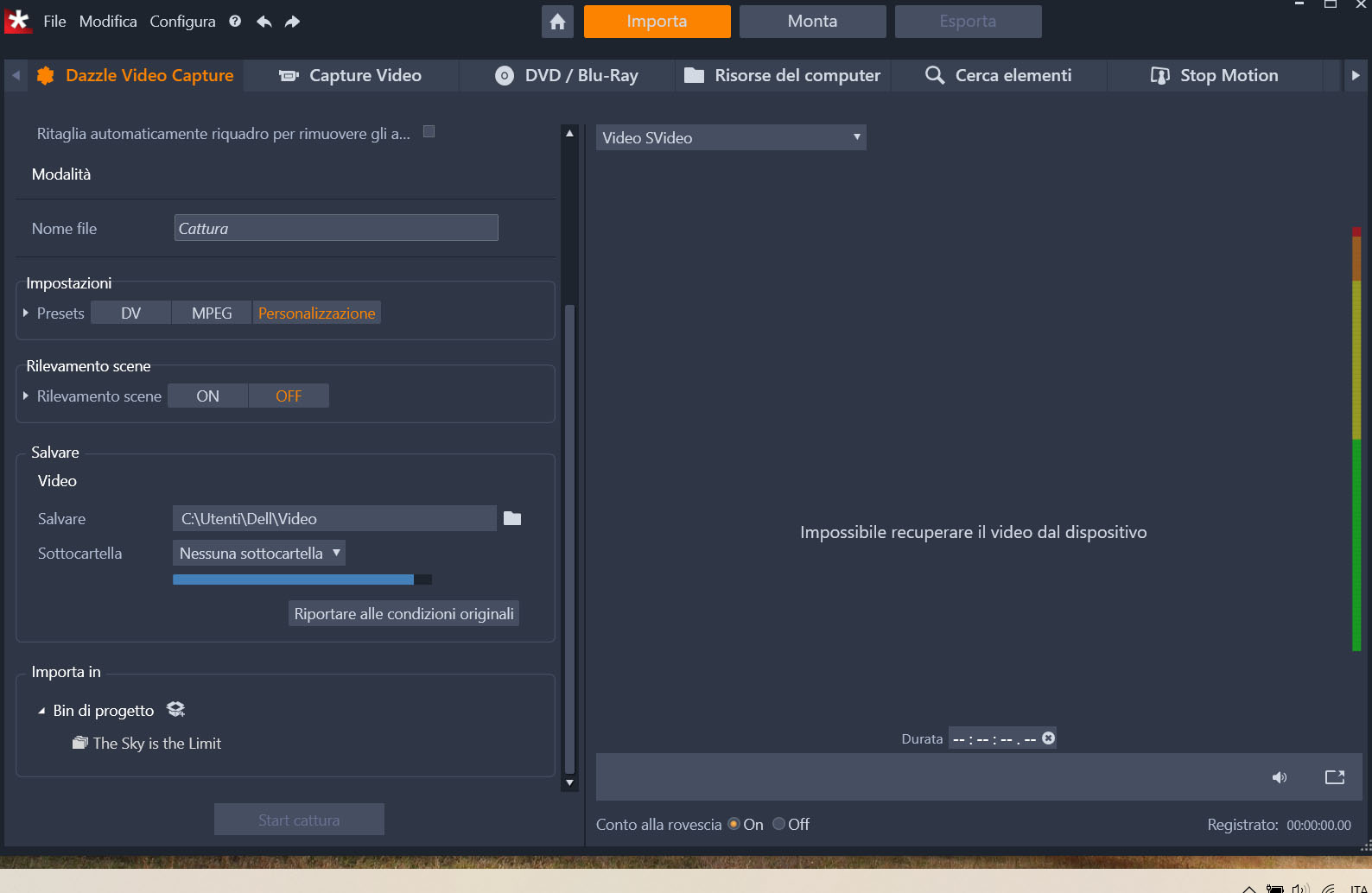

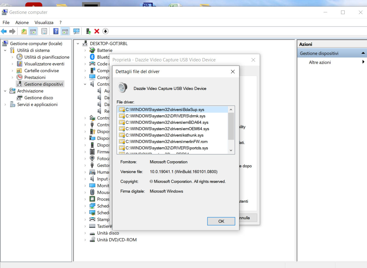

	Here the screen for the msg from DAZZLE on attemping to capture and the video drivers as well. (it is italian but it's pretty clear it's saying "impossible to capture from this device")

	Drivers seems OK. I feel the matter is somewhere else. Please help me. Thanks
	Your capture app shows that you are capturing from "Video SVideo". Is this correct? Just checking.
	Yes it is on S-Video (and it goes by itself on connecting the USB). I even tried with Composite wire but it doest' work as well, same msg.
