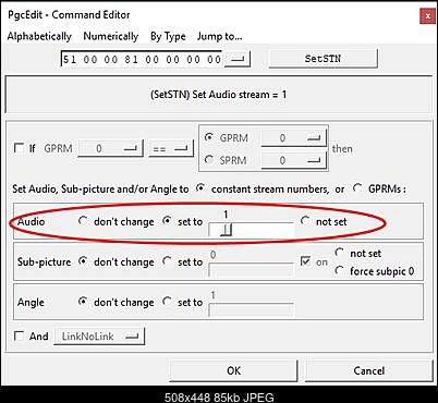

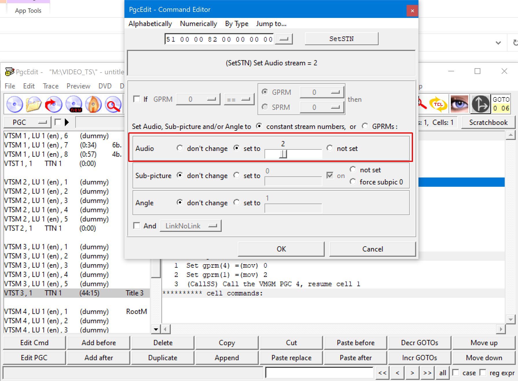

  2. The audio (and subtitle) is set by SetSTN. It can't be used in VMGM but is restricted to the VTS domain.
    You could set it in the pre-command to the movie(s) like this:
    [Attachment 64028 - Click to enlarge]
    and select the audio track:
    [Attachment 64029 - Click to enlarge]

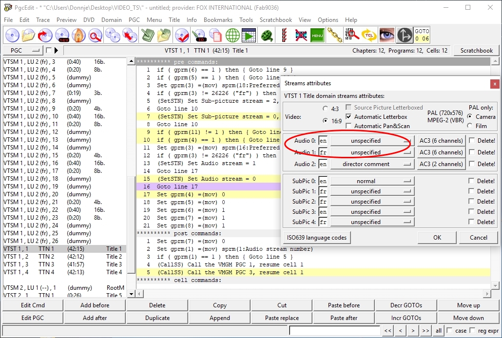

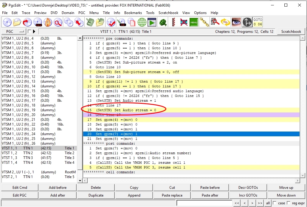

  6. I want to replace the default audio, is that correct?
    In streams attributes I have
    Audio 0 = en
    Audio 1 = fr
    Audio 2 = in comment
    default part in audio 0 = en
    I would like to change it to Audio 1 = fr
    I go to "15 (SetSTN) Set Audio stream 0"
    and change to channel 1

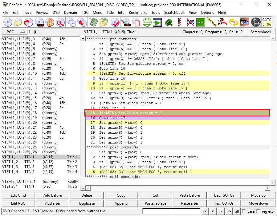

    I entered for all the titles, but I didn't understand how and if I have to add a new line, this is the situation
    sorry for my bad English
    [Attachment 67969 - Click to enlarge]

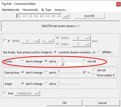

  13. Member Skiller's Avatar
    Oct 2013
    Germany

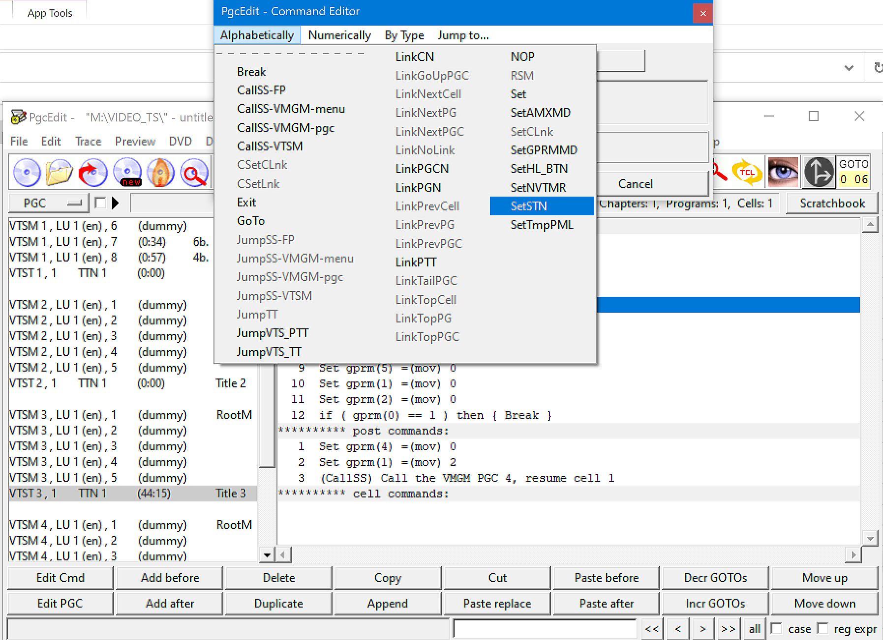

    Click on the first line (1), then click on "Add before".
    There is now a new line at the top that says NOP.
    Click on "Edit Cmd" and then Alphabetically -> SetSTN.
    First line must say (SetSTN) Set Audio stream = 1
    Click on all original SetSTN lines (except the ones for the subtitles) and turn them into NOPs by clicking on "Edit Cmd". Alphabetically -> NOP.
    Repeat for all four titles.
    Hope this helps.
  14. Originally Posted by Skiller View Post
    Hope this helps.
    it works,great
    I left the line of sub 6 and 8 as you told me, do you think it's right?

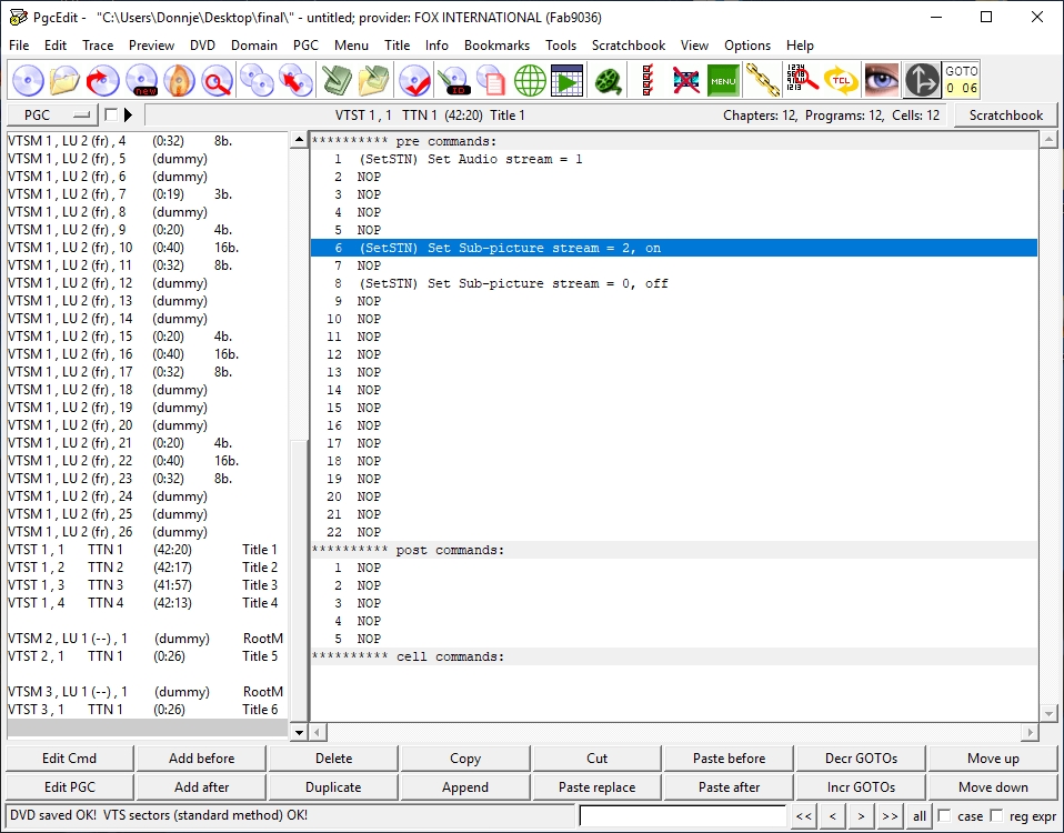

    [Attachment 67980 - Click to enlarge]
  15. Member Skiller's Avatar
    Oct 2013
    Germany
    No, that's not right and not what I said. You should only turn the two audio related SetSTN commands (original lines 13 and 15) into NOPs, not the entire pre and post-commands section.
    This will break a couple of things for sure.
    Technically, just adding the new SetSTN command at the top should be enough to do the trick but turning the original (audio) SetSTN commands into NOPs is just for safety.
