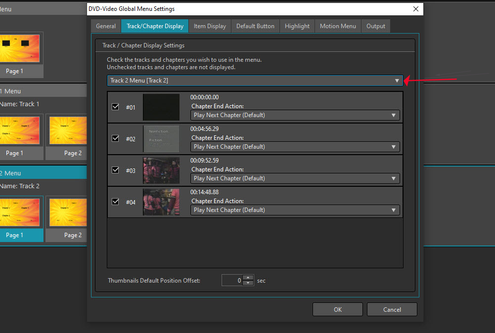

    Try this then: when you are in the menu creation screen, click on the "dvd global settings". This opens a new box. Second tab in is called track/chapters. Click on this tab. Now you will see the chapters for your title 1. However its a drop down box, so if you click on that it will show the other titles in your project. Select another title and even if it has no chapters it will still show at least 1 box for a chapter checked. Uncheck the box and hit ok. See if the menu will now disappear for that title. I have a snapshot below on which section you should be in
    [Attachment 64163 - Click to enlarge]
    The menu system I could say (as johns0 had commented) is easy-- if you are not too finicky and do not need something specific. If you need to be specific, TAW6 most certainly limits what you can and cannot do. I also agree with guides for TAW6. Tons of them for version 4, some for 5, but very little for 6. For record sake since you had mentioned it in the first post, Ulead dvd workshop still runs on my windows 10. Sometimes it can be buggy, but it works. I wish TAW6 had a menu layout system similar to that. Then again I'm mostly doing blu-rays now rather than dvds. You also may want to you into dvdstyler Its a free program for menu creation and dvd authoring. Ive personally never used it, but it has received a lot of mention here on the forums over the years

    Thanks mazinz for trying but no go. Here's the issue. I have already attempted your guidance above before posting here. It works to eliminate my one chapter for the extra title and therefore eliminating the need for a chapter menu for the Extra title - great!. However, I end up with one Main menu with two buttons -- 1. Play Main title. 2. Play Extra... but no Chapter menu button for the Main title on the Main/Top menu (?!). In order to get to Chapter menu, TAW6 is making me select Play Main title --> then Sub-Menu has two buttons: 1. Play Main title and 2. Chapter menu for Main title (another sub-menu). I think I may be too finicky by asking for these buttons on Main/Top menu: 1. Play Main title, 2. Chapter menu for Main title and 3. Play Extra title.
    I hope what I'm relaying above is clear and 'logical' but likely too finicky. I loved DVD Workshop2 -- awesome authoring program but outdated and doesn't output 5.1ch. But so flexible with menu creation; I can do whatever I choose with however many sub-menus, linking is so easy. I have an old Win7 that I run it on and refuse to get rid of it. I have tried many times to install Workshop2 on Win10 but unsuccessful..ugh. I gave up. Many thanks to you for taking the time to help me, much appreciated!

    No problem. Its not you being finicky, what you are asking is something that is very common. It is a limitation of the program. You could always send them an email and suggest the option by telling them your problem. The Tmpenc staff have always been good at replying for anything I have asked them before. I would go to their site and send them a message.
