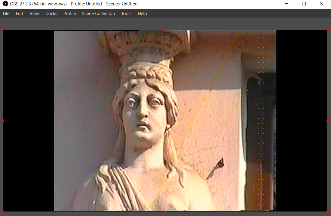

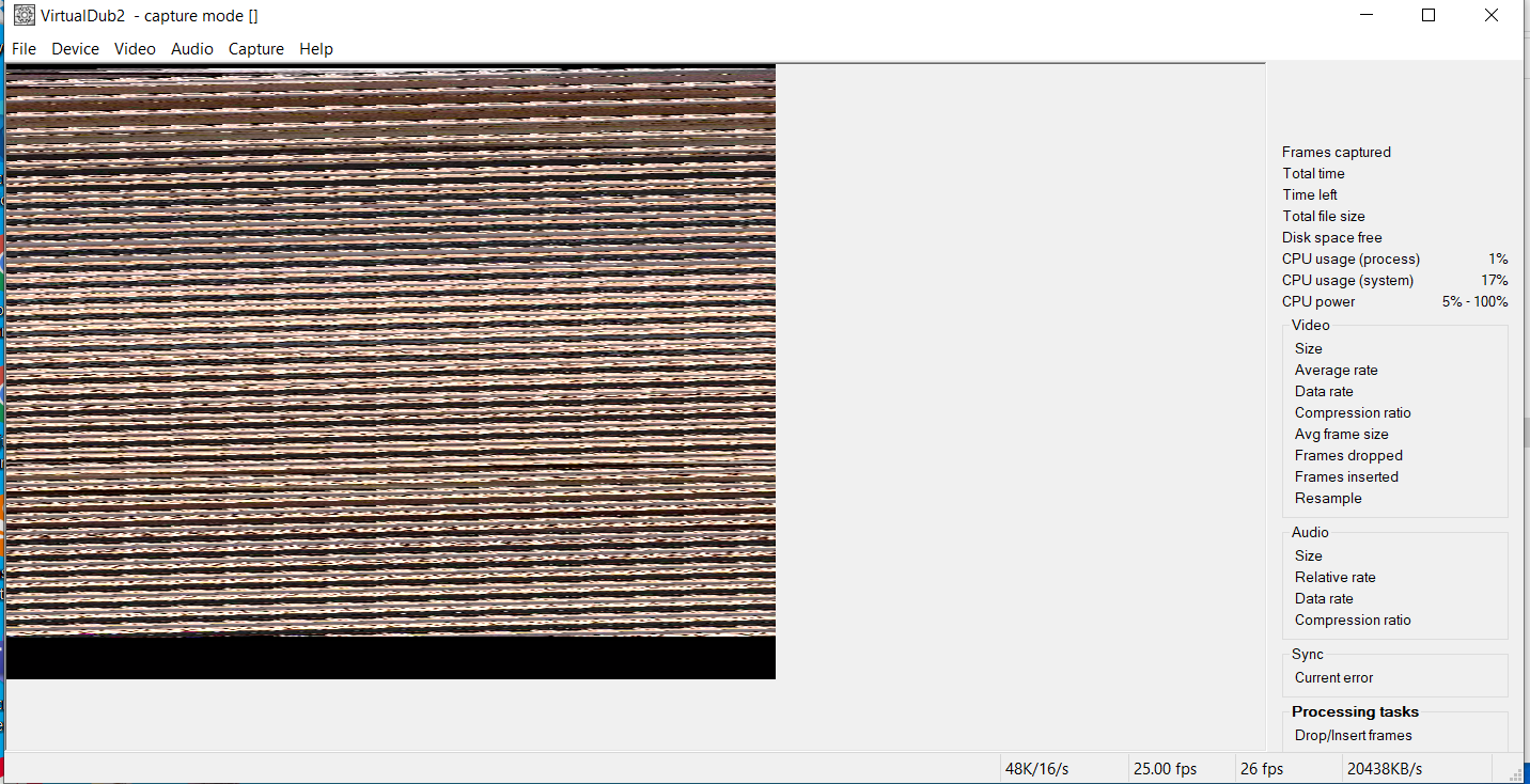

recently i aquired digital video camera, that records on VHS-C. Being quite amazed by it, i wanted to record some movie and upload it to youtube. But my firt problem was getting the video to PC, i managed to get the basics done and now i have problem with VirtualDub video input in capture mode.
Basically it for some reason disorts the video and i have no idea why, even tho, when i try to use OBS, the video is all right. I will atach some screens belove:
[Attachment 63919 - Click to enlarge]
Here is some disorted footage in VirtualDub
[Attachment 63920 - Click to enlarge]
And here is same footage in OBS, not being disorted.
So i would like to ask, what can i do to make it work in VirtualDub, or is OBS as good as VirtualDub and i should work with OBS? Thanks very much in advance.
Edit: Ive tried to look on this forum/web for simmiliar problem but could not find much. And my source is PAL.

This comes over as a cheap Easycap (easycrap) chinese clone

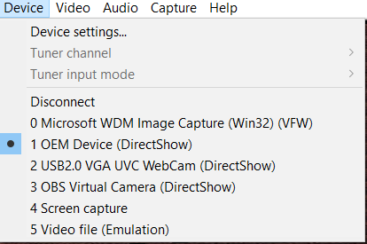

Possible that vdub can not recognise the device. What options do you have in the 'Device' menu ?
OBS is not really suited for analog video capture (although people do claim to have used it successfully). An alternative - better - option would be AmarecTV plus a lossless codec (not the codec that AmarecTV wants you to use)
Also are you using vdub (the original) or vdub2 ? The first should be used for capture. -

I have these options in Device menu:
[Attachment 63923 - Click to enlarge]

I am using vdub2. In the original, i could not get any capture footage (i was checking web about this issue and it was suggesting it has to do something with Windows 10 and recomended using vdub2). -
There is a miscommunication between VirtualDub2 and the capture device over the frame size. Go through the VirtualDub and capture device settings and make sure they are set to the same frame size.
Originally Posted by DB83
OP did you try to switch between overlay and preview?

So, ive tired your suggestions. I tried to switch between preview and overlay but nothing happend (because the screen was black regarding to new problem), plus i think i have a new problem.
As you all pointed out, my capture device is not best and lately ive had a some issues to even get it worked like in my original post.
Now in vdub it shows just black screen and in the OBS, which showed video fine, now it sometimes shows video, sometimes black screen.
So, for eliminating this avoidable element, may i ask, what capture device would you recommend? I would prefer reasonable price!

But did you also check my other suspicion that you may actually have a NTSC camera and not a PAL one. That black bar at the bottom of the preview screen is not there for nothing.
