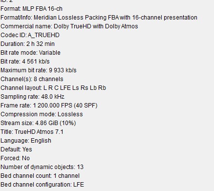

    In case my Atmos track is the issue, I've attached a description of that track:
    Can anyone give me a recommendation?

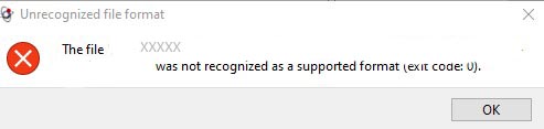

    Thank you for the suggestions. After using both clever Ffmpeg-GUI and MKVToolNix, they proved that I have a different issue.
    clever Ffmpeg-GUI loaded the video file and allowed me to remux with only the Atmos audio track. However, my media setup will not recognize or play the audio.
    Both MKVToolNix and tsMuxerGUI do not recognize and will not load the Atmos audio track. The error message from MKVToolNix is attached.

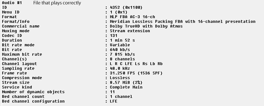

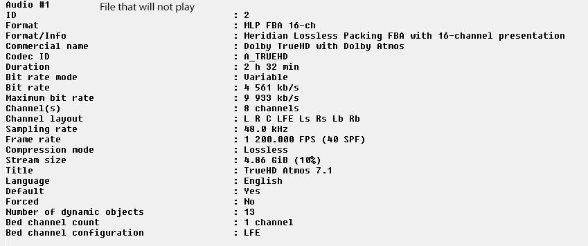

    I have other videos with Atmos audio and they play correctly. I've attached audio descriptions from MediaInfo of the file that will not play and another file that plays correctly. There are differences in the descriptions but I don't understand the significance of the differences. I'm wondering if the issue is a codec problem.
    I'm still trying alternatives with the video that will not play. I'm wondering if Handbrake will recode the Atmos audio to a different format of Atmos that will work.
Name:	file that will not play.jpg
Name:	working Atmos.jpg

    I actually use two media players:
    1. WDTV Live - this unit plays Dolby Atmos using the HDMI pass thru option to my Denon 7.1. A/V receiver.
    2. Hard drive attached to my Samsung 4K TV. HDMI is connected to the TV for video. Optical is connected to my Denon 7.1 A/V receive for audio.
    The WDTV will pass Atmos to the Denon receiver and will play. However, it can not play 4K video. (my video file was 4K Dolby Atmos)
    The Hard Drive connected to the TV and Denon A/V receiver will play 4K video and Dolby Atmos (i.e. other video files work). Since Atmos in the video in question, would not play, I now suspect that there is something in this Atmos stream that is incompatible.
    As part of my testing, I have a Dolby Atmos demonstration video that includes both an Atmos stream and an E-AC-3 JOC stream. When played in a compatible device the video plays excellent Atmos. When played in a non compatible device, it plays the E-AV-3 JOC audio. In this case, the audio plays a message telling how to connect it to play Atmos. When I play this file on the Hard Drive/TV combination, I hear the E-AV-3 JOC audio. When I play it on the WDTV, I hear the Atmos file. I'm now looking that the audio settings on the TV to see if there is some setting that I need to change.
    Optical audio does not pass Dolby Atmos. https://downhomedigital.net/blog/can-optical-cable-carry-dolby-atmos/
