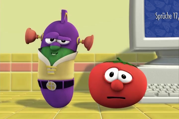

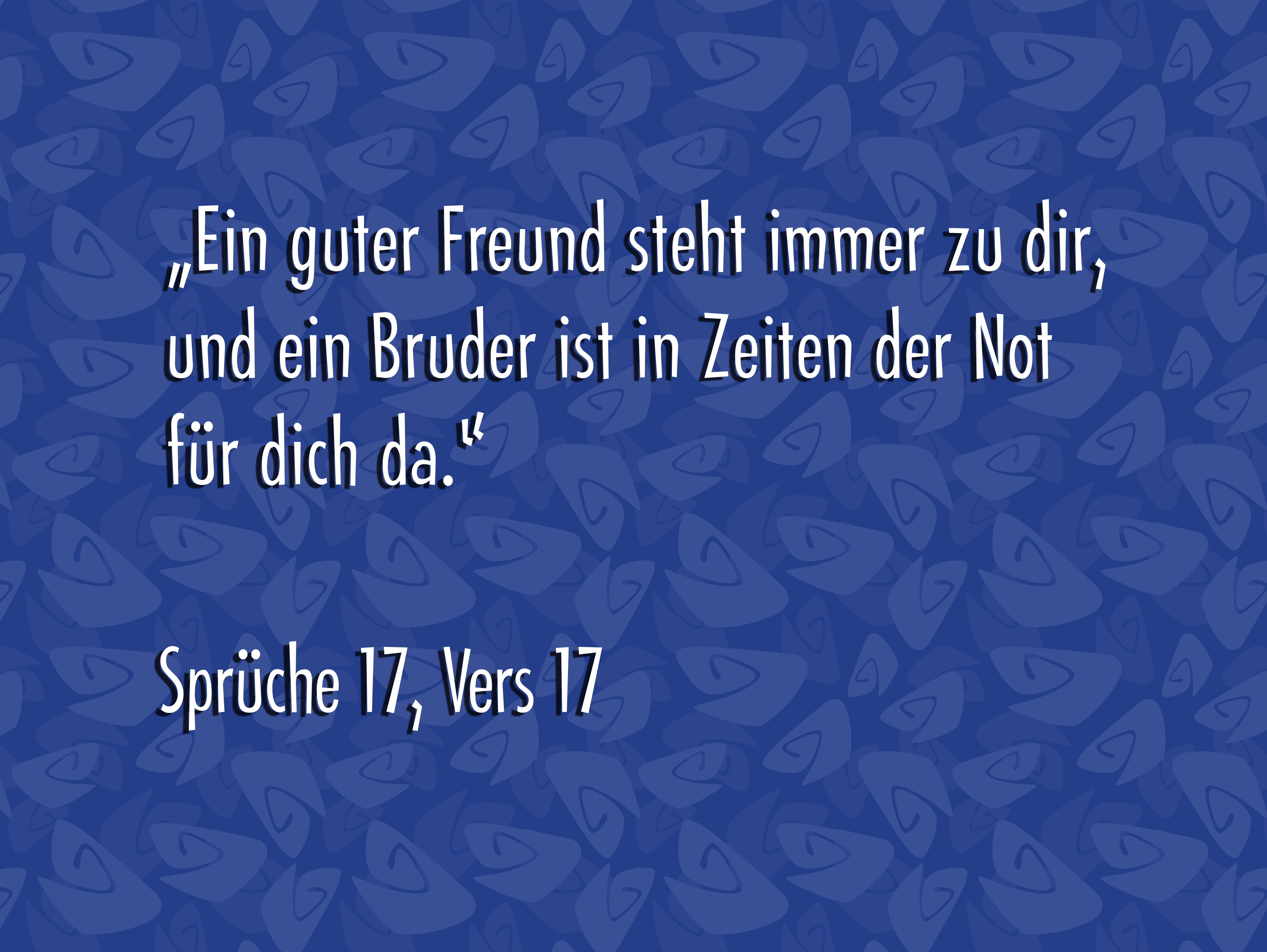

  1. Now, as I've stated in a previous thread, me and a few friends are planning on doing a series of German fandubs of scenes that were cut from the German dubs of some VeggieTales episodes. I will be having the Bible verses that Qwerty shows in the closing countertops localized. However I feel like I can't do this myself. I think I'm really gonna need help. I have made the verses unbulged, though. The first episode we will be dubbing the scenes that were cut from for is Sheerluck Holmes and the Golden Ruler. Here's the German verse I've made:
    [Attachment 63878 - Click to enlarge]
    Here's a link to the folder consisting of all the clips to use:
    https://drive.google.com/folderview?id=188iu3fpDUy5qRFsOuzivhbRD6-CQRENL
    If you don't know how to replace the English verse with the German verse, try using "screen insert" and/or motion tracking, whatever works well.
    If anyone's willing to help, let me know. Don't forget to send me the edited footage when done.
    And as more scenes get dubbed, I'll be updating this thread.

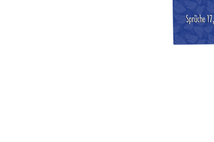

  2. If you're serious about this project - you should learn how to do it since you have more than 1 scene to complete
    You need need to learn how to make bezier masks and animated masks (rotoscoping) for the screen inserts. You need rounded masks, because the screen to be replaced is not a "rectangle" with sharp corners, and it has a bouncy cartoony animation
    It's analogous to "cutouts" or masks in photoshop, and there are many tutorials online. Probably hundreds of tutorials for "screen replacement", but the majority will be for something like replacing a moving cellphone screen, not a cartoony squash/stretch/morphing screen. But the masking and compositing concepts are the same
    Another way to semi-automate the masking besides "mesh tracking", is "rotobrush" in After Effects - It can reduce the amount of manual work for the animated scenes, but it's generally not as accurate as manual rotowork
    The other 4 clips are static for the insert. Basically 1 composited frame with alpha channel is all you need for those, since they share the same framing, no motion in terms of camera or monitor animation. You can just overlay a png with alpha channel ("insert_rgba.png" below)
    The more time consuming part will be rotoscoping "Qwerty displays the verse.mp4" clip, because of the animation. The insert (your overlay) is known as a "squash and stretch" animation, and it's limited by the bezier mask of the screen insert.
    But before you start , every 5th frame is a duplicate. ie. it has not been IVTCed correctly to 23.976p. Also it looks improperly deinterlaced - there are deinterlacing artifacts with aliasing and combing . If you want to do it properly, I'd IVTC the original DVD first. If you don't have the original, at least you should decimate it to 23.976. ("comp.mp4" was decimated to 23.976p so the frames won't match if you use a 29.97 project)

    A few things to point out:
    1. FYI, I ripped the original footage from an ISO of a DVD of VeggieTales: Sheerluck Holmes and the Golden Ruler (which I do own) with HandBrake. I then trimmed the footage to certain spots with kdenlive. Should I rip the files as MPEG-2s?
    2. My uncut fan-edit of the German dub of Sheerluck Holmes and the Golden Ruler (and the other VeggieTales episodes whose scenes that were cut from the German dubs that I will be dubbing) is at 576p25. The software I use for video editing currently as mentioned in #1 is kdenlive.
    3. I do have Adobe Photoshop. It's the CS6 version.
    4. It seems I might have to do the editing myself. It may seem complicated, but I'll give it a try.
    5. Are you able to provide me a link to a "cartoony squash/stretch/morphing screen" screen replacement tutorial?
    6. How did you make that "comp.mp4" video? Could you provide the steps so I know how to do it? What software did you use?

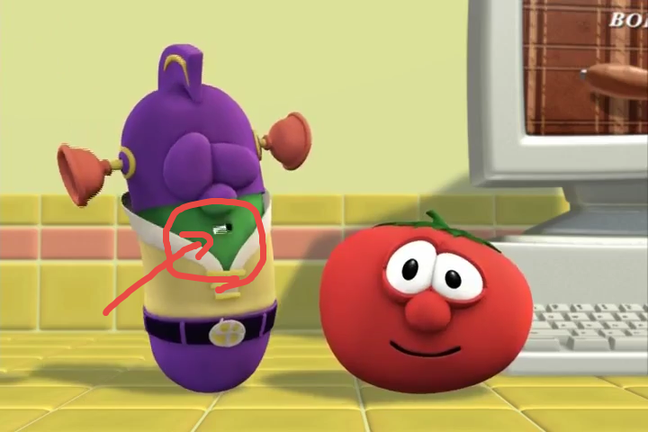

  4. Originally Posted by EditingFan12 View Post
    It's up to you, but my thoughts are if you're going to do something... then do it right
    Some things are definitely "wrong" (and there is no way to argue):
    -5th frame duplicates means animation will stutter. The original animation is 23.976p. Also more useless frames means larger filesizes, more memory, more masking in the other programs
    -Some of these combing artifacts on some frames shouldn't be there . Were they just handbrake errors ? Sometimes there are problems with the original DVD's, you'd have to examine the original to check
    [Attachment 63895 - Click to enlarge]
    Other things are subjective or personal taste. eg. You can customize the animation to however you want; the original animation had a screen glow that I didn't put in (it's pretty easy to composite in)
    Personally I wouldn't use handbrake. If you were going to , you'd have to use "detelecine" in HB (which is equivalent to IVTC), and I would use higher quality for intermediate. I would try to conserve as most quality at each step , until the final distribution format. The clips you provided were encoded at crf23, which are quite lossy for intermediates. I would rip the original clips as mpeg2 and IVTC them in avisynth or vapoursynth and encode as intermediates. Some people would use lossless intermediate workflows, but you need lots of disk space. Some people chose something in between, just higher quality. You choose whatever tradeoffs you want to make, or what works for you

    I don't know of any specific tutorials that cover this exact scenario, but the basic concepts will be the same in any programs - "Rotoscoping" (animated masks) , compositing. For the distortions you can use corner pin and any kind of warping effect.
    I used After Effects, it's just something I'm familiar with. You can do this in free tools like blender, natron. Some of the composting portions can be done in free NLE's; but many of the free NLE's only have rudimentary masking capabilities. e.g. in shotcut , you currently can't use something like a pen tool and create curved lines or bezier masks. I doubt kdenlive can either. I think it's on the roadmaps for future versions
    If you're new to AE or compositing, I don't expect you to understand all this right away, but maybe it will help you in terms of keywords to read up and find/watch tutorials:
    I used the rotobrush to roughly isolate the screen. Often you have to clean up a bit on a few frames (it's not as precise as manual rotowork) . It tracks the mask, so it saves time overall . Corner pin for the insert layer (kdenlive and shotcut have corner pin). Warp set to buldge and you can keyframe horizontal and vertical parameters. I adjust the insert layer opacity to 50% so I can see the "original" underneath to use as a rough guide. The brightness is just animating curves effect, but it can be done in many different ways
