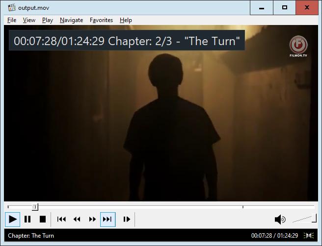

	With ffmpeg: https://ikyle.me/blog/2020/add-mp4-chapters-ffmpeg
 I tried it with their sample chapter file and a random video (output to .MOV). It worked:
 [Attachment 63851 - Click to enlarge]Last edited by jagabo; 16th Mar 2022 at 20:11. Reason: added image
