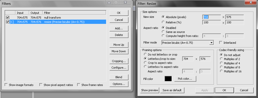

    Anyways, you can manually swap the parity during capture in VirtualDub by enabling filters.
    Use "Null transform" to crop a single line at the top, followed by the resize filter without any resizing but with "Letterbox/crop to size" set to the original capture height (such as 480 or 576). This adds a single black line at the bottom. Voilą, parity swapped.
    [Attachment 65037 - Click to enlarge]

    Anyways, you can manually swap the parity during capture in VirtualDub by enabling filters. Use "Null transform" to crop a single line at the top, followed by the resize filter without any resizing but with "Letterbox/crop to size" set to the original capture height (such as 480 or 576). This adds a single black line at the bottom. Voilą, parity swapped.
    I would rather remove a line on the bottom, in the head switching area, than on the top. Can I do that?
    After I do this and save, the file still seems to have wrong metadata, or is it my ancient (version 14) Vegas that cannot read it properly? In fact, out of two data points - aspect ratio and field order - Vegas 13 reads one correctly, Vegas 14 reads both incorrectly. And, to add injury to the insult, it does not show the video, it shows just black screen. Ok, this is my problem, I apologize to hijack the thread. We already have gone through this with DB83. After all, Purple2112 wants MPEG-2 or AVC, not DVCPRO
    I tried that out of curiosity, but there is no means of changing the default behavior that adds a single black line always at the bottom first. So the answer is no. This is pretty much a cumbersome hack anyways.

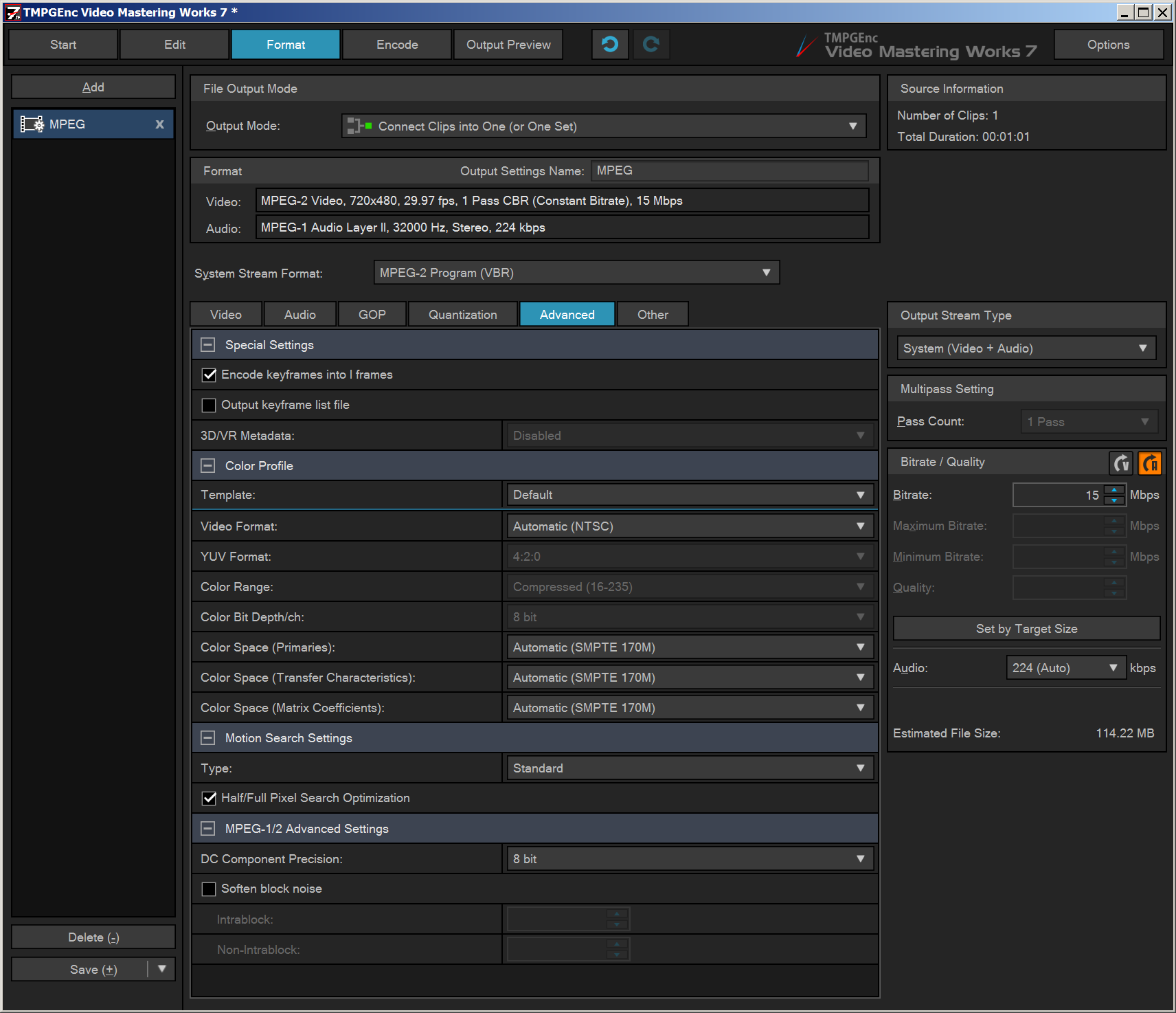

    Since you are not going to upload it on YouTube, you can keep it interlaced, the Oppo has one of the best deinterlacers.
    I'm not using the Oppo as a network player, using it as a bd/media file player connected directly to my TV.
    I'm not changing the Color Bit Depth, DC Component Precision is not the same thing as Color bit Depth. See Settings
    [Attachment 65151 - Click to enlarge]
    I'll probably end up encoding all the videos to H.264 instead of Mpeg2 anyway so I might not ever even use that setting.
    Yes, I will be keeping the encoded videos as interlaced.

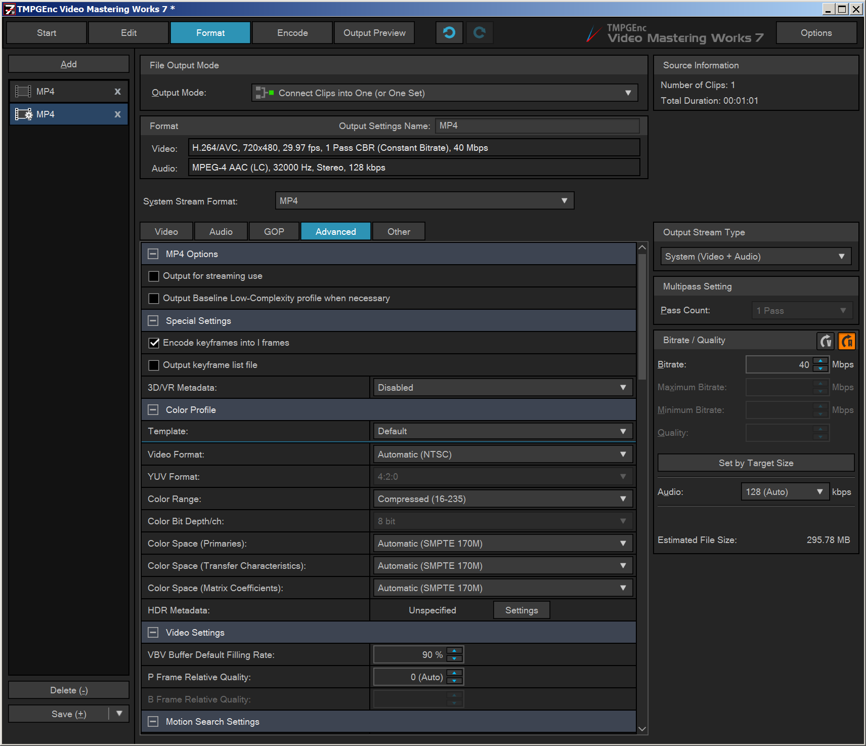

  9. Okay Guys, I need to start winding this thread down. At this point, I would like to know about the H.264 Advanced Settings and then I'll try and take it from there. I'll post one Advanced Settings photo at a time. 1st, I need to know if I can uncheck the (Encode Keyframes into I Frames) AFAIK this is only used if there are chapters or cuts made in the video. 2nd, can I go ahead and set the (P Frame Relative Quality) to 2X being the max. I going to try and use only I Frames in the GOP, but would still like to know about all the Advanced Settings. This is what the SW Help Files states about the (P Frame Relative Quality)
    [Attachment 65152 - Click to enlarge]
    Advanced Settings Photo
    [Attachment 65153 - Click to enlarge]

    Unfortunately, there is no actual CRF value setting for H.264. Their version is VBR(Constant Quality) with a Quality setting 0-100. According to them if I was to set the Quality to 100 I would then have to set the bitrate to 60Mbps. This is what they told me about CQ and how it relates to CRF.
    [Attachment 65358 - Click to enlarge]

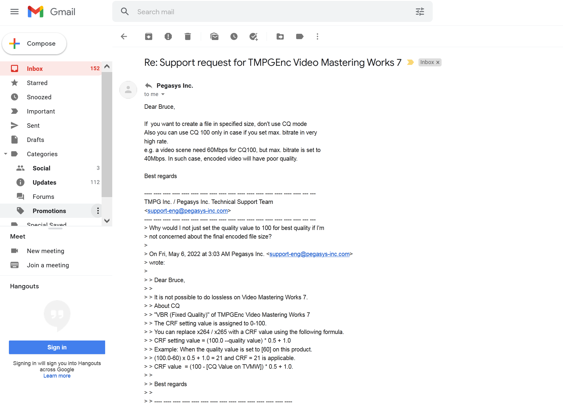

  12. Originally Posted by Purple2112 View Post
    How so? Haven't they given you the formula: CRF = (100 - Q) * 0.5 + 1, so Q = 102 - 2 * CRF
    According to their formula, quality = 100 does not give you lossless encode (CRF==0) as CRF will be 1. I wonder can you enter quality value 102 for lossless encode?
    This is not what the attached email says.

    Yes, in a round about way, that's why I used the word (actual). The setting doesn't go to 102. They are saying if I set the Quality to 60 the CRF value would be 21.
    It says "e.g. a video scene need 60Mbps for CQ100" Keep in mind that they are Japanese so their English is a little broken.
    Nothing is wrong with their English. If your set both quality value and max bitrate, and max bitrate is insufficient for the quality setting you use, the encode will honor the max bitrate value, so quality will suffer. The number they gave is just an example.

    Looking at the tests I did, I get this. Whether version 7 is identical can be tested
    CQ 60/CRF 21
    CQ 62/CRF 20
    CQ 70/CRF 16
    You did not believe their formula?
    Yes, but that's the first time I saw it. I did those comparisons two weeks ago.
    (I added the parenthesis for easier reading) :
    CRF = (100 - Q) * 0.5 + 1, so Q = 102 - (2 * CRF)

  23. Originally Posted by Purple2112 View Post
    Okay, I just encoded a video using CQ @ 60 and ended up with / crf=21.0 / in MediaInfo specs as you stated. So at least now I will know what CQ value corresponds to what CRF value.
    They gave you the formula. Oh, well.
