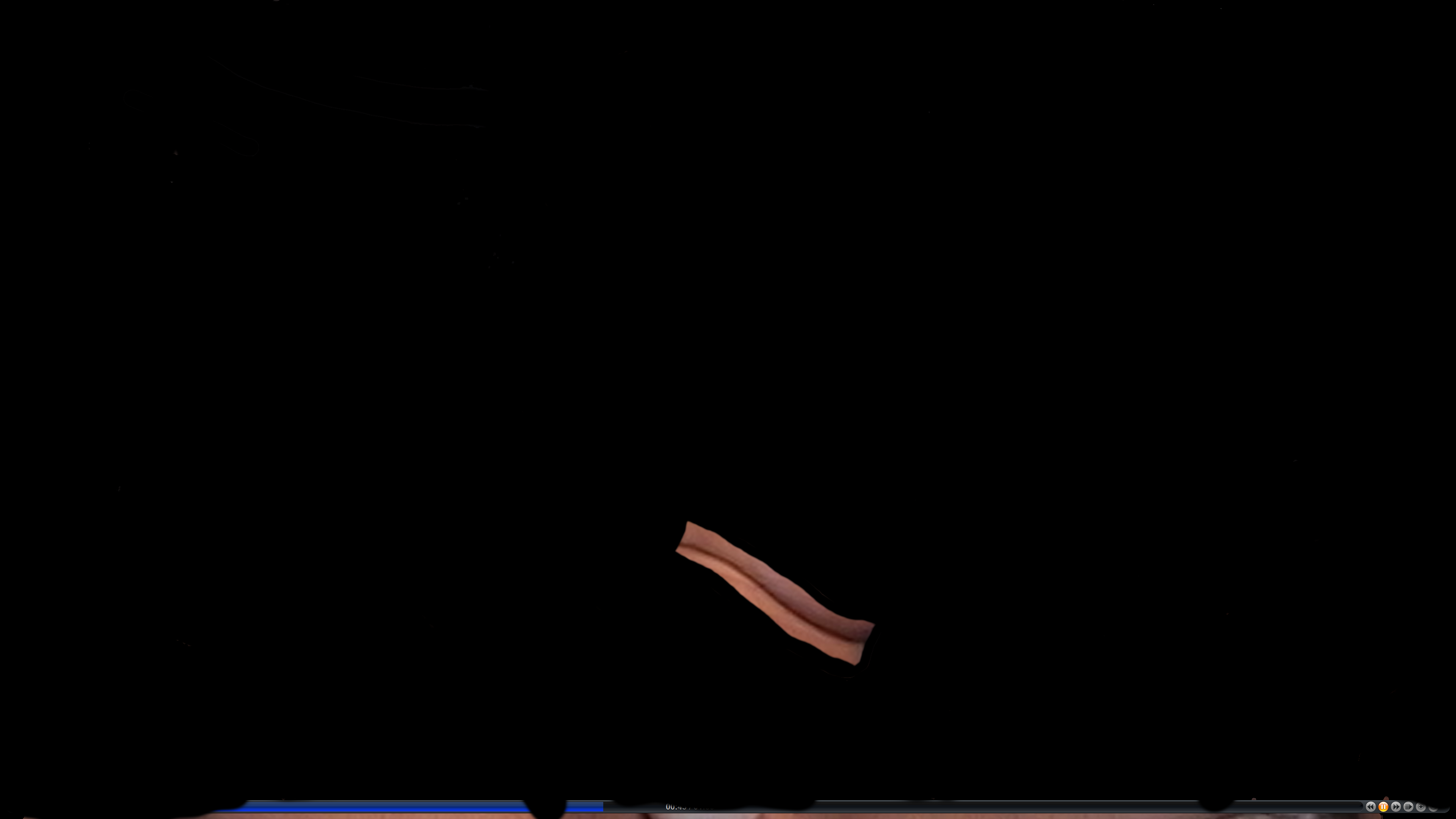

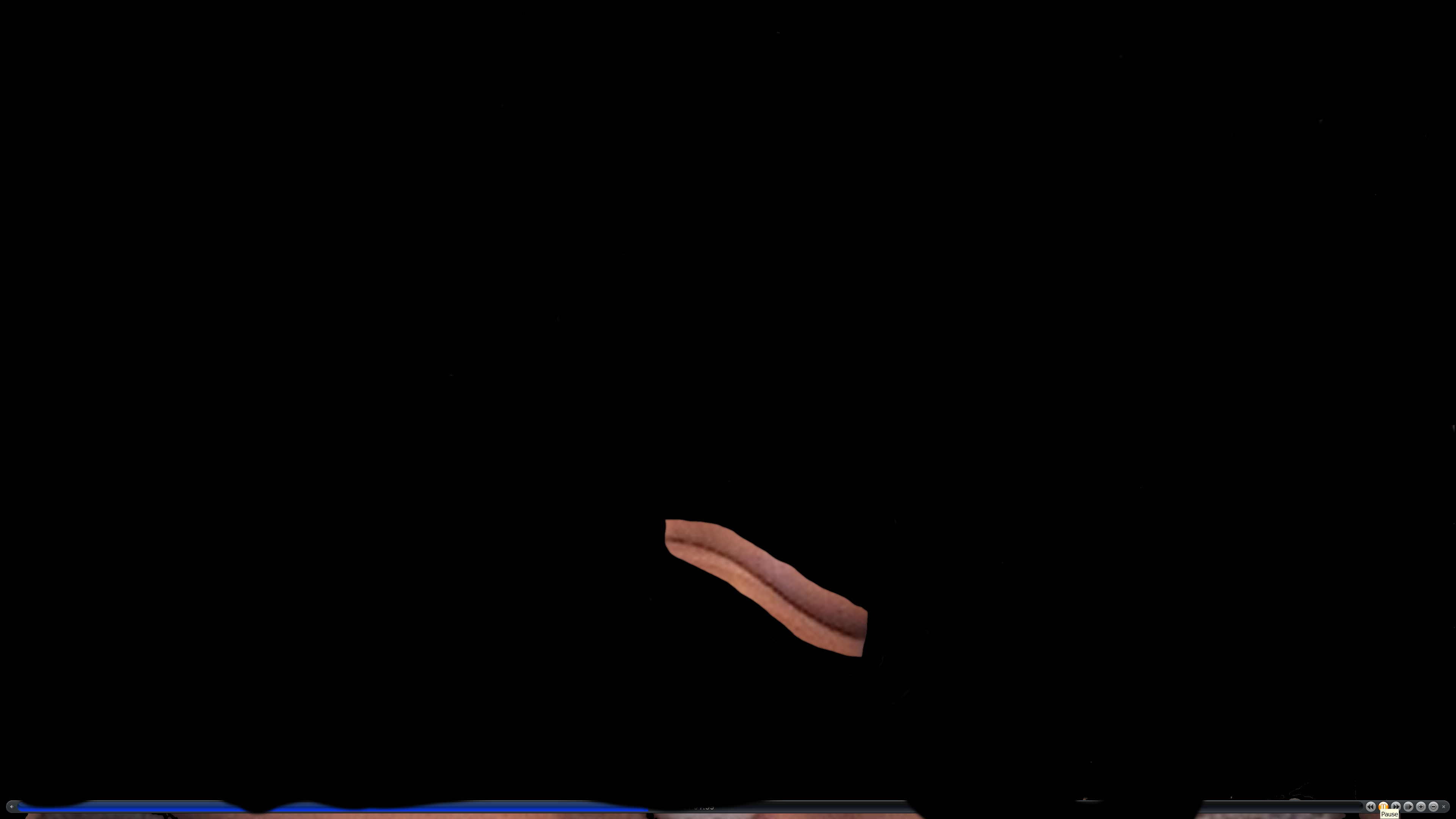

    I understand that the encode will never be an exact match to the source, but what I'm seeing is not just some fuzziness or artifacts. I ended up just taking two screen captures from the exact same point in a video and used the Windows Magnifier that you mentioned to zoom in on it. I know it's not the best way to check for differences, but hopefully you can still get an idea of what I'm talking about. All my videos are of nude female friends and girlfriends so I had to blackout 98% of the captures. What you will be looking at is a crease under a breast. The 1st one was taking from a standard H.264 (constant bitrate) encode. You should notice that the crease is a solid, dark, brown line.
    [Attachment 64782 - Click to enlarge]
    The 2nd capture was taking from a VP9 VBR(Constant Quantization) encode with QP set at 10. (The same thing happens when encoding to VP9 lossless) You should now notice that the line is no longer solid, it looks more like a white and brown striped snake. This is very noticeable when watching the video, it almost looks like a brown and white strobe light.
    [Attachment 64784 - Click to enlarge]
    I don't expect you to know why it's happening, just wanted you to see what I was talking about. The other two problems with the lossless that you might have answers for is that the picture looks stretched. I tried changing it to 640x480 and 720 x540, but when I do that it still doesn't look right and I'm getting a small black bar on top and bottom, instead of just on the sides where they belong. When using the standard H.264 encoding I don't have this problem it just somehow comes out correct, not sure if BD player or TV is auto correcting it, but it plays correctly even though it's 720x480 resolution.
    Lastly, the outline of everyone is covered in little Z's which as far as I know is an interlaced issue. I can notice this in the source file a little if I really look for it, but after encoding it looks really bad. I've been encoding all of them as bottom field first as you mentioned, could the interlaced algorithm with my software be that bad?

    The video was poorly deinterlaced. Either before encoding or during playback.

    This is definitely an interlacing issue. Without before/after samples I can't tell you exactly what.
    But all those problems either occurred before encoding, by incorrect encoding, or are playback problems.

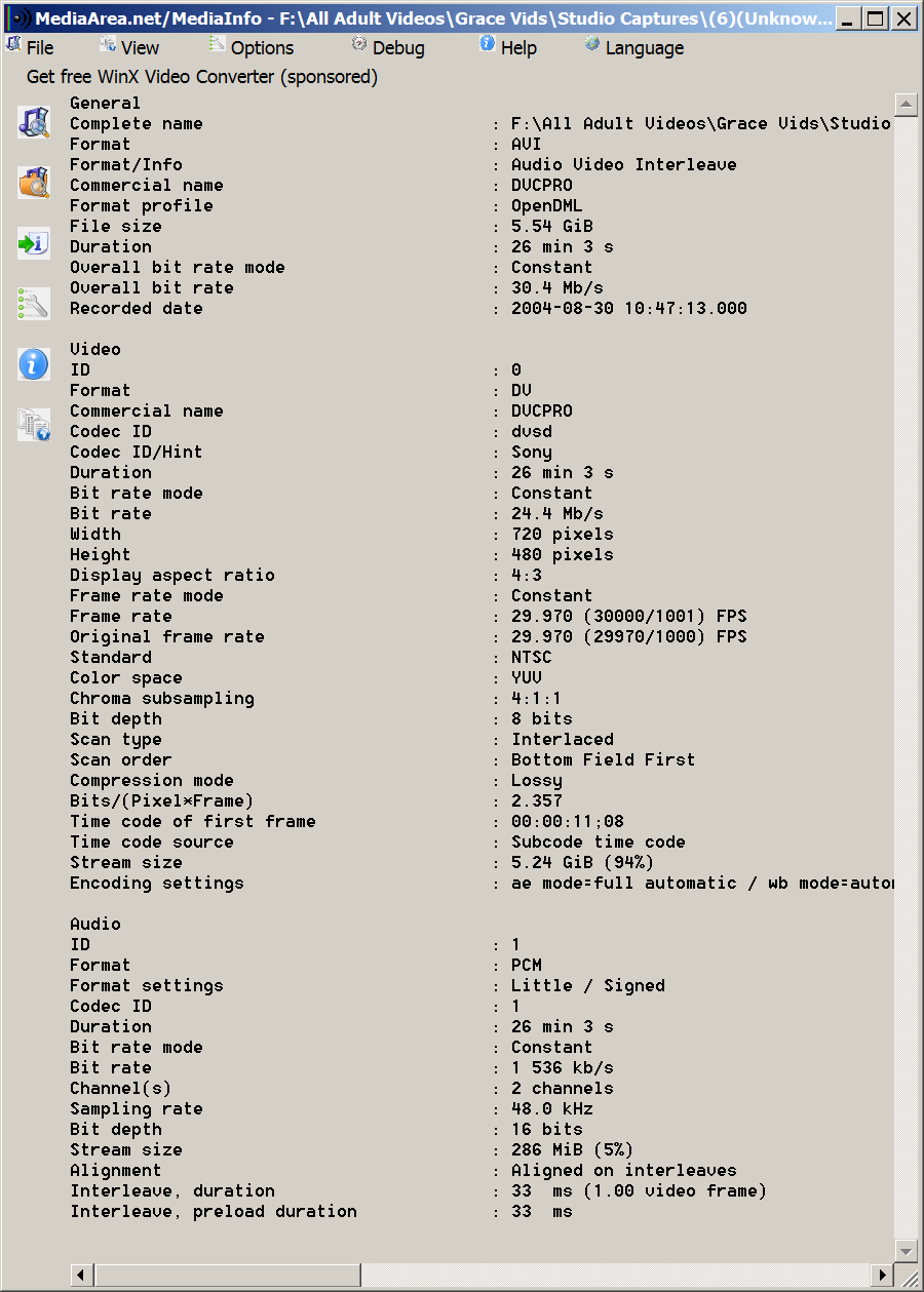

    I need to jump back to one of the first issues that I'm still not positive about, Field Order. As far as I know DV should always be BFF. However, when I used MediaInfo to check the DVD's that I made from all these DV-AVI files back in 2006 it shows them as being TFF. At the time I used Pinnacle software to capture and then Nero software render to DVD using all the default settings. This time I just used https://www.videohelp.com/software/WinDV set to (type-2 AVI) to capture all the source videos. I know this is a long shot, but is it possible that WinDV captured the DV-AVI's as BFF, even though they were actually TFF? I tried using some of the methods mentioned on this forum to test them, but I really can't see any difference. The TFF dvd's aren't jumpy when being played.

    1. Interlaced video straight to mpeg2 = TFF
    2. Interlaced video straight to DV = BFF
    3. Interlaced DV (BFF) back to mpeg2 = BFF

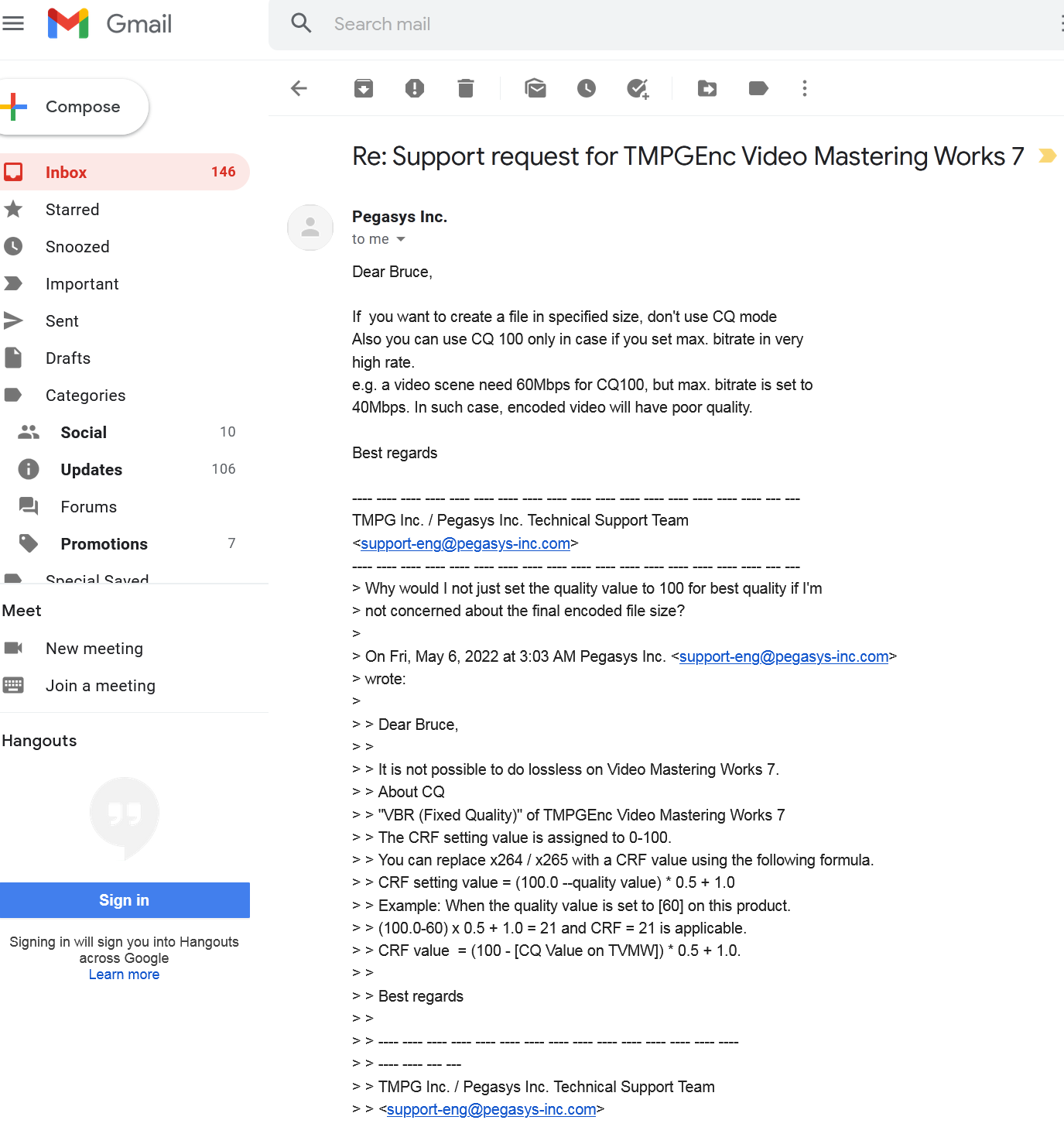

    Have you figured out the whole VBR(Constant Quality) setting yet? When I asked the software developers this is how they explained it.
    [Attachment 64990 - Click to enlarge]
    Although, I can't imagine setting the bitrate to 60Mbps as they are stating.

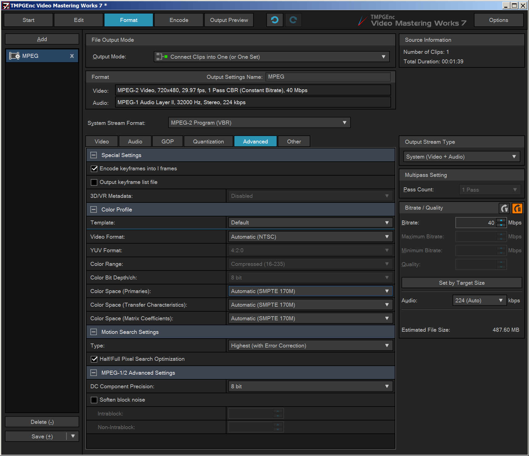

    Here are the Advanced Setting for Mpeg2, pretty simple compared to H.264.
    [Attachment 65007 - Click to enlarge]
    Can I uncheck (Encode Keyframes into I Frames) since I have no chapters and aren't doing any cutting? I should be able to set the (DC Component Precision) to 10 since I am using a high bitrate and not concerned about encoding time.......correct? Found some info here:http://https://forum.videohelp.com/threads/225262-TMPGEnc-s-DC-component-precision-setting

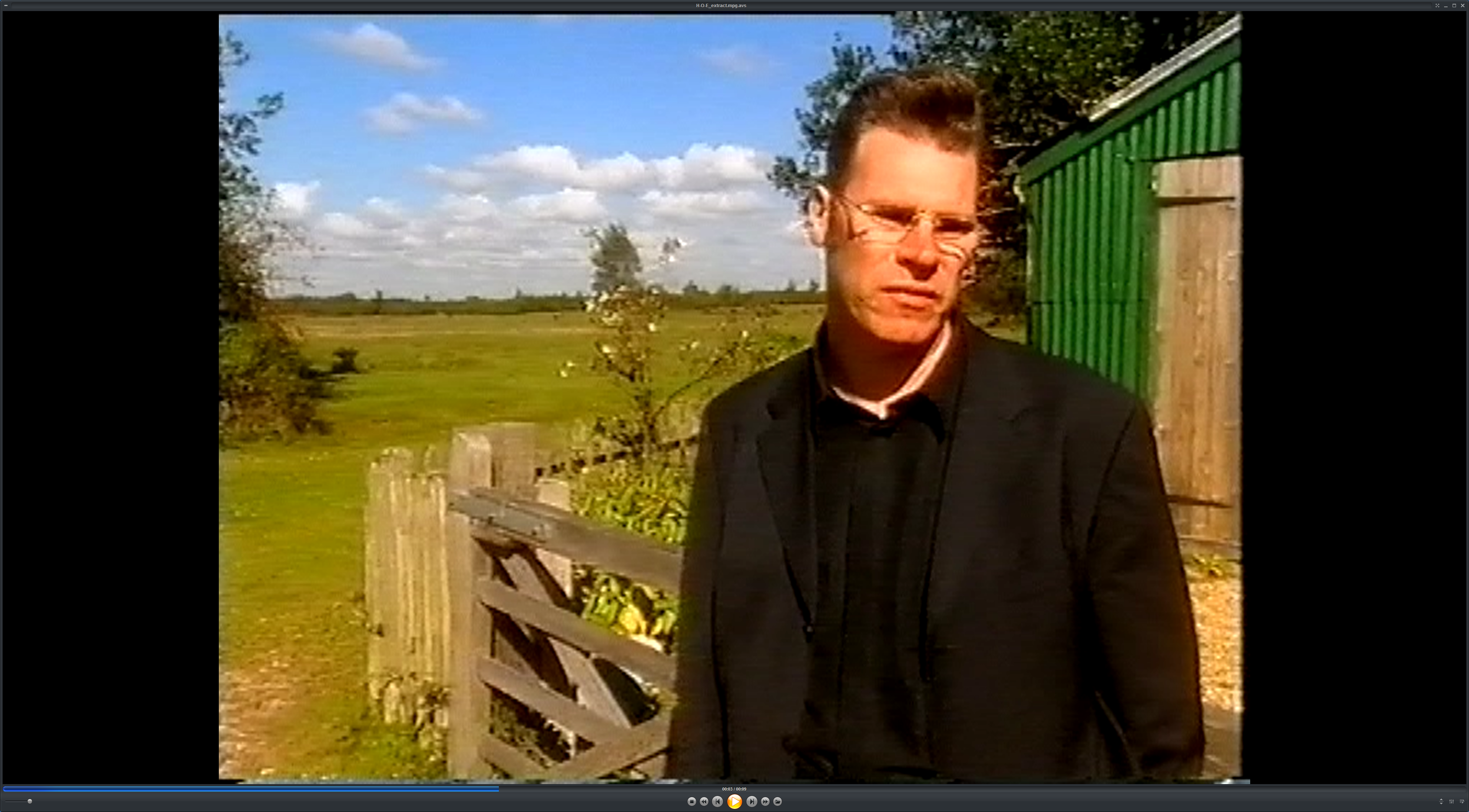

    I had no problem playing this with Zoomplayer https://www.inmatrix.com/files/zoomplayer_download.shtml
    [Attachment 65008 - Click to enlarge]
    • native DV is BFF
    • Video digitized from analog into DV is often TFF, which throws NLEs off because they expect BFF, but this is not your case.
    • MPEG-2 is TFF, and good software makes sure to convert DV/BFF to MPEG-2/TFF behind the scenes.

    Ok. I never stated that my sample was straight-to-DV. I was merely attempting to use the s/w to create a mpeg2 from a DV source (with mine from VHS(tv recording) hence the less that perfect result) but with a selection of random bitrates just to show what the s/w can do. And all this with just a few minutes of using it. Others with more knowledge of mpeg2 and encoder settings could probably get more out that even that.
    My bad, I though that was footage that you shot with a DV video camera.
    Yes. You have already stated that you can not upload actual examples. But I still think you are chasing your own tail here. Bitrate is not everything. DV is a legacy format which had its champions 20 years ago. Mpeg2 is only still 'suffered' due to dvd. Even mpeg2 at the same bitrate (or higher) as DV will not duplicate what you see on the DV (whatever the source)
    Modern codecs such as AVC and HEVC will give you better results. And at a fraction of the bitrate. Yet there are other factors such as noise reduction which we can not even comment on simply because we can not see any original footage.
    Yes, I know, that's why I'm willing to try encoding to H.264 as well. Yes, I've been experimenting with different settings on my own in both Mpeg2 & H.264 encodings. Unfortunately, there are some settings that I can't find any info for on the internet. Actually, H.264 has a sh_tload of advanced settings that I still need to find out exactly what they do and the s/w developers for this s/w are not much help. Yes, I know bitrate is not everything, that's why I've been trying other settings that members on this forum have suggested. For instance, (Jagabo) suggested doing away with B and P frames and using only I frames. I also found that in the Mpeg2 advanced settings that I can change the (DC Component Precision) from 8bit to 10 which helps to improve the quality. (changing the above two settings requires using a much higher bitrate) I know I'm limited with what I can do with DV from back in 2004, but it's tweaks like these that I'm trying to learn about.
    As for samples, I've searched the internet for sample DV, 720x480, 29.9 frame rate and at least 24Mbps, but can't find any. I would love to have a DV sample that I can try different settings with and then post the results for all to see. Here are my actual DV-AVI specs, if you happen to find a matching sample let me know.
