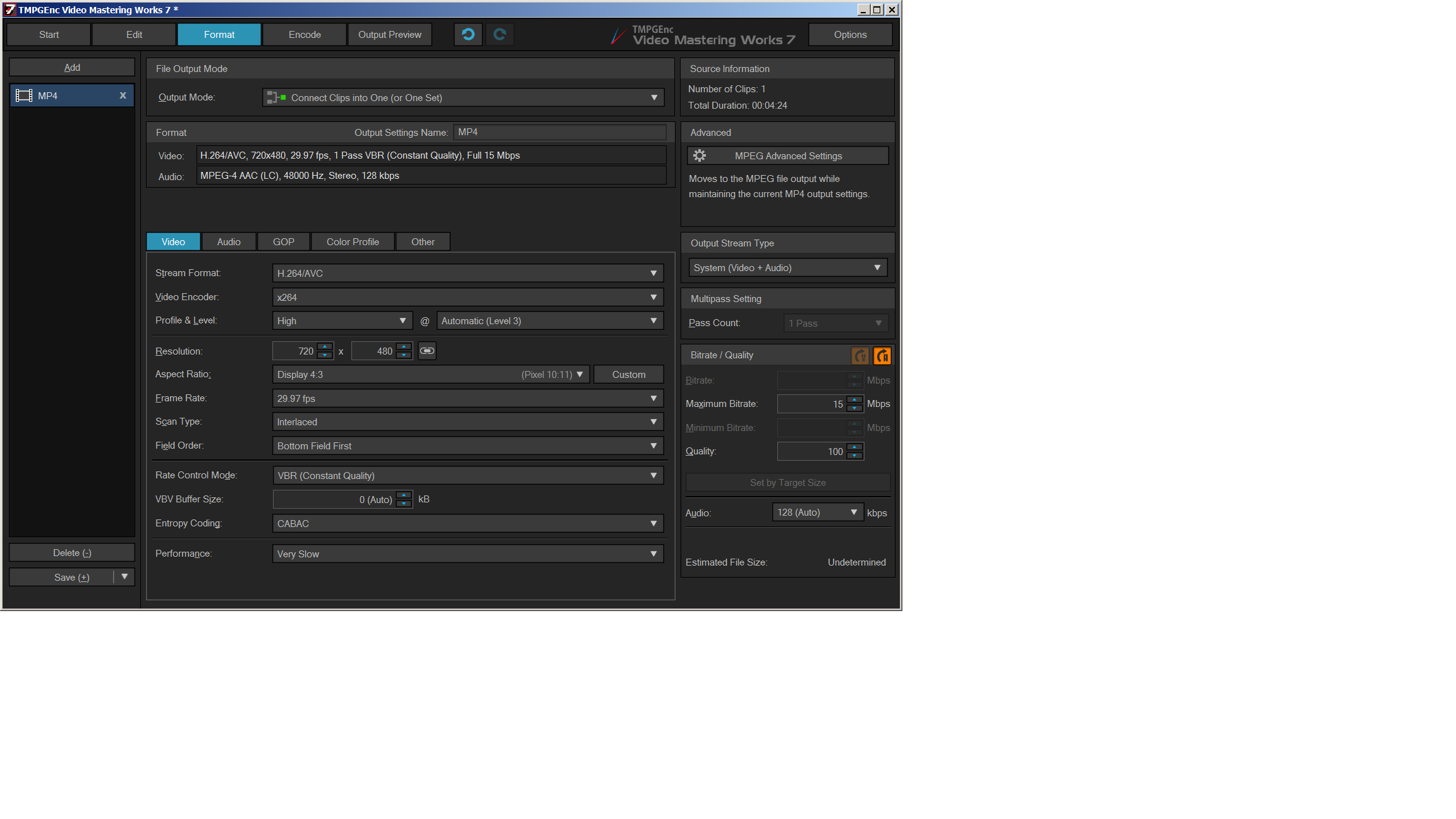

I'm encoding to File not DVD. With the Master Works 7 https://tmpgenc.pegasys-inc.com/en/product/tvmw7.html I can use a 15,000 bitrate.

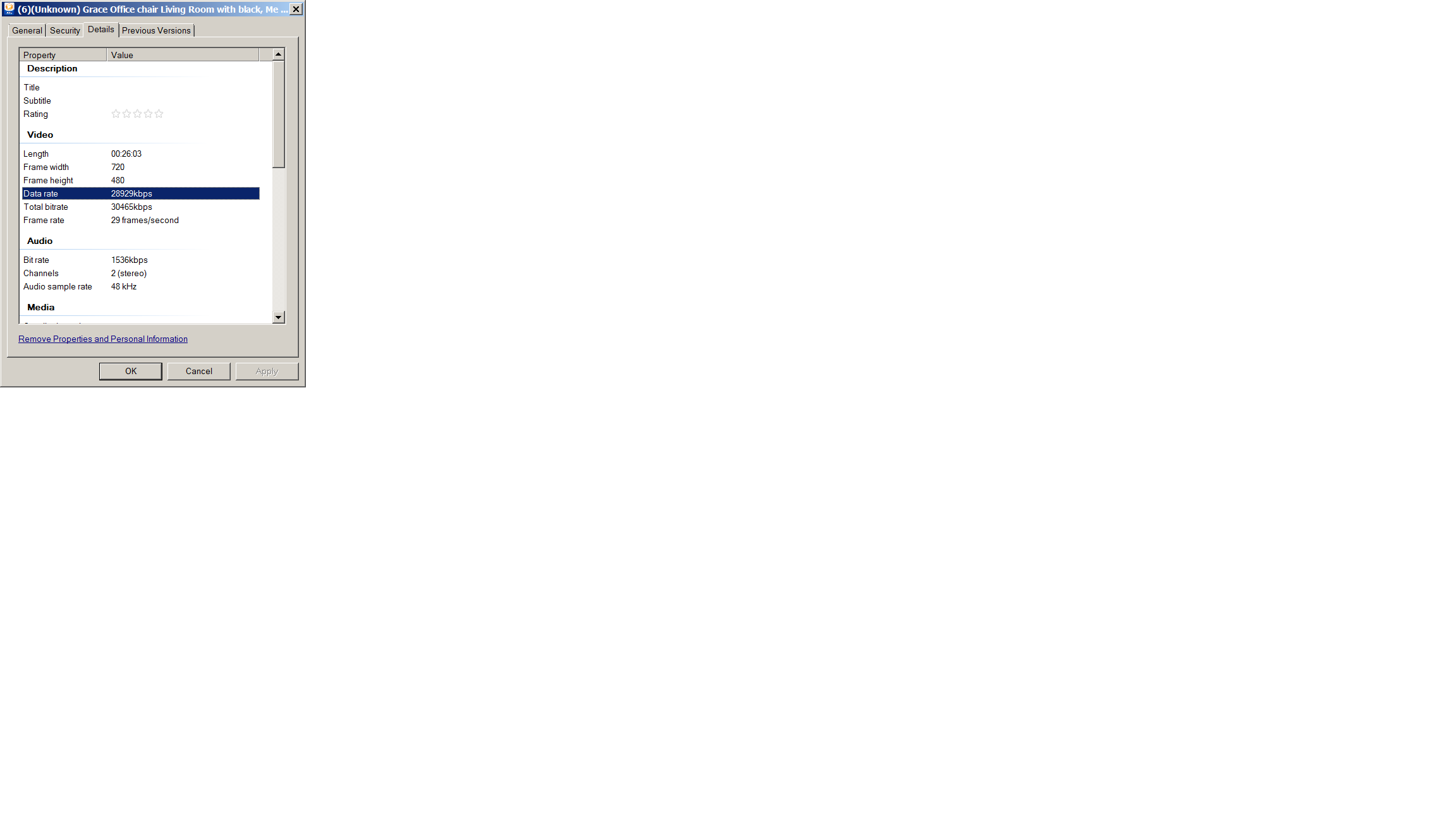

Actually, my AVI's are at almost 29 Mbps
[Attachment 63924 - Click to enlarge]

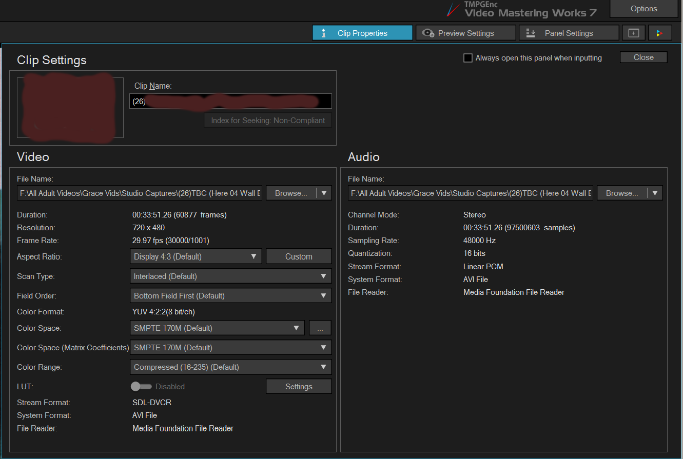

Yeah, my DV-AVI videos are 720 x 480 so that would be a downgrade. Master Works 7 is keeping the correct field order, bottom-first when encoding to mapeg2. -

I tried H264 and Mpeg2 both at 15Mbps. The Mpeg2 wasn't too far off from the original AVI quality with a finished file size of 8.6GB. The H264 with a finished file size of just under 1GB looked like any crappy web video that you would find on a amateur porn site. It just didn't have the same sharpness/detail that the mpeg2 was able to retain.
You did something wrong. If they were both at 15 Mb/s they would have been about the same size. Your h264 video has only 1/8 the bitrate of the mpeg2 video -- it's no surprise the h264 video looks bad. If you don't have another h.264 encoder upload your source and I'll convert it for you. I guarantee the quality will be better than your MPEG2 encoding.

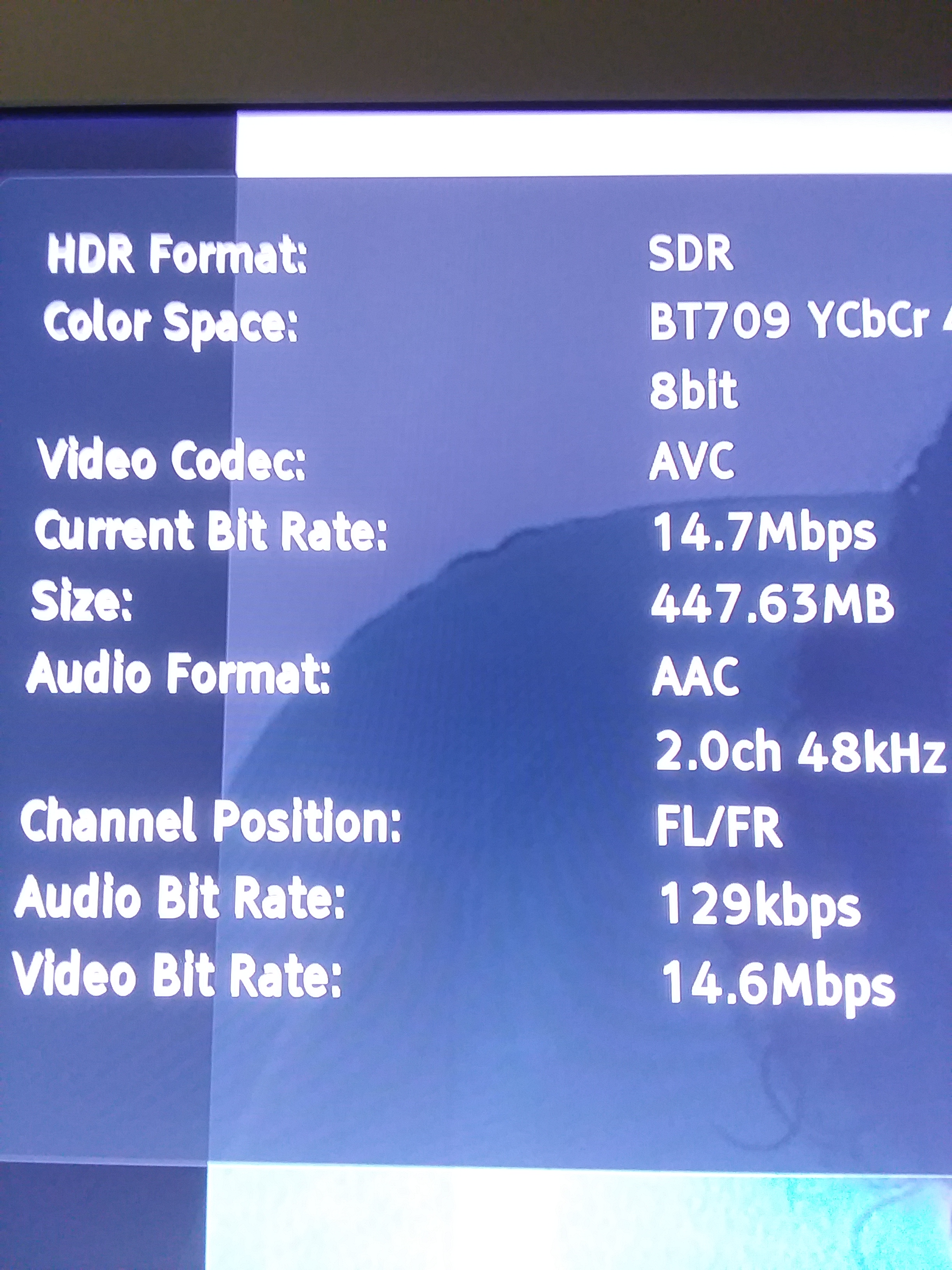

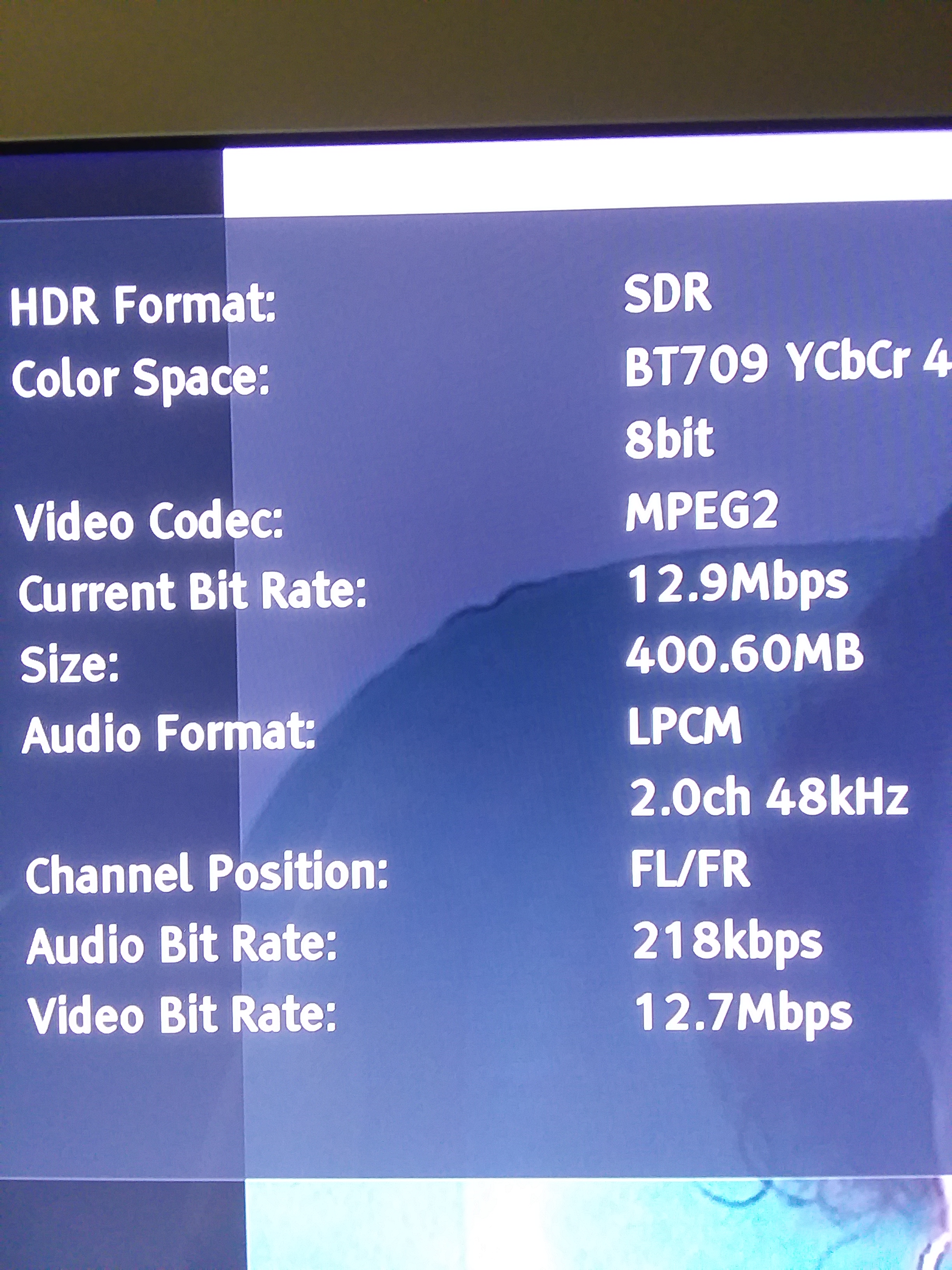

My bad, I must have clicked on the wrong H.264 file when doing a size comparison. They are both really close in size, in fact the H.264 is slightly larger. I'm not sure what you mean by my H.264 has only 1/8 the bitrate of the mpeg2. I just encoded two of the same video, one as H.264 and the other mpeg2. I set both to VBR(Constant Quality) @ 15Mbps Max and (Quality) to 100, see settings.
[Attachment 63999 - Click to enlarge]
[Attachment 64000 - Click to enlarge]
When playing them and checking the info it shows the mpeg2 using about 12 1/2 Mbps video bitrate and the H.264 using about 14 1/2. (this was with a video with very little movement)

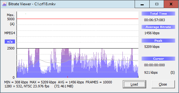

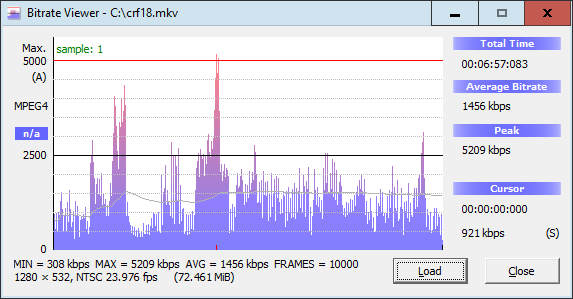

You initially reported you encoded a video at 15 Mb/s and that the MPEG 2 file was about 8 GB and the h.264 file was about 1 GB. It they were both encoded at the same bitrate they would both be the same size. If the h264 video was 1/8 the size of the MPEG 2 video then the h.264 video has 1/8 the bitrate of the MPEG 2 video. You've cleared that up now by indicating you were looking at the wrong file.
That doesn't mean both videos were encoded at 15 Mb/s -- only that the max bitrate used anywhere in the video was limited to 15 Mb/s. For example, here's a bitrate graph of a short video:
[Attachment 64014 - Click to enlarge]
The average bitrate of the video is 1456 Kbps. But many parts have more or less than the average. The max bitrate of the video is 5209 Kbps. But it's the average that determines the file size, not the max. What you are doing by setting the max bitrate is limiting the peaks. For example, if I had set the max bitrate to 2500 Kbps when I encoded that video it would have looked something like:
[Attachment 64015 - Click to enlarge]
(Note, I edited the first image to produce the second image. I just erasing the peaks. I didn't change the stats at the bottom so they aren't valid.) The video at all those truncated peaks would be of lower quality than they would have been without the limit. And since the peaks are truncated the average bitrate would have been a little lower. -

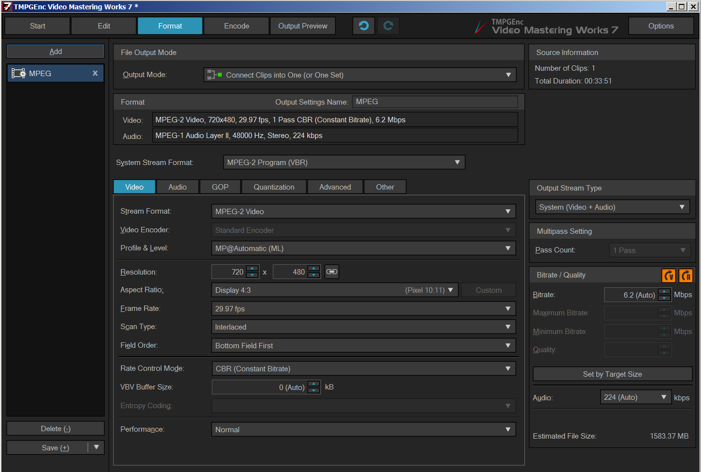

Yes, the AVI Clip Properties shows Bottom-field-first and then the software just carries over the same field order unless I change it.
[Attachment 64016 - Click to enlarge]
[Attachment 64017 - Click to enlarge] -

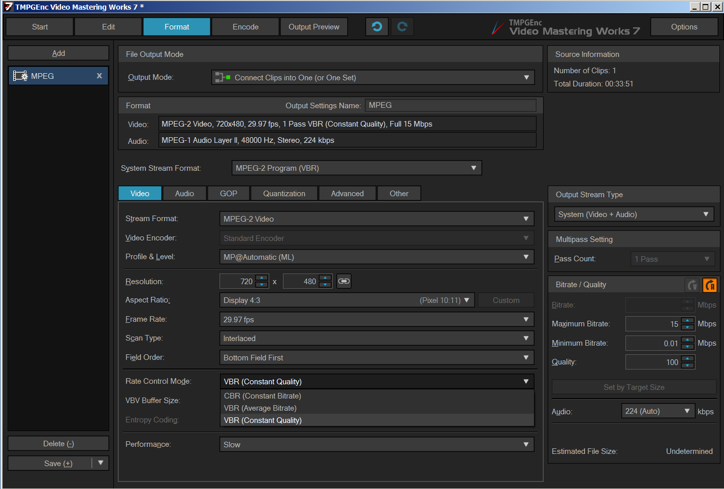

Okay, great. My first question is about the (Rate Control Mode) Master Works 7 has an option that I haven't seen in other software......VBR (Constant Quality). Which one should give me better results the CBR(Constant Bitrate) @ 15Mbps Max or VBR(Constant Quality) @ 15Mbps Max and Quality @100
[Attachment 64019 - Click to enlarge]
Usually, the higher the bitrate, the better the picture, but what exactly does setting the Quality setting to 100 do when using the VBR(Constant Quality)? How does it differ from just using the Constant bitrate @ 15 Mbps. The Pegasy Help files are pretty much useless for descriptions of what each setting actually does.
