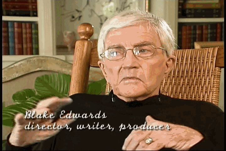

While I have attempted to do searches via DDG and here, since I do not know what I do not know, i can only describe what i see as "lines."
Nothing comes up for "lines in avidemux video."
please see the pic of my Making of The Pink Panther vid showing an elderly Blake Edwards:
[Attachment 63775 - Click to enlarge]
{see lines on hands?}
the original .mkv as well as DVD do not show said lines with movement.
i am using the DEFAULT settings in Avidemux 2.8.0 of
lavcodec: DXVA2
Vid Output: Mpeg4 AVC (x264)
Audio Out: Copy
Out Format: MKV muxer
i think *I* screwed something up while using v2.7.6 [beyond the Pixel Aspect Ratio manually set to NTSC 16:9, which is NOT set in v2.8.0 i am still clueless]
which is where this "lines" problem started that 2.8.0 somehow retains(even though they are in separate install dir)
also, i seem to have a vague memory of seeing in Lavcodec: RGB(or something similar)
but as i am VERY ignorant of the technical terms,
these might as well be Klingon for as much as i understand
Thank You for the time taken to reply,...

Probably during normal playback in a media player, it's being deinterlaced in one manner or another,
In Avidemux it's not, so you're seeing an interlaced frame, two moments in time, in one image.
Post a short video sample, showing some steady movement, to this thread for confirmation -

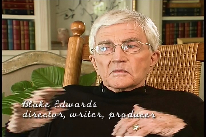

You have interlaced video. Each frame contains two half-pictures:
[Attachment 63778 - Click to enlarge]
The two picture are meant to be seen individually and sequentially.
Encode interlaced or deinterlace before encoding progressive. -
