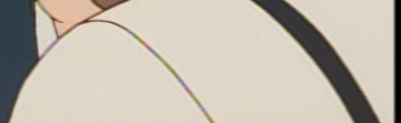

    I'm new to Avisynth and I need your help. Here, on some cartoons, there are analog white lines (I don't know if I'm using the right term) that flicker that appear.
    I would have liked to know if it is possible to make them disappear or failing that, to attenuate them?
    I am attaching pictures.
    Thank you.

  2. Those are analog oversharpening halos. Try dehalo_alpha(rx=3.0, ry=1.0). Adjust rx and ry to suit the size of the halos. It can be very damaging to the picture though. So it's best to avoid them in the first place.
    Aug 2017
    Are you referring to the rainbowing in the thin diagonal line? That's crosstalk between the chroma and the luma. There are a few filters for AVISynth to mitigate the effect like Bifrost.

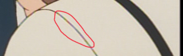

  4. Thank you for your answers !
    I'm referring to the kind of white spots that appear on the black line that I circled in red (see image below).
    They tend to move or I don't know how to describe it every frame, hence why I attached two images in the first post.
    [Attachment 63774 - Click to enlarge]
  5. Those are rainbow artifacts. They are the result of incomplete separation of the luma from the chroma of a composite signal. There are many de-rainbow filters for AviSynth.
    http://avisynth.nl/index.php/External_filters#Rainbow_.26_Dot_Crawl_Removal
    They generally involve blurring and/or desaturating colors near sharp edges.
