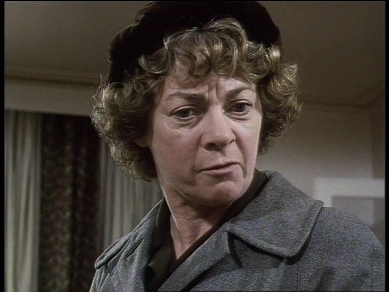

  5. SM1872, Here's the sample you PM'd me processed with AviSynth:
    [Attachment 63757 - Click to enlarge]
    The basic script I used was:
    Mpeg2Source("o2.d2v", Info=3)
    SMDegrain(tr=2, thSAD=1000, refinemotion=true, contrasharp=false, PreFilter=4, mode=1, truemotion=true, plane=4, chroma=false)
    KNLMeansCL(d=0, a=2, h=2.0)
    One problem with MPEG 2 sources is that some of the grain gets "locked in" from the compression, ie, some of the grain doesn't change much from frame to frame (whereas film grain changes with every frame). So temporal noise reducers can't get rid of all of it. So I used a purely spacial noise reducer (KNLMeansCL(d=0)) after the motion compensated temporal noise reduction (SMDegrain()). Attached is a filtered sample that contains your second image above, frame 398 in the full sample, frame 48 in the short clip here.
    You can use more or less noise reduction by adjusting the parameters. Shots with more motion can suffer from heavy temporal noise reduction so you might need to lower the settings it a bit.

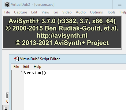

  9. Start by installing the 64 bit version of AviSynth+ AviSynthPlus AviSynth Plus. Install the 64 bit version of VirtualDub2 for editing and viewing the results of your AVS scripts. You can also encode with VirtualDub2.
    Start VirtualDub2 turn on the script editor (Tools -> Script Editor). In the Script Editor window type:
    Version()
    With the Script Editor window active press F5. Since the script hasn't been saved yet it will ask you where you want to save the script. You can pick somewhere convenient like the Desktop, or some other folder of your choosing. Be sure to add the extension .AVS. Once you have saved the script you will see the result in VirtualDub's main window:
    [Attachment 63764 - Click to enlarge]
    Make sure it indicates the "x86_64", the 64 bit version. You have now verified that AviSynth and VirtualDub2 are installed correctly.

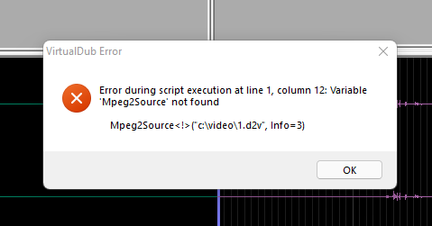

    I've tried to load the little script in post #5. Made the d2v in DGIndex using the MPG file, changed the target directories
    [Attachment 63857 - Click to enlarge]
    [Attachment 63856 - Click to enlarge]
    Was hoping it'd be simple enough by allowing me to do that, but no! I've really been dragging my heels as it looks so user-unfriendly.
    I installed AviSynth+ in my Videos directory under my own personal profile. Wondering if that would cause any conflicts, i.e. requiring admin privileges and so on?
  11. Use File -> Open Video File, not File -> Run Script (the latter is for VirtualDub's own scripting language which has nothing to do with AviSynth).
    The little script in post #5 requires that you download and install several other AviSynth filters. You should follow the instructions in post #9 first. Once you have that working we can go on to the next step.
