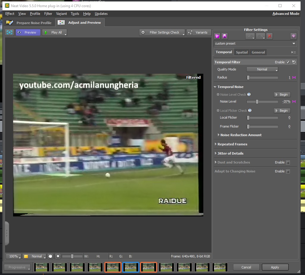

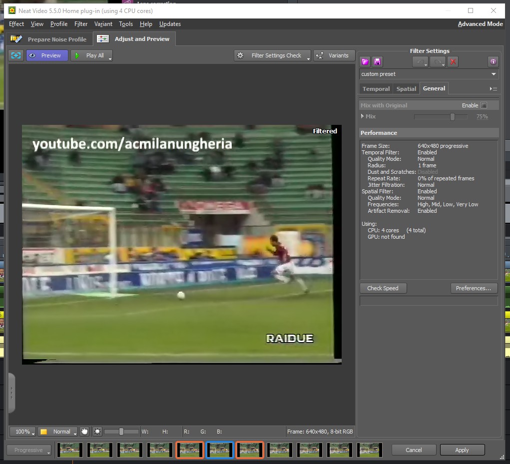

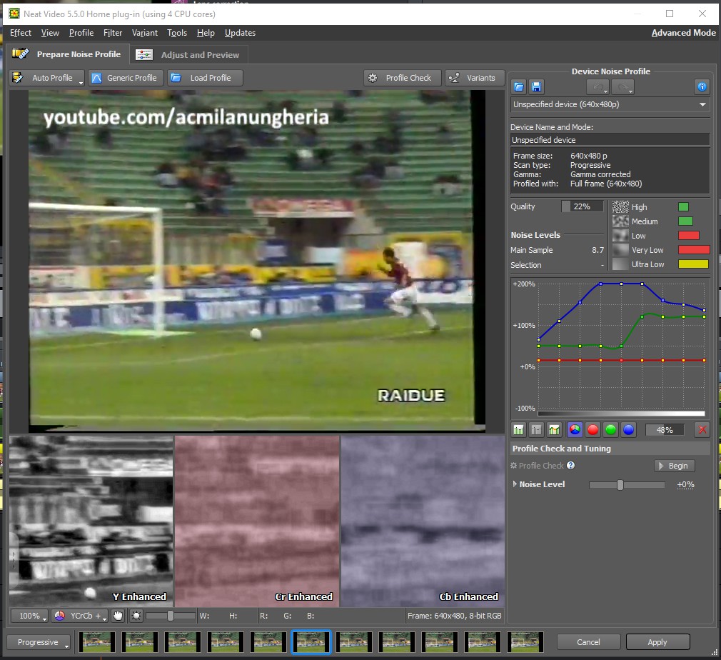

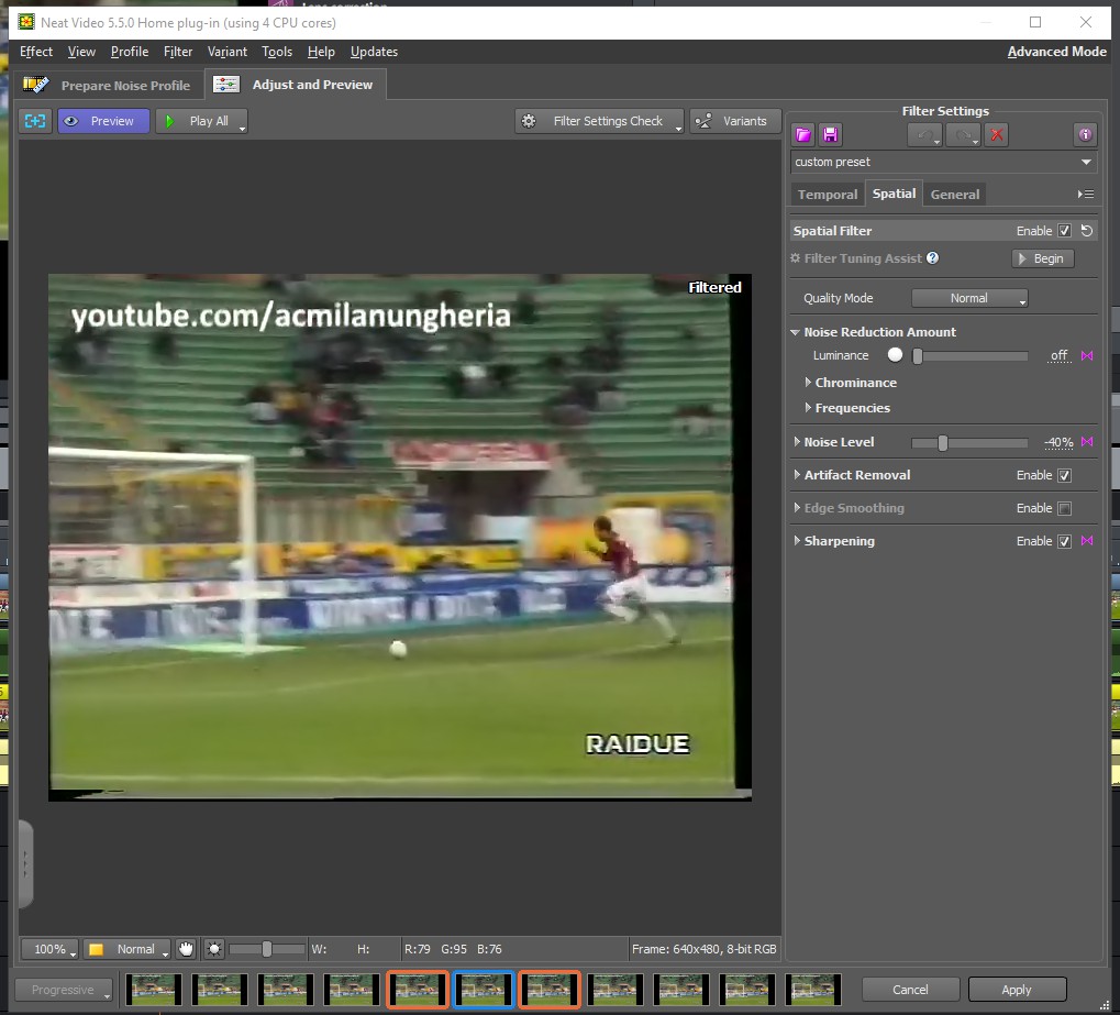

    Quick-fire "Neat Video" on the right:
    Soccer Neat video on right.mp4
    Mar 2022
    Greece
    Thanks. Yes, the improvement is visible although the source video quality doesn't help at all.
    May 2005
    Australia-PAL Land
    It depends a lot on what area you select for Neat Video to analyse; a uniform a colour/texture area is best. I chose the grass at the bottom of the video. In this case, I tweaked one of the noise sliders (can't remember which one!) but the result is instant so you can experiment with all the controls easily.
