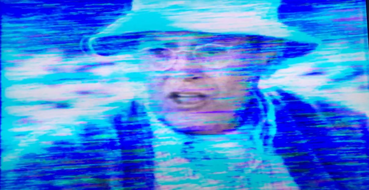

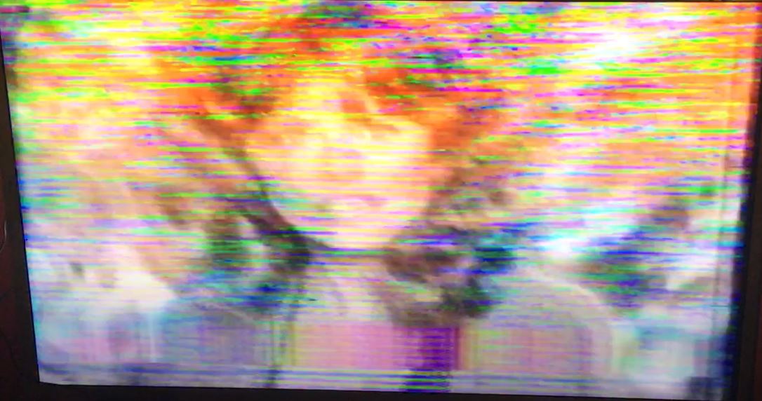

  12. I think the color is really stuck but it seems it also PAL color compatible. Sometimes short color is visible on PAL discs.
    [Attachment 63724 - Click to enlarge]
    https://www.youtube.com/watch?v=9UcVVYQZnnY
