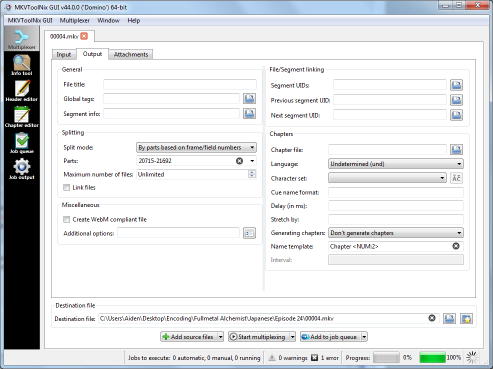

    I just said I know how to do DVD's and asked about .m2ts, not .VOB. DGIndex wont even open or recognize .m2ts files for me.
  12. Sorry, I misread (DGIndex does work for m2ts files here assuming the contain MPEG-2 Video)
    For most formats you can also use MKVToolnix GUI, open the file, tell mkvtoolnix to chunk the clip in 30 seconds chunks, then upload one of those chunks.
  13. Originally Posted by Selur View Post
    All DGIndex says to me is "no video header sequence found" no matter what .m2ts file I try to open.
    I can get the file into mkvtoolnix, but dont see how to split it yet.
    EDIT: I figured it out in mkvtoolnix. Thanks!
    I will upload soon.
  14. mkvmerge is only key frame accurate, also it only takes times not frames as input.
    https://mkvtoolnix.download/doc/mkvmerge.html#mkvmerge.description.split
    DGIndex isn't frame accurate either. To cut mpeg based stuff frame accurate you usually need to reencode (ignoring special cases like cutting on key frames).

  16. Originally Posted by Selur View Post
    mkvmerge took the frame numbers as inputs and came out just fine. Was frame accurate enough for me, so it is capable of frame numbers as inputs. I cant say if it was 100% frame perfect without examining it, but it started and ended exactly where I wanted it to.
    [Attachment 63688 - Click to enlarge]
