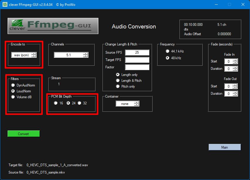

[QUOTE=insurancepi;2650450]It worked, but it's not loud at all /QUOTE]
Forget the commandline an use a GUI
Here is an example:
[Attachment 63815 - Click to enlarge]
Download here: https://files.videohelp.com/u/292773/clever_ffmpeg_gui_newest_beta.7z -
@ProWo: out of curiousity: Since I see no selection for it in the GUI, does it use little or big endian pcm output? (probably little endian since it's aimed for Windows only users)
