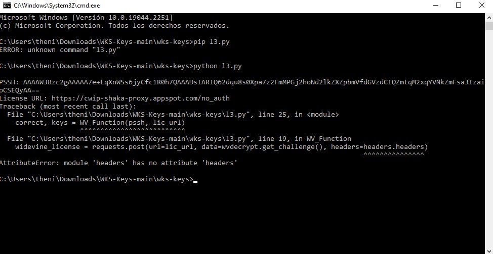

    [Attachment 67971 - Click to enlarge]

    Originally Posted by andrez4zv View Post
    Oh my God!!!!! I'm getting it...
    I called that 'a nearly falling off a chair' moment! Welcome to the club.
    Cedric gives very good advice.
    But it looks like you are testing against the bitmovin site and they don't use headers as I recall. The problem is l3.py is set up to read headers in all cases.
    So, for many sites, simply provide a simple headers file called headers.py. And when that doesn't work you'll know to use Cedrics cURL copy at curlconverter.com
    headers = {
        'Accept': '*/*',
        'Accept-Language': 'en-GB,en;q=0.9',
        'Connection': 'keep-alive',
  9. Or just remove the
    , headers=headers.headers
    from the
    widevine_license = requests.post...
    line.

    Originally Posted by Quint View Post
    Or just remove the
    from the
    line.
    Mmm, the way I work it is never a good idea to alter a program so fundamental as l3.py, especially for a newbie. So they remove it and when they actually need headers.py, on a more complex site they will be wondering why it doesn't work. And then python error reporting won't be help much either. Stick with l3.py as writ.
    There is a case for cloning l3.py, while learning the rudiments, naming it with the site you want keys for and perhaps declaring any fixed headers inside the program at the top under imports
    headers = {
        '''whatever'''
    Remove 'import headers'; and make suitable alteration to the code calling headers. ie headers = headers rather than headers = headers.headers.

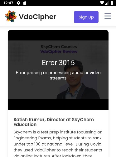

    [Attachment 67972 - Click to enlarge]
    It does not work.
    Is it for using a mobile?
  12. vdocipher is a world apart ... quickly burns many cdm ...

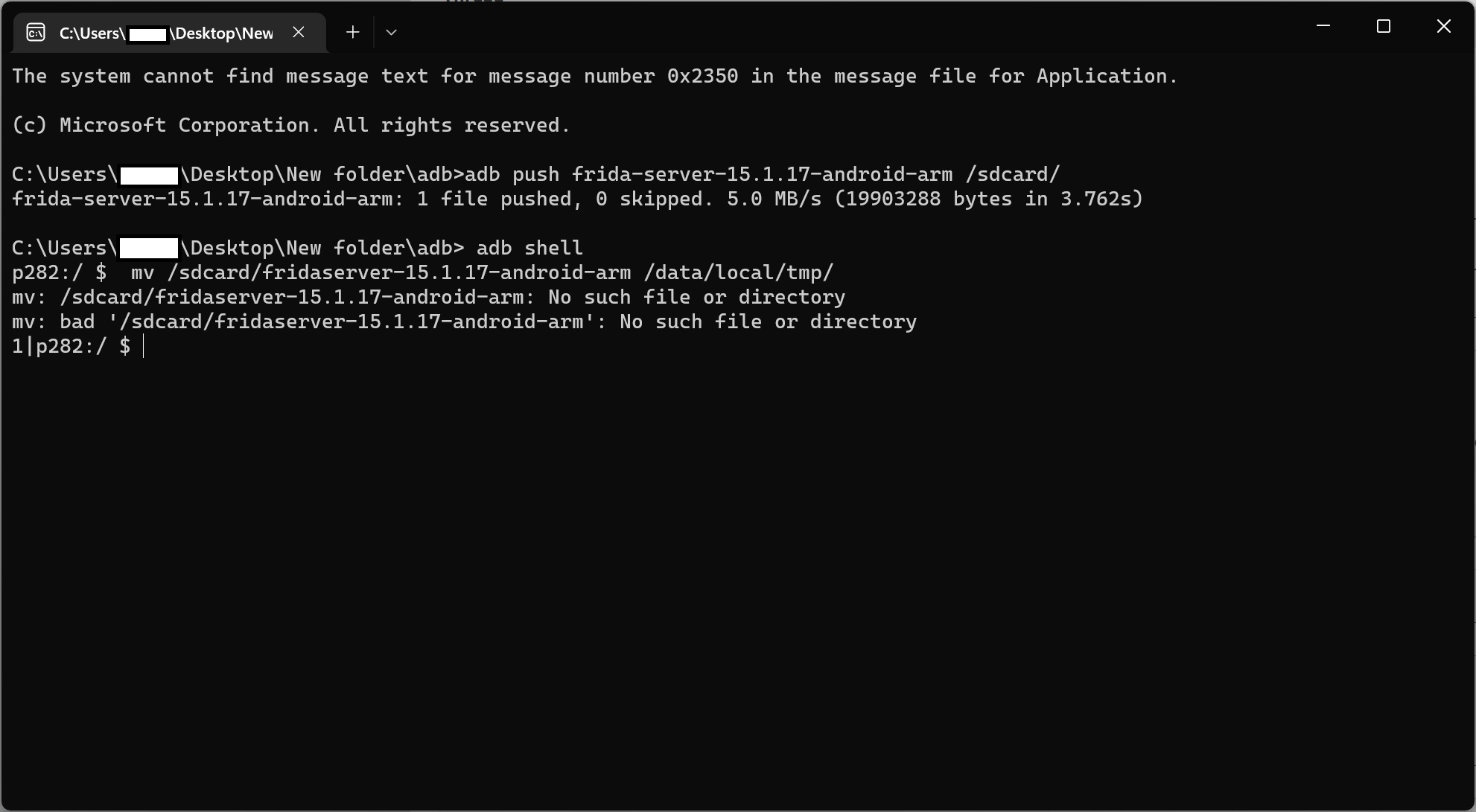

  22. Why does it have to link an executable when starting Frida? Is that normal in Android, which I don't know at all?
  23. Member
    Feb 2022
    Search the forum first!
    in no operating system can a program be run entirely on its on. It needs space reserved in memory at the very least and to be loaded into memory ready to be run. The program cannot do this itself. These are just the normal housekeeping duties any OS does; statvfs would appear to to be part of housekeeping.
    We program at a level far removed from the machine language and it is easy to forget that the processor operates on a limited instruction set that loads data and operation commands into registers of bits. Our scripts are eventually changed into an assembly language for the machine to run. And it also worth remembering that the electronic circuits that underlie everything are simply flip-flops (a couple of transistors configured to hold an output at 5v or 0v), shift registers (a cascade of flip-flops) and comparators (bitwise logic).
    So something has to intervene to get from Frida code to meaningful data outputs. Even the task of displaying a single pixel on the screen is not something any programmer codes for. The OS does all of that. Anti-aliasing (removing jaggies from screen text) took years to get right and no one thinks about it these days; it is just something the operating system does.
