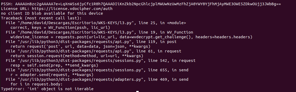

  3. Finally i got the pem key, but... it says: no client ID blob available for this device
    Men... i dont know what to do now
    [Attachment 66968 - Click to enlarge]
    Is it for vdocipher, maybe?

    did you rename the "client_id.bin" file into "device_client_id_blob" (no extension) and put it into the cdm folder of WKS-KEYS along with the "device_private_key" file?
  5. sorry!, my mistake, but now i got this: unable to parse license - check protobufs

    from what I have read here on videohelp that can mean anything from posting the wrong headers to your CDM being revoked
    I think you'll have to search for any previous posts about the video service you're trying to download from (try googling - "SERVICE_NAME site:forum.videohelp.com") especially about the headers, they're the biggest headache
    and if you don't find anything, open a thread here, lay out your problem and what you have so far and someone might help
    Try downgrading protobuf
    pip install protobuf==3.20.1
