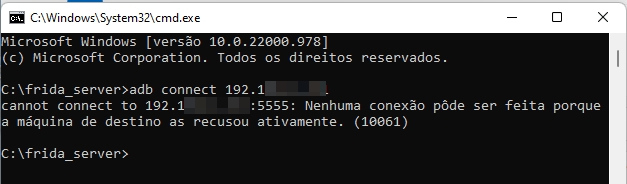

    Already in the first step I was not successful, am I doing something wrong?
    "No connections could be made because the target machine actively refused them. (10061)"
    I'm not asked if I want to accept the connection. I'm on the TV Box T95 s1 home screen

    Has anyone had the same problem or know how to fix it?

    The adb connection isn't being made for some reason. An IP address and port scanner such as 'fing' running on your Android phone can check your home network so you can be sure you are connecting to what you think you are. It is quite likely you are trying to adb to something other than the TV box by mistake.
    When you are sure you know the TV box IP address
    adb devices
    Will let you see if the adb is running on your PC.
    adb kill-server
    will destroy any running adb process on the PC - useful if you've mis-typed a command and you can start afresh with:-
    adb connect <correct TV Box ip address>:5555
    Adding the port (5555) isn't really necessary but belt and braces in this case.
    Good luck; if none of the above work - search "adb troubleshooting"

    You need Terminal Emulator on Android machine and force open the wifi debug port, then you can adb from the computer to it.

    S/He'll need more help than that ... what does he enter in Terminal Emulator to 'force open the wifi debug port'?

    Let's give he/she a head start:
    Install Terminal Emulator from PlayStore on Android machine, open it and use these commands to open the wifi debug port
    su
    setprop service.adb.tcp.port 5555
    stop adbd
    start adbd
    then run adb on the computer - the computer and android box must be on the same wifi router (check android ip address on the device)
    adb connect 192.168.x.xxx:5555
    when the command returns connect successfully, you are good to follow the rest of the guide to dump the CDM

    Is this any different in outcome from setting Developer Options on and selecting debug over wifi?

    I think it is for those without Debug over wifi from DevOps like mine (my tv box refused to debug via usb even the option enabled)

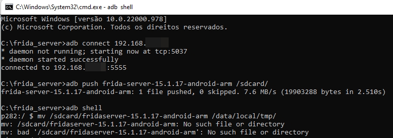

    Thank you to everyone who took the time and effort to help me. Your tips were valuable, now I can connect my TV Box, at least I believe so, but I still can't complete the entire connection procedure onwards.
    What seems obvious to many, for others it may seem difficult and yes, I have been looking for help on google, but I am a common PC user and I have some difficulties and with the help I got here I am slowly getting over it.
    The following error appears...
    [Attachment 66926 - Click to enlarge]
    I'll try to understand better and try to move forward with google.

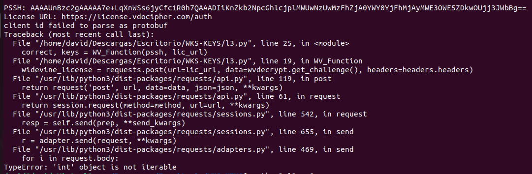

  24. Hi!! I got this error when i use l3.py, i put the JSON and BIN (Changing the name) on android-devices, anyone knows what im doing wrong? Thanks!
    [Attachment 66931 - Click to enlarge]

  27. Originally Posted by elfoeda View Post
    Originally Posted by gadumuc View Post
    su
    stop adbd
    start adbd
    Install frida server from PlayStore, run from it then dump the key, if you get json file, install this magisk module https://github.com/umylive/liboemcrypto-disabler then redump to get l3 cdm
  28. Originally Posted by davidbdn1994 View Post
    You are trying vdocipher with default l3.py
    click click2
    If I/my posts ever helped you, and you want to give back, send me a private message!
  29. Originally Posted by [ss]vegeta View Post
    what l3.py or configuration i have to use?
