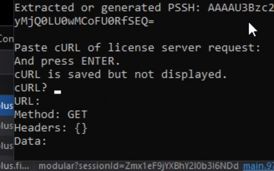

I'm far from a pro at this (still learning every day) but I know the difference between GET and POST. This time I've recorded my screen so you can see what I'm doing step by step - https://screenrec.com/share/1GhAXBWRbC. Even though I'm selecting the option which states POST on FF when it's pasted and I press enter on terminal it still says METHOD: GET. I'll try the bitmovin demo, as I assume I'm selecting the wrong license.
I would much prefer a still screen shot than a video.

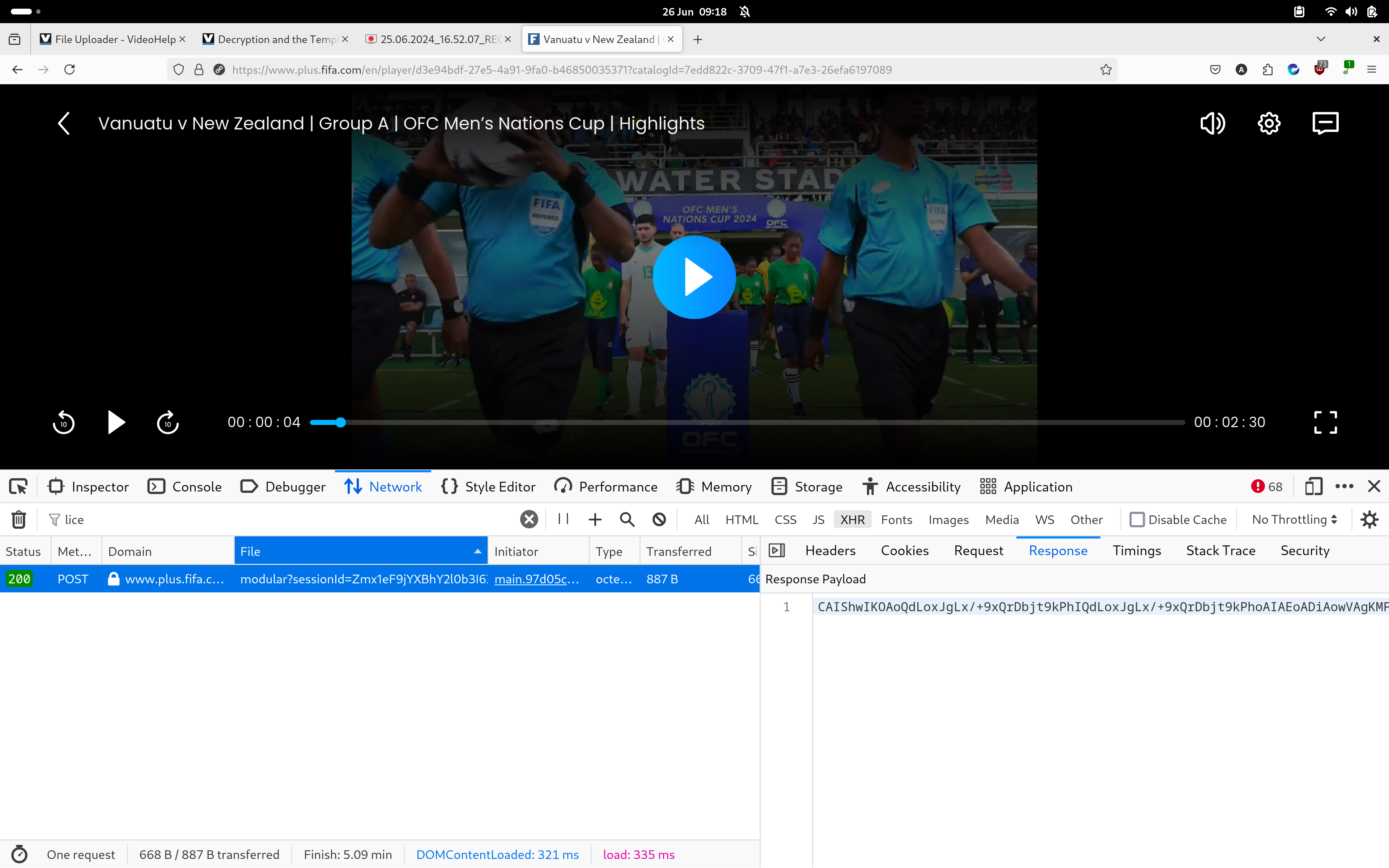

I really cannot see what you are doing wrong. For some reason you've got many POSTs listed by the license filter. Check each one, by selecting so an extension opens and look under response. The url that has a single line response like this:-
[Attachment 80198 - Click to enlarge]
is the license. It will start CAIS

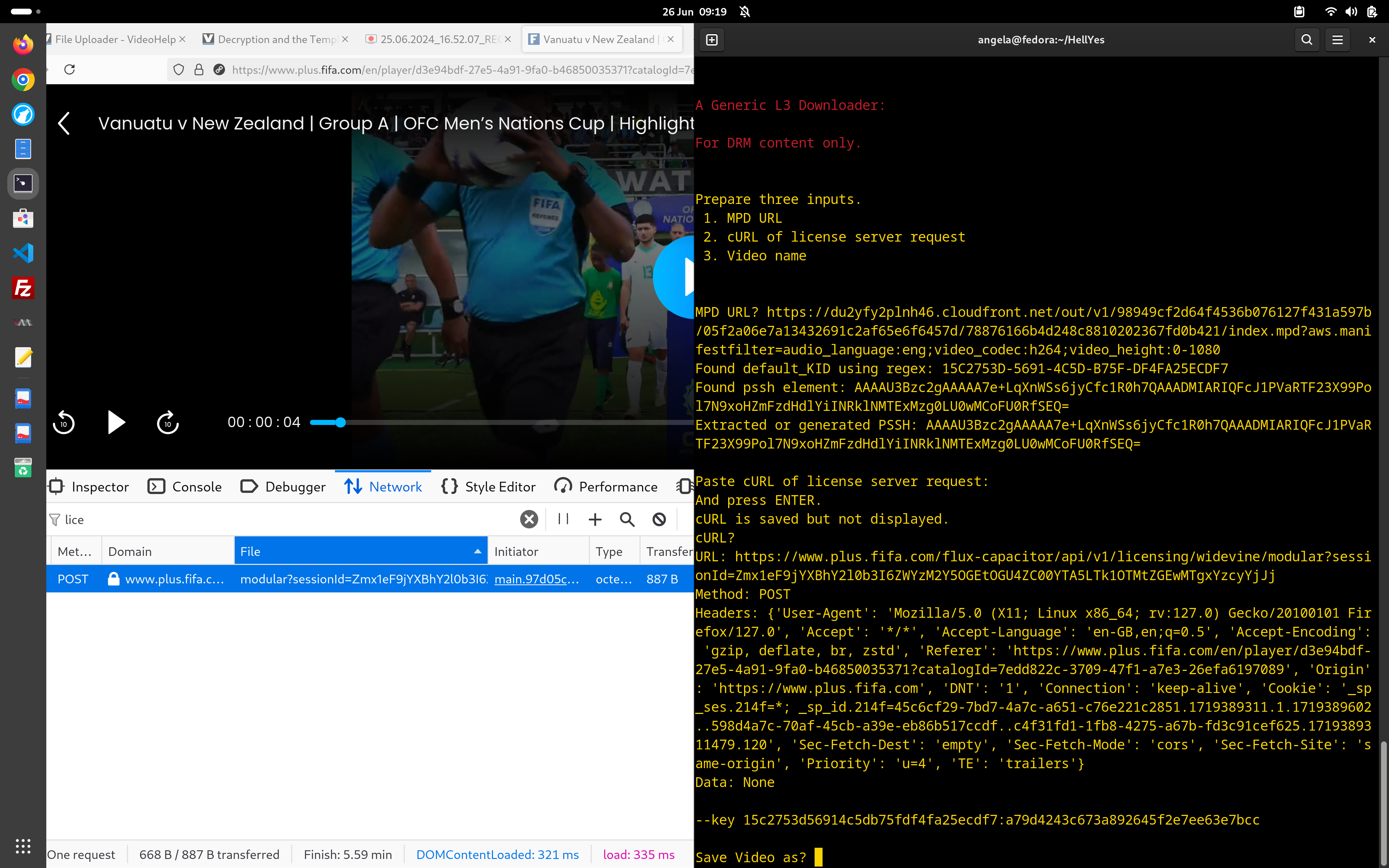

Using it I got this.
[Attachment 80199 - Click to enlarge]
I'm using Firefox and it seem the recent Chrome release has issues so avoid.
Your attempt returned this:-
[Attachment 80200 - Click to enlarge]
And everything returned is default or empty. Are you sure you actually pasted?
To check, open a new terminal and just paste the license url. Does it actually arrive on the screen?
Finally I recommended most strongly in start.html you use the Windows Terminal app, yet you appear not to be using it?Last edited by A_n_g_e_l_a; 26th Jun 2024 at 04:01.
