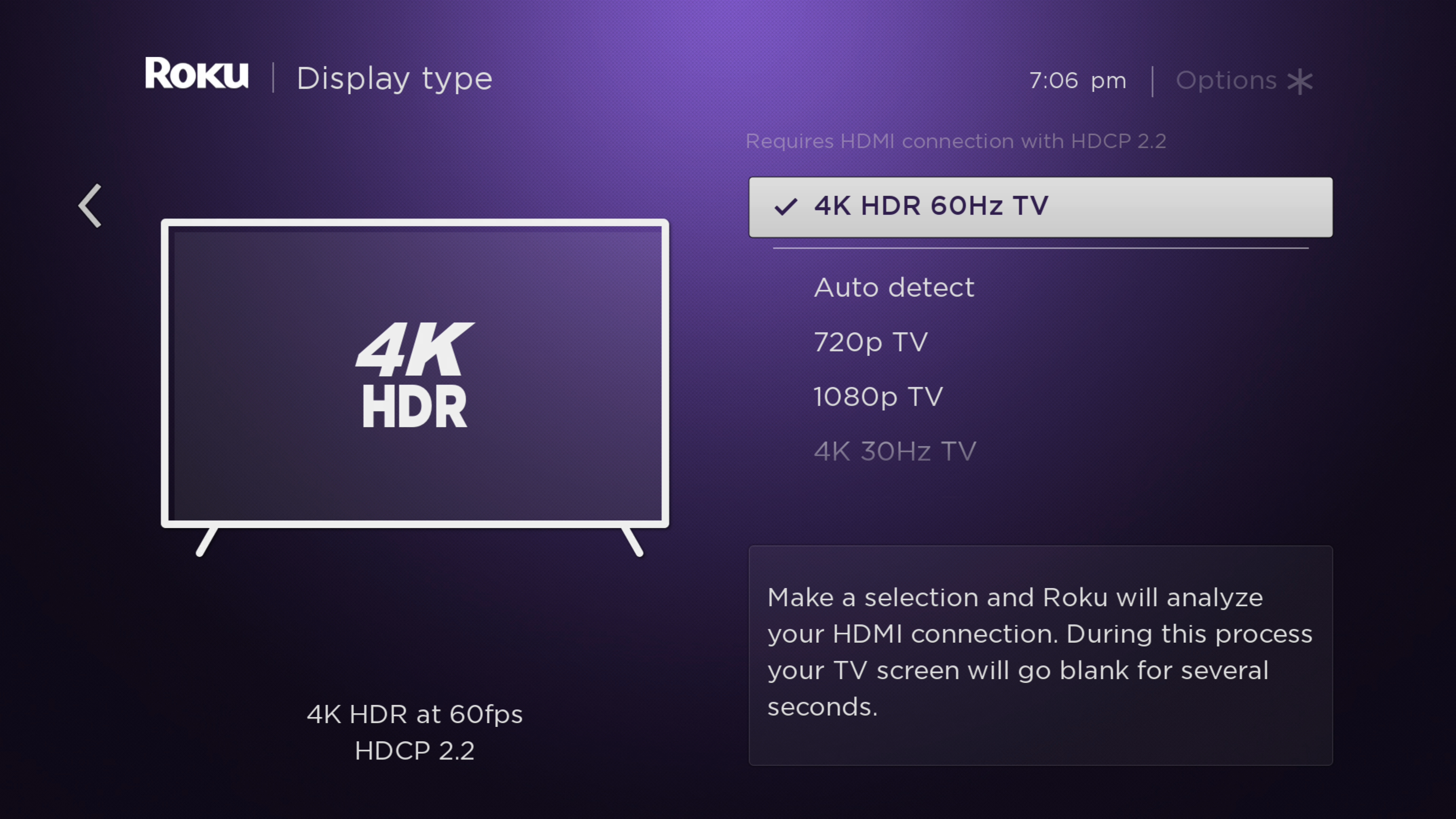

    Thankfully my splitter can record 4k60 HDR off my Roku for the one case I had to use it for. Doubt it works with Dolby Atmos but I don't think any capture card supports it anyways.

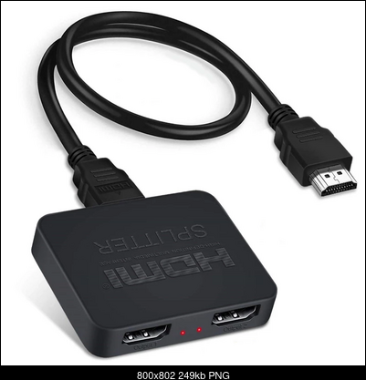

    What, exactly, is the splitter you have?
    I bought this off of Aliexpress a long time ago. It allows me to record 4k60 HDR off my Roku through my Avermedia Live Gamer 4K. It's fantastic.

    - It allows me to record 4k60 HDR off my Roku through my Avermedia Live Gamer 4K.
    That is quite a list of unusual exceptions.
    First it appears to be an all plastic box, it really should have a lot of problems shedding heat.
    The next is that permits 4K stripping, if true this would be the first stripper that can do that I have heard about.
    Avermedia Live Gamer 4K, is known for protecting their status quite aggressively - if they did not they would not be in business today.
    Rubberized plastic. Build quality's quite cheap and it's a tad warm, but it gets the job done.

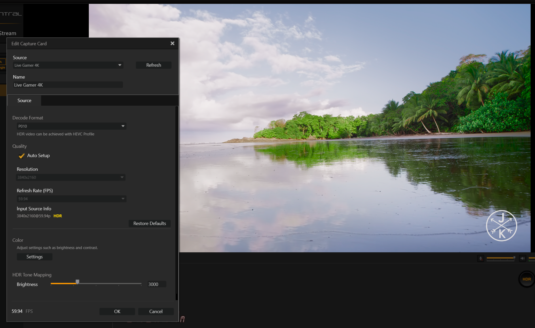

    I thought it was impossible too. A long time ago I was looking up an article on stripping HDCP, even though I already had a splitter that stripped it. Despite me having basically no use of using anything that had HDCP 2.2, I wanted to see if it was possible to strip it. Someone in the comments linked the splitter and they said it worked for them, and they weren't lying.
    [Attachment 63703 - Click to enlarge]
    Example recording attached.

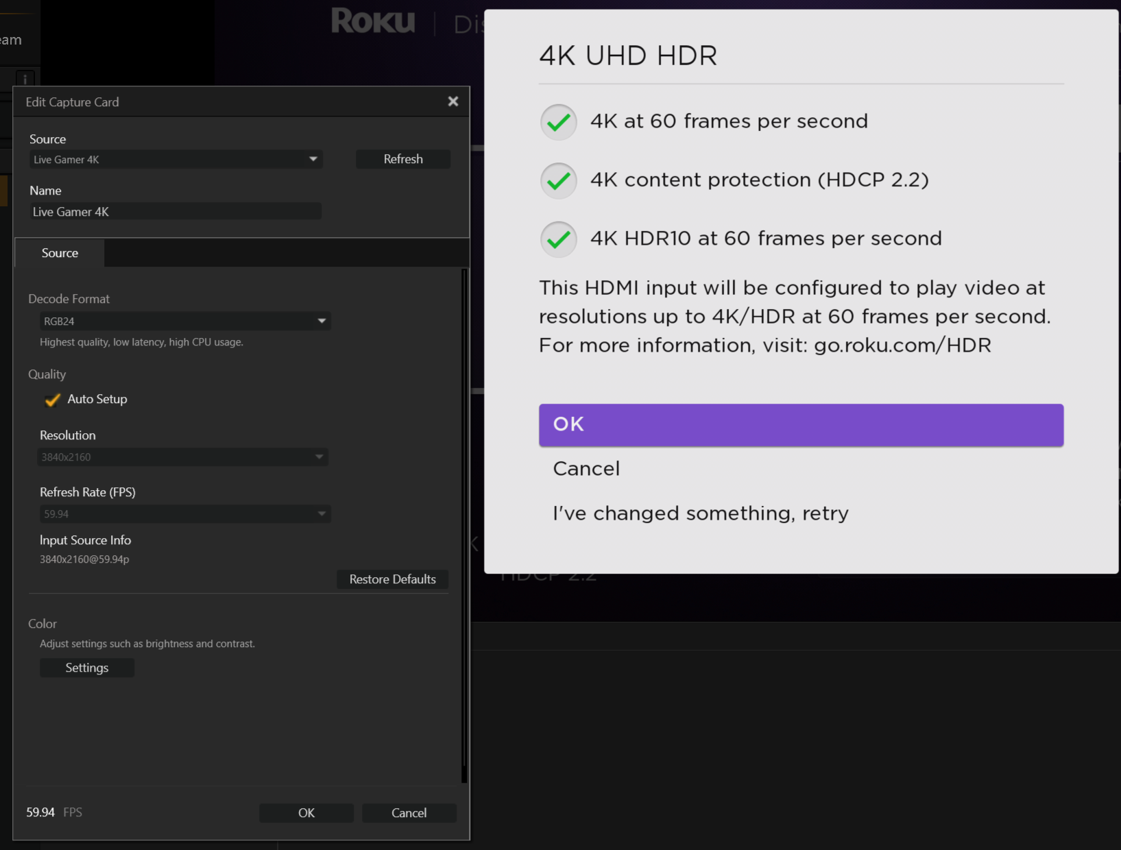

    My box would tell me if a display was hooked up that doesn't support HDCP, then black out after a few seconds.
