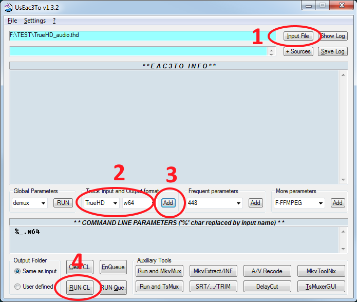

    [Attachment 63570 - Click to enlarge]
    1 Browse to your input file
    2 Set input and output accordingly
    3 Click on "Add" to add to command line
    4 Click on "RUN_CL"
    Eac3to will go to work. Output file will be in folder of input file.
