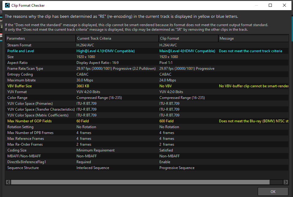

  1. I need some tips/advice on converting videos into a format that is "Smart Renderable" with TMPGENC Authoring Works in case I want to burn them to Blu-Ray discs.
    Most of my recordings are off air 1080p which take a lot of space in their native MPEG2 format. I've been converting them to 720p H.264 videos with VidCoder using a bitrate of about 4500. These play fine, but if I later want to author any of them to Blu-ray TMPGEnc totally re-encodes them again.
    I've been reading about the manual setting adjustments for VidCoder and Handbrake and have tried them, but still cannot get a compatible file.
    The closest I have gotten is leaving the files at 1080 and converting them, but TMPG still rejects them for the reasons shown in the screenshot.
    My question is how can I get VidCoder or ffmpeg to re-encode them in a manner that will allow me to check all the boxes?
    Here is what I've tried so far in VidCoder & Handbrake itself:
    These are TV recordings so they're 29.97fps. I've tried using keyint= to set the GOP rate to be below the limit, but it hasn't worked so far.
    I've also tried using vbv-maxrate to keep the bitrate below the limit (which works) and vbv-bufsize but no matter what I use for vbv-bufsize it still says "No VBV" on the file.
    I've read in various places that your vbv-bufsize should be 1.5x the maximum bitrate, or 2x the maximum bitrate. In my case my actual bitrate is 4500, but it sees it much higher for some reason on the file. What should I use for vbv-bufsize and vbv-maxrate?
    I'm open to any advice/suggestions anyone can offer. I would prefer to use VidCoder since I am use to it, but it seems to refuse to set the VBV Buffer. I'm open to using ffmpeg if that is an option. I've just never dealt with it directly before.

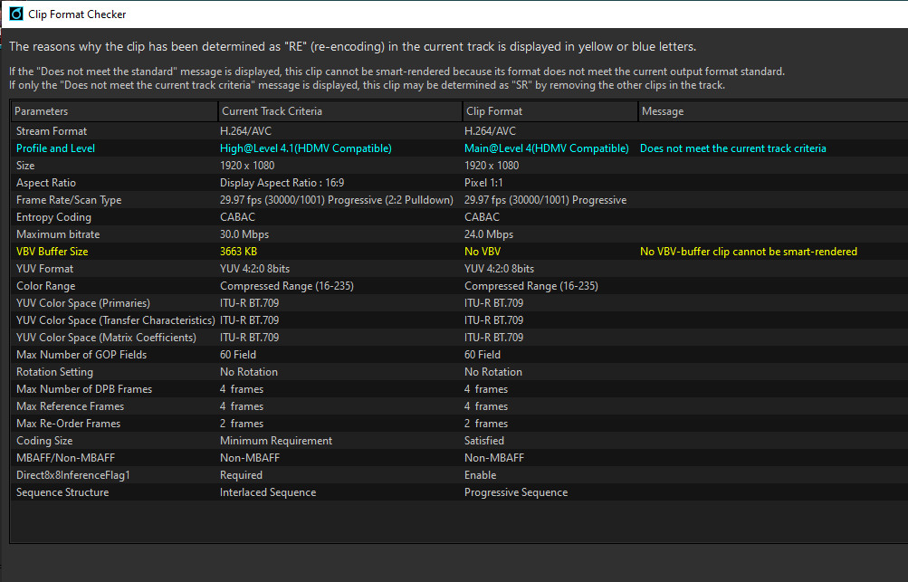

    When I switch to "High" it breaks everything as far as Smart Rendering goes. Right now I'm using VidCoder with the following advanced options:
    keyint=30:no-open-gop:vbv-maxrate=20000:vbv-bufsize=25000
    No matter what I try it refuses to set the vbv-bufsize though, it always leaves it blank.
    Here is the latest screenshot. Everything is perfect except for the blank vbv-bufsize
    [Attachment 63568 - Click to enlarge]

  8. nal_hrd=none
    You're missing --nal-hrd vbr ; and you should use --bluray-compat for BD
  9. bluray_compat=1 fixed it, now TMPGENC Authoring Works sees it as smart renderable.
