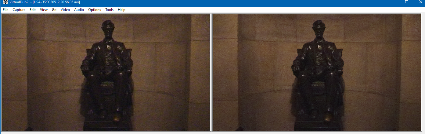

    In the attachment an example of pictures taken insite the The Lincoln Tomb with a miniDV tape camcorder in 2002.
    Is this noise or ???
    And more important, is somekind of restoration possible by using filters.
    And if so, which program and filter(s) must be used.
    Is it possible to give an exaplanation how to or a link to this subject in this forum?

  2. 1. it's noise
    2. that's normal, you really should leave it alone
  3. you really should leave it alone
    (I will probably regret writing this at some point in the future,..)
    And if you don't want to,...
    I had a quick go at it:
    What I did is:
    • Start Hybrid
    • Load Source
    • Set 'Base->Procesing->Video' to 'x265'
    • Checked 'Crop/Resize->Base->Picture Crop'
    • Set 'Crop/Resize->Base->Picture Crop->Crop->Left' to '2'
    • Set 'Crop/Resize->Base->Picture Crop->Crop->Top' to '4'
    • Checked 'Crop/Resize->Base->Pixel Aspect ratio (PAR)->Convert output to PAR'.
    • Set 'Crop/Resize->Base->Pixel Aspect ratio (PAR)->Convert output to PAR' to 'Square Pixel (1:1)'.
    • Checked 'Filtering->(De-)Interlaced/Telecine->QTGMC Vapoursynth->Bob' for deinterlacing. (now that I think about it I could have also enabled 'OpenCL')
    • Checked 'Filtering->Vapoursynth->DeNoise->MC Temporal Denoise' for denoising..
    • Set 'Filtering->Vapoursynth->DeNoise->MC Temporal Denoise->Settings' to 'very high'. (didn't check whether a lower would have been enough or manual tweaking would help)
    • Checked 'Filtering->Vapoursynth->Frame->Stabilize->Stab' to reduce the camera bobbing a bit.
    • Went to 'Filtering->Vapoursynth->Misc->Filter Order/Queue' and moved 'Stab' above 'Crop', so that the statilizing will be applied before the cropping.
    • Clicked 'Base->Output file name' and entered an output file name to set the output file name.
    • Clicked 'Base->Add to Queue', to create a job and subjobs for the configured settings.
    • Clicked 'Jobs->Queue->Start'

    QTGMC(Bob) + Stab + Crop + MCTemporalDenoise + Resize (for square pixel)
    Didn't touch the colors since I have no clue whether they should be changed.

    AviSynth filtering, just TemporalDegrain2 applied on lossless deinterlaced frames and interlacing back:
    video_org=FFmpegSource2("USA-3'20020512 20.56.05.avi")
    deinterlaced=video_org.AssumeTFF().QTGMC(lossless=1)
    deinterlaced_yv16=deinterlaced.convertToYV16()
    denoised_yv16=deinterlaced_yv16.TemporalDegrain2(degrainTR=3)
    denoised=denoised_yv16.convertToYUY2()
    interlaced=denoised.AssumeTFF().SeparateFields().SelectEvery(4,0,3).Weave()
    stackhorizontal(\
    subtitle(video_org.convertToYUY2(interlaced=true),"video_org",size=28,align=2),\
    subtitle(interlaced,"TemporalDegrain2(degrainTR=3)",size=28,align=2)\
    video comparison: td2.avi
    image comparison (use zoom and fullscreen): https://imgsli.com/OTcyOTI

    The sample td2.avi is indeed better then the original file.
    But how to use avisynth, no experience at all.
    I read, you have to use command lines in a avs file?
    I suppose that TemporalDegrain2 is such a script.
    But how to execute?
    I also have tried to execute hybrid with the given instructions.
    But 2 instructions I could not find these.
    Ignoring these and still doing the job, it ended in a error message.
    I think, the avisynth method is easier to do for me (i hope) ?

  13. I recommend running "CCD (Camcorder Colour Denoiser) instead
    [Attachment 63556 - Click to enlarge]

    I get much better results with chromanr filter.

    The main issue here is chroma noise, and VirtualDub CCD (camcorder color denoise) is the cNR needed.
    More can be applied, but the cNR is a quick minimum.
    The clip is far too short to worry about stabilization yet. I never even consider stabilization unless its a constant issue through the tape/video. Or only when certain scenes are required.

    More of a luma noise, Chroma doesn't have the fine details the luma has, The fine grains are typical luma noise in low light condition, an inherit problem of CCD's back in the day, lollo did an excellent job almost eliminating it without loosing much details but leaving behind the chroma blotches, but dealing with those will damage the video further.
    That could be. At minimum, you have to remove the chroma noise, see if luma exists. I didn't run a test of the clip.
