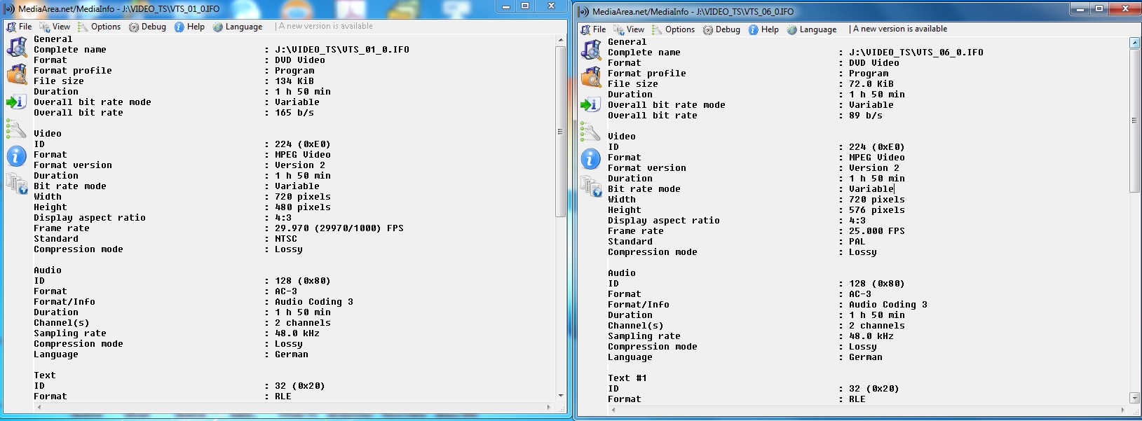

    I offer you a media info report of two versions of the same film - Munchhausen 1943. On the left is the NTSC version. On the right is the PAL version. You will note that the running time of both is 110 minutes. These dvds are almost 20 years old. It had been re-released but only in Germany and with there being several slightly different versions now in existence it is not so easy to compare.
    BTW FPS can not be 'faked'. It has to be stated in the video header to ensure that the media plays at the correct speed.

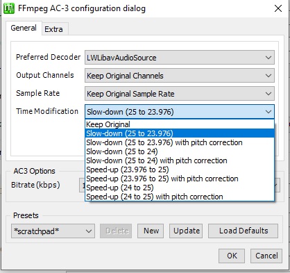

    Changing audio track speed (a.k.a. "audio FPS conversion"):
    [Attachment 63565 - Click to enlarge]
