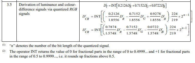

  24. I hate it when people give only the final matrix equations for complex conversions. They're are nice for coding but do not elucidate where all the coefficients come from.
    Originally Posted by chris319 View Post
    This code gets me close but is not very accurate:
    Kr = 0.299
    Kg = 0.587
    Kb = 0.114
    r = y + 2*(v-128)*(1-Kr)
    g = y - 2*(u-128)*(1-Kb)*Kb/Kg - 2*(v-128)*(1-Kr)*Kr/Kg
    b = y + 2*(u-128)*(1-Kb)
    75% yellow: Y=168, Pb=44, Pr=136
    The Kr, Kg, Kb coefficients are for rec.601 but your "YPbPr" values are for limited range rec.709 YCbCr. And they are rounded to the nearest integer. If you use the reciprocal equation and floating point for all the calculations you'll see that the actual limited range values for R=191, G=191, B=0 are Y=168.192, U=44.110, V=135.692. The quoted conversion equation is for converting full range YUV to full range RGB.
    The correct coefficients and equations for converting full range RGB to limited range YUV (YCbCr), and full range RGB to full range YUV are given at the aviSynth.nl:
    http://avisynth.nl/index.php/Color_conversions
    The correct way convert studio (limited range) RGB to limited range YUV is to first convert the studio RGB to full range RGB then convert to limited range YUV using those equations. To reverse the operation convert the YUV to full range RGB then convert the full range RGB back to limited range RGB.
    sRGB = each studio RGB component
    fRGB = each full range RGB component
    sRGB = fRGB * 219 / 255 + 16
    fRGB = (sRGB-16) * 255 / 219
    Where do the 255 and 219 values come from? Those are the ranges between the defined full black and full white. 255 = 255-0, 219 = 235-16. They should be familiar from the limited range YUV conversion equations.
    Given those sRGB to fRGB equations and full range RGB to limited range YUV equations from from the AviSynth docs:
    Kr = 0.2126
    Kg = 0.7152
    Kb = 0.0722
    y - 16 = (Kr*219/255)*r + (Kg*219/255)*g + (Kb*219/255)*b
    v - 128 = 112/255*r - Kg*112/255*g/(1-Kr) - Kb*112/255*b/(1-Kr)
    u - 128 = - Kr*112/255*r/(1-Kb) - Kg*112/255*g/(1-Kb) + 112/255*b
    r = (255/219)*y + (255/112)*v*(1-Kr) - (255*16/219 + 255*128/112*(1-Kr))
    g = (255/219)*y - (255/112)*u*(1-Kb)*Kb/Kg - (255/112)*v*(1-Kr)*Kr/Kg
        - (255*16/219 - 255/112*128*(1-Kb)*Kb/Kg - 255/112*128*(1-Kr)*Kr/Kg)
    b = (255/219)*y + (255/112)*u*(1-Kb) - (255*16/219 + 255*128/112*(1-Kb))
    You do the following:
    First convert the sRGB to fRGB:
    R = (180-16) * 255 / 235 ~= 191
    G = (180-16) * 255 / 235 ~= 191
    B = (16-16) * 255 / 235 = 0
    Then plugging those values in the YUV conversion gives you limited range YUV components (rounded to the nearest integer) Y=168, U=44, V=136. Look familiar? Using the inverse conversion (and rounding) gives you back the r=191, g=191, b=0. And converting that fRGB back to sRGB gives you 180, 180, 16. With some other colors the round trip will be off by 1 or 2 units per component -- from the multiple rounding operations. If you run the equations in floating point (with no rounding) you'll find the conversions are accurate to within the accuracy of the floating point operations (roughly 1 in 10^7 with single precision fp, 1 in 10^16 with double precision fp).

  29. Originally Posted by jagabo View Post
    All right. That's how I did it:
    I took the matrix coefficients for R'G'B' -> Y'CbCr conversion from ITU-R BT.709-6, formula 3.5. For 8bit n=8.
    [Attachment 63534 - Click to enlarge]
    Then I inverted the matrix to obtain Y'CbCr -> R'B'G' which gave the coefficients of post #13 and #21
    All in floating point, no integer rounding.
