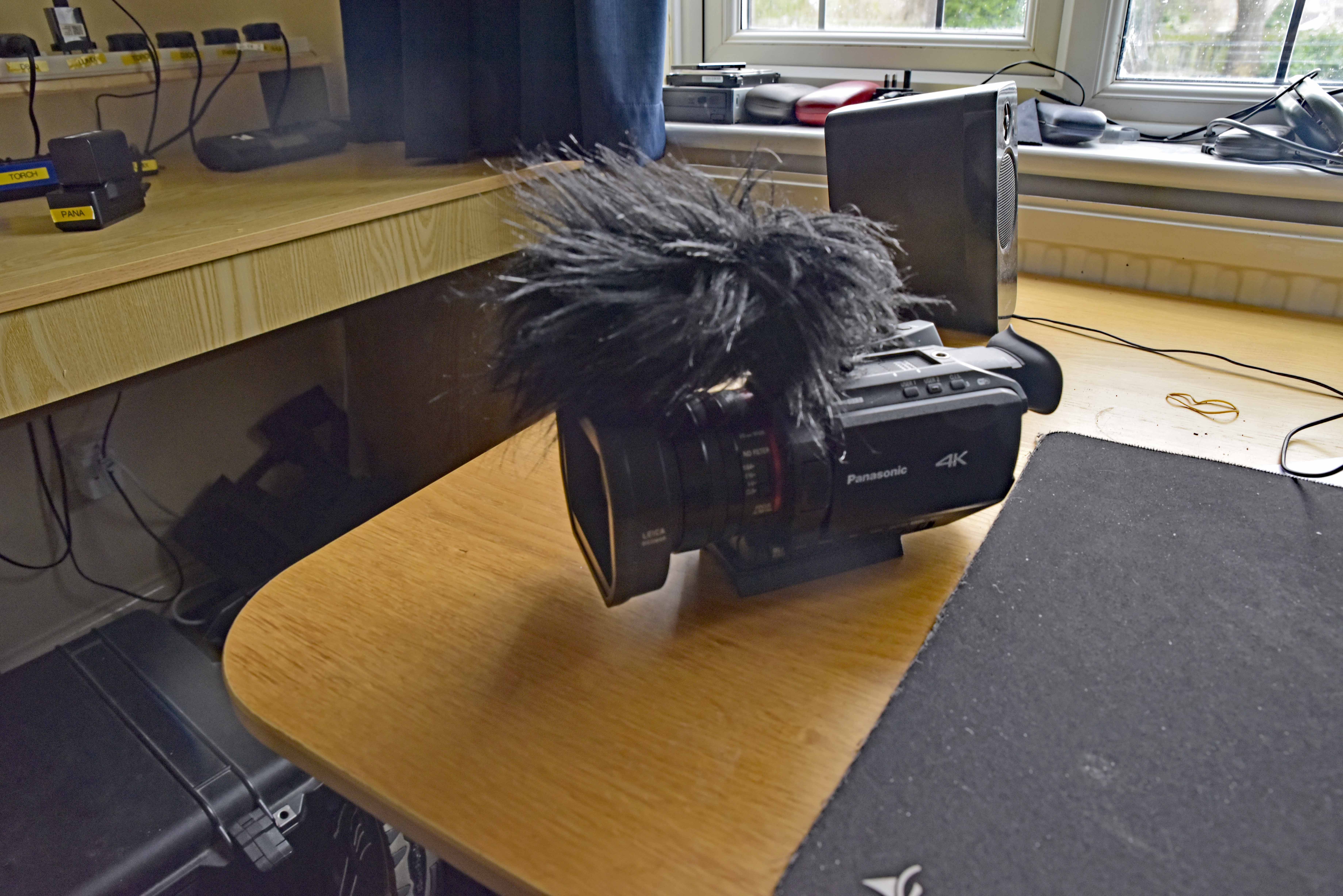

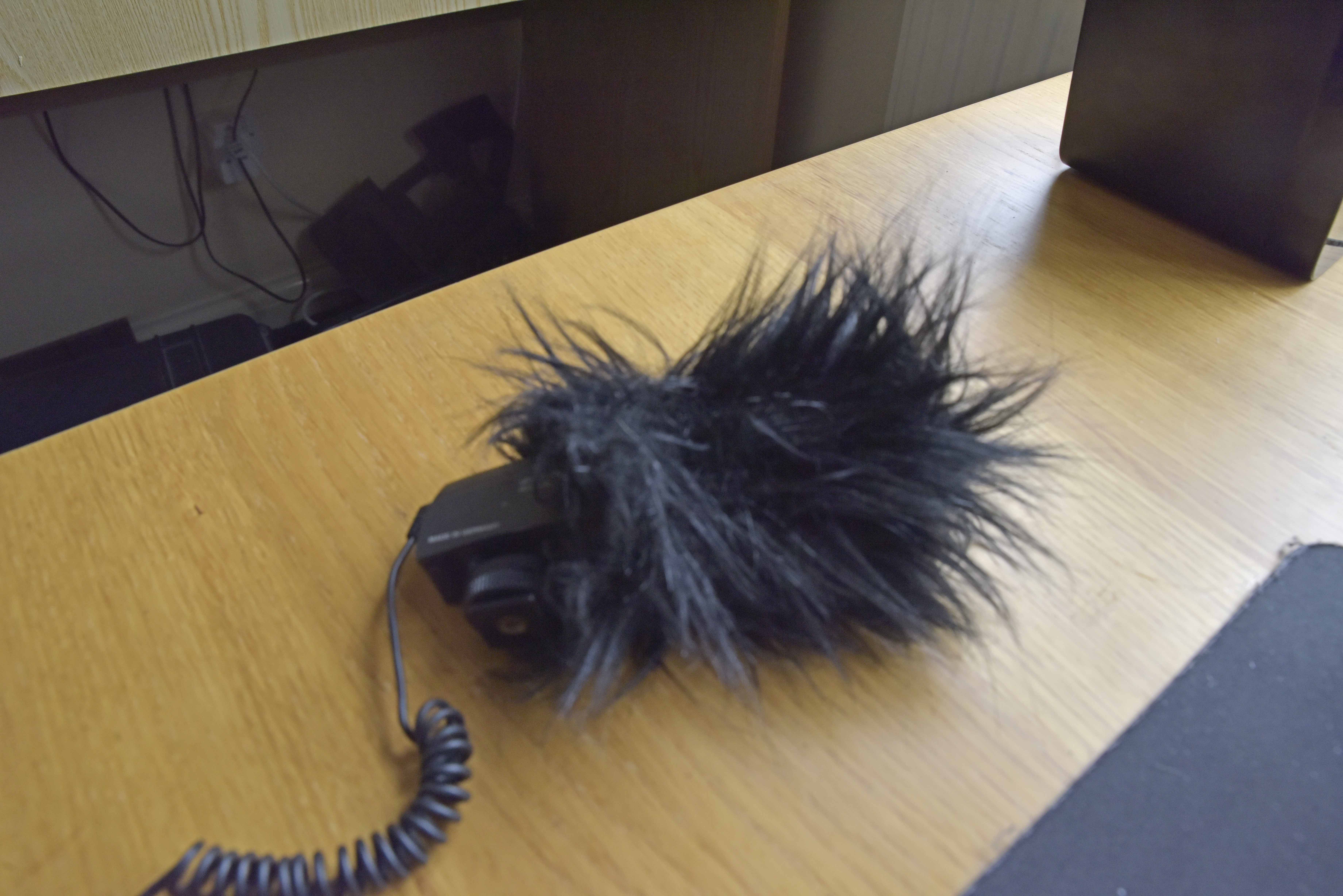

  7. I have a hoya UV filter and yes the hood may well go over it but the hood doesn't lock in, which is why I wrote about getting another hood, at least on mine it doesn't
    I got the handle because the Gutmann deadcat on the Sennheiser MKE400 showed up in the videos if fitted to the camcorder top directly, or at least did on previous models. Also the further away the less camera sound it will pick up. Also it is easier to balance the microphones using the dials against doing it in camcorder
    [Attachment 63509 - Click to enlarge]
    Being one of the best wind deflectors I could find
    Always interested in others points of view so thank you DeJay
    OK just tried it not having done so before and and it doesn't look as if it shows, at least indoors but in the wind??.Yes it does
    [Attachment 63510 - Click to enlarge]

    Mine's a 62mm threaded Hoya Protector I already had and it just fitted. I admit I thought a filter would not go in the gap, but when I tried I was pleasantly surprised.
    I have a Rode SVM with dead cat and have no problems with any hairs getting into frame, even at full wide.
