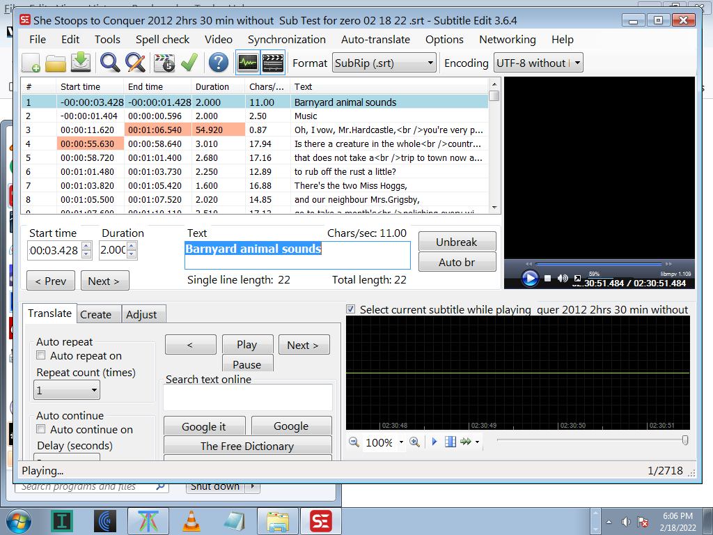

  1. I have looked at the help files for Subtitle Edit. But when I go to Adjust, I'm not able to set the start time of the whole subtitle to zero. Should be easy but I'm missing something. Each Time I go > Adjust and then change the start time box, it will not reset and save to 00:00:00.
    the start number is:
    00:00:55 > forward.
    Because of this I cannot even see the beginning of the video.
    canada
    Just go to synchronization/adjust all times earlier/later and set it to 55 seconds or whatever you need.

    I did not explain myself well.
    I've made a screen shot. And I did look at Synchronize.
    But what is needed is to time the two entries called Barnyard Noises Start at 00:00:06
    until 00:00:12 for "Music" to display and a dialog start time of 00:00:55 secs.
    So 00:00:00 to 00:00:06 Barnyard Sounds
    00:00:12 to 00:00:54 Music plays
    00:00:55: " Oh I vow "
    I can fine tune the timings when I know how save them correctly.

    For such a gross change it might be quicker to edit the source in Notepad,
    change it there, and make that your new base - then do your fine tuning in the program

    Originally Posted by loninappleton View Post
    To set up my line numbers, will "Insert New Line" renumber everything?
    Yes. Even when "insert before" line 1, all will be renumbered properly.
    For this case however, I think I'd first delete line 1 and 2. Next, solve the long duration issue of the "Oh, I vow..." text (now shown as line 3). Then sync all to video. Lastly, "insert before" to create the two lines 1 and 2 again, manually setting timings right.
    Hope this helps.

    I'd be glad to, but I don't know the exact issue you are experiencing. Aside from the problems in the first 3 lines (maybe you can just delete them for assessing the rest), can you tell what the exact matter is?
    Are they all out of sync for a same period? Like, do they all show too late or too soon the same amount of time?
    In that case you'll need "Synchronization --> Adjust all times (show earlier/later)".
    Or does the a-sync decrease or increase when going further into videotime? In which case "Change framerate" or "Visual Sync" can help out.
    A combination of the two is also possible.
    Please let know what the exact problem is, I'll try to provide detailed workflow.

    The first 2 lines need to be adjusted cause they show negative counts,they need to be set to 00 to start with or close to the first talking time or relevant scene.
