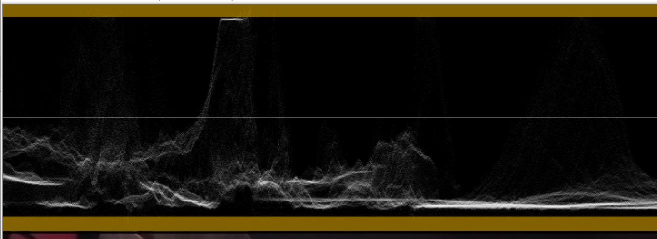

OK so I took a better look at my footage armed with this information. Pure white shows off correctly at 235 (just bordering the yellow top-zone) but blacks are higher than 16, with a floor obviously too high, which is why it looks a little washed out

First, you can notice there's a bit of noise in the yellow zones, it's not much but it's there, I suppose it can be safely ignored for the purpose of regrading the footage?
So, my goal should be to lower the floor to be bording the yellow bottom-zone of 16, is that right? However I do not want to lower the whites, so using tweak to lower the brightness is not the correct approach. I believe my best bet is to use Levels(X, 1, 235, 16, 235, coring=false) and find which value of X to use. Technically speaking it should be the current floor value. But how do I find this value, beside trial and error? Can Histogram give me an actual minimum value I can use? -
Yes. Those are typically from sharpening filters and compression artifacts (DCT ringing). That's why there is headroom and footroom in the limited range spec.
Yes -- assuming that area is supposed to be full black.
Yes, again assuming the peak is supposed to be full white.
It's one way. You can also use ColorYUV, Tweak, etc. But Levels() is pretty intuitive for this kind of adjustment.
Histogram can't give you a value. But looking at the graph, the bottom yellow bar is 16 units thick. So the distance between the bar and the dark patch above it about 6 to 8 units. Try something like Levels(8, 1, 255, 0, 235, coring=false).
ColorYUV(analyze=true) reports a "loose minimum" value. That ignores the lowest percent or so of values -- ie, ignores some of that noise. -
