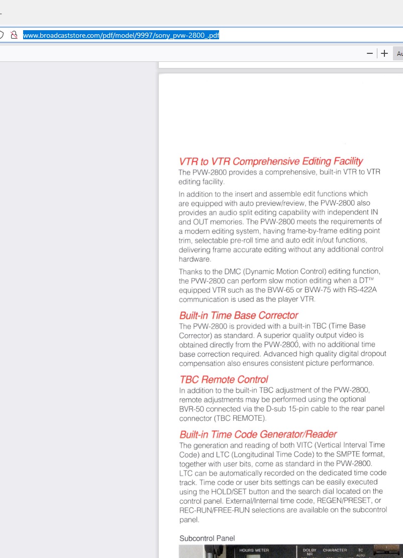

  1. I was wondering what type of tbc is in these decks ? the card says tbc-18 and has small spots to make adjustments with tiny screwdriver. hue ,uv offset,visc p,visc r.,int sc, chroma level,video level some of these controls are also under the flip up panel on the front of the unit.
    Jan 2016
    Probably a field TBC with proc amp, I doubt it would work as a stand alone TBC for external incoming signal, it applies TBC to the tapes it reads only, at least according to online publications. What is it good for though is transferring uMatic tapes, It uses the dub connector and pulls the chroma under straight from the tape.
  3. this is from the manual. i can confirm that it works on the pass through signals it also need to be provided with a reference signal from the source to gen lock the picture and keep it from rolling . i was told to use this setup from the guy at https://www.youtube.com/channel/UCZZ81K7l-gW_z4g2HA8mcDw as a pass through to handle the tbc needs.

Name:	tbc pvw 2800.jpg
