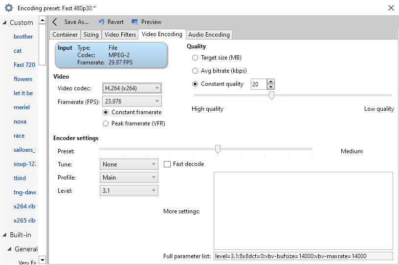

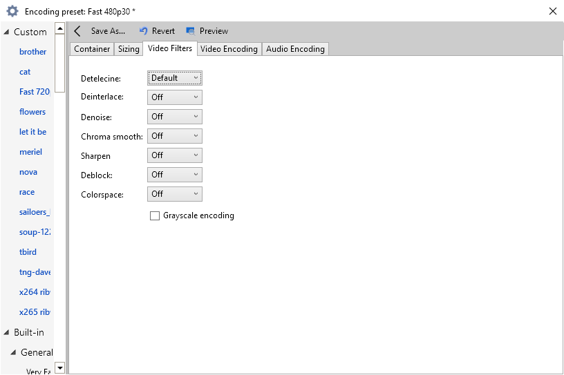

    I used Vidcoder, similar to Handbrake. Set it up like this

  7. Originally Posted by davexnet View Post
    All seem Ok, except that for such grainy source crf20 is not enough. I'd use either crf15+tune 'film' if I wanted to maintain grain, or crf18 + some light denoising

    Dave, your first image show Deinterlace off. Dopethrone wants the output to be deinterlaced.
    Shouldn't the Deinterlace be set to on?
    Mar 2008
    Detelecine seems to take care of it, matches the fields and drops the frame rate to 23.976 (2nd picture)
    If the frame rate were left alone, you'd see a pattern of 4 normal frames followed by 1 duplicate

  13. Originally Posted by davexnet View Post
    Detelecine + lowering the framerate down to 23.976 seems to get rid of the problem, does anyone know why is this the case? i have some other raw dvdrips that suffer from the same exact problem, now at least i know how to solve it.

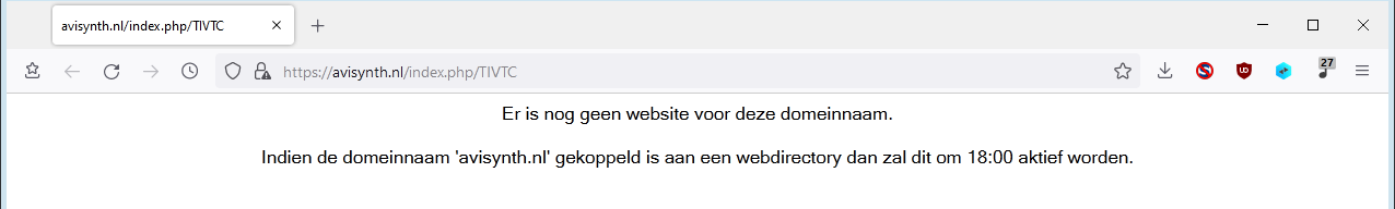

  21. First use DgIndex (included int the TIVTC package for AviSynth) to build the m2v file from your VOB file(s). Then use Mpeg2Source() in your script to load the video (as in the sample).
    https://avisynth.nl/index.php/TIVTC
    Is it only me or has the avisynth.nl site been down for the last few weeks?
    I guess the ru site is still working:
    http://avisynth.org.ru/docs/english/externalfilters/tivtc.htm
  22. Originally Posted by jagabo View Post
    Works here.
    Try http:// vs. https://
  23. Originally Posted by Sharc View Post
    Works here.
    Thanks. Neither works here. I get:
    [Attachment 63458 - Click to enlarge]
    I just checked with Firefox on my smartphone. It's working there. It must be something in all my Firefox/NoScript/UblockOrigin/hosts security/privacy settings.
