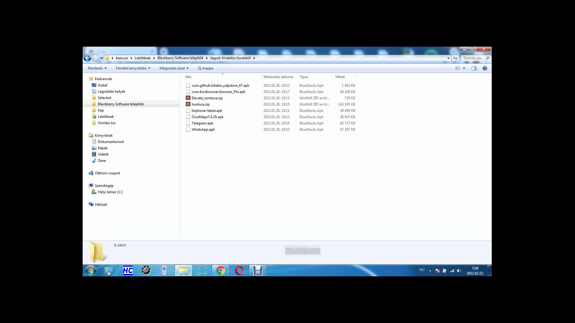

    I have a video here. The video image is crisp, sharp, but the bitrate is low. Is there any way to upconvert it to any size and bitrate that would look similarly crisp on Youtube as well? Or impossible? Sadly my source cannot produce these with higher bitrate. This is the one I can work with. File attached. (My screen is 1366x768, here the video is sharp, maybe it will be dull if you watch on FullHD screen, not sure).
  2. See jagabo's post in your other thread
    The blurriness is from resizing, not compression. Your video is 1366x768. Youtube will resize to one of its standard sizes, 1280x720. Then when you watch the video full screen on your computer it is resized again to 1366x768. That's two resizing operations, each blurring the video.
    It's not a bitrate issue. You can prove this by using lossless, or no compression without youtube. It's the scaling up and down. You need to use a web host that displays at 1366x768, that does not down and up scale
    Or cap using another computer and display at 1920x1080

  4. You can add borders to make the video 1920x1080 or crop down to 1280x720. If course, it will still be blurry on your monitor because it will be downscaled to 1366x768. But anybody watching on a 1920x1080 display will see a sharp picture.
    [Attachment 63406 - Click to enlarge]

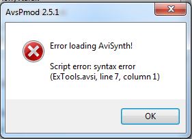

    Indeed, I downloaded it the wrong way. But even on the correct way I get an error message, it changed to this one:
    [Attachment 63493 - Click to enlarge]

  14. Everything should work with newer avs+ versions ( except very old plugins might have problems)
    Or you can try another unsharpmask implentation, such as from the warpsharp package , or unsharpHQ , or vdub has unsharpmask. They are slightly different and less resemble Vegas' type of sharpening
