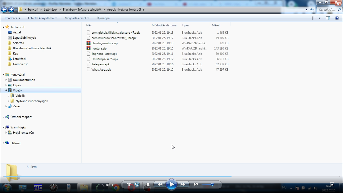

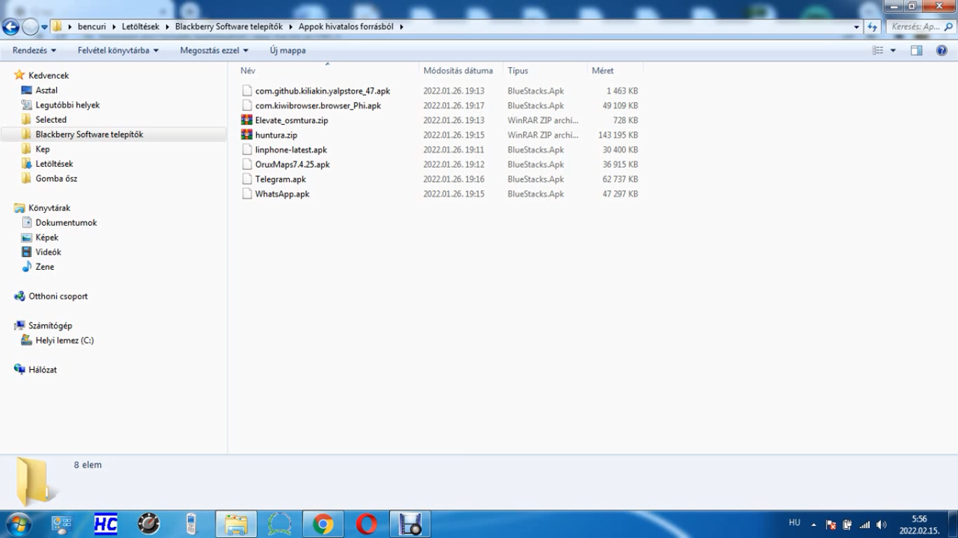

    I checked the upload but for me it is blurry. I took a screenshot of the difference how it appears to me, sc1 is the one from Streamable, sc2 is the original file played on my computer. They are both sharp in your case? I use Sony Vegas, but I use high bitrate for settings.
    [Attachment 63393 - Click to enlarge]
    [Attachment 63394 - Click to enlarge]
  4. Obviously there's some blurriness because of compression, especially when the source is at such a low bitrate.

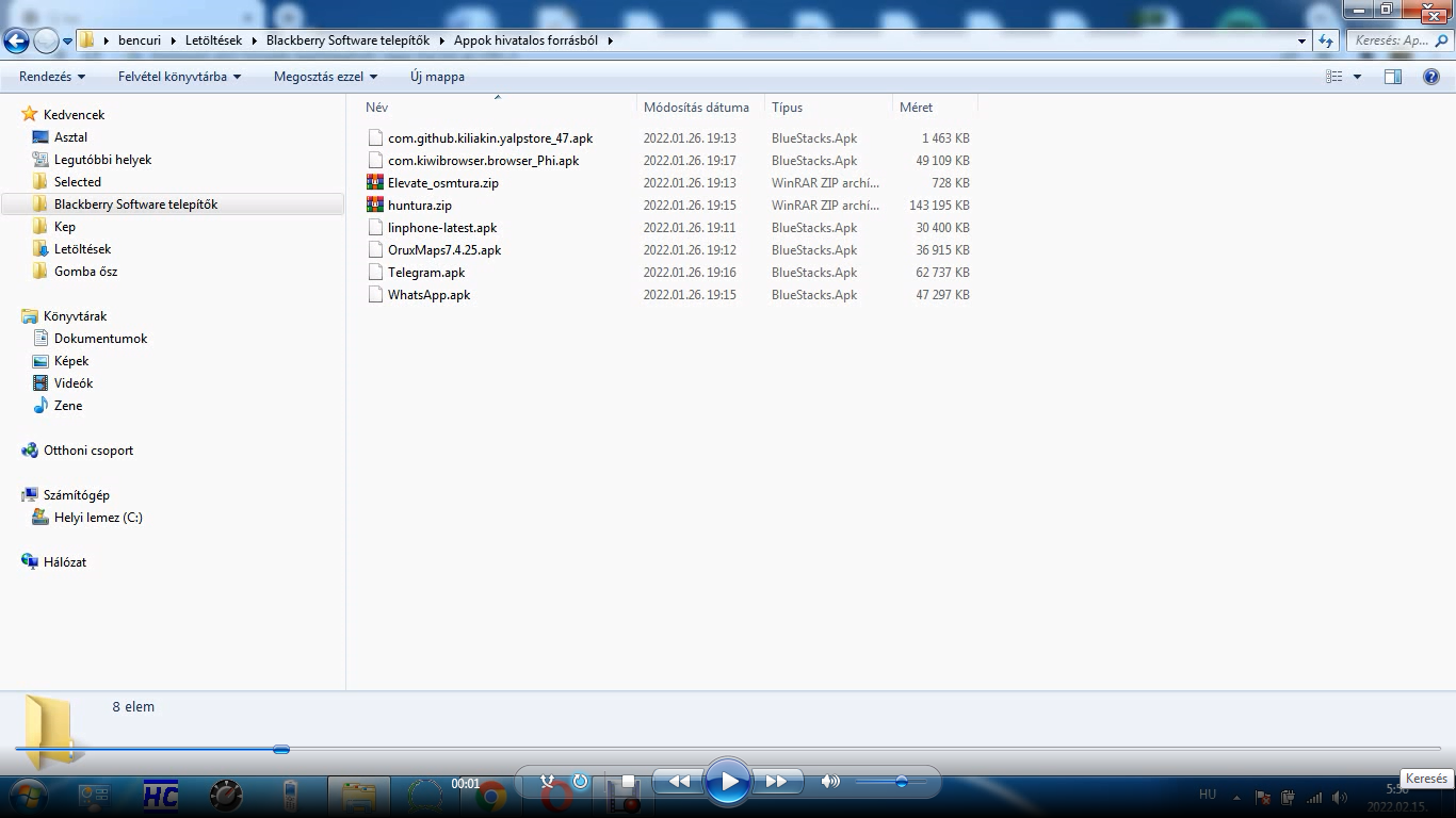

    OBS does not work on my computer fine. Any preset or setting I choose, the resulting file becomes a low bitrate one. Even If I set the bitrate to max, the actual bitrate of the file will be low, and the recording blurry. Check the photo I attached. I used the settings that you suggested, this is what Mediainfo reports of the file:
    Complete name : C:\Users\bencuri\Videos\2022-02-15 14-45-04.mp4
    Format : MPEG-4
    Format profile : Base Media
    Codec ID : isom (isom/iso2/avc1/mp41)
    File size : 1.74 MiB
    Duration : 22 s 734 ms
    Overall bit rate : 641 kb/s
    Writing application : Lavf58.76.100
    The only software that work as should on my computer is Flashback Express, there, when I set the bitrate to high, the file will be large indeed with high actual bitrate, but the problem there is that there are dropouts sometimes when recording.
